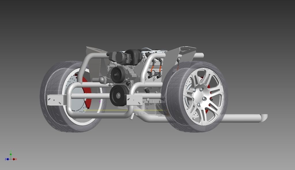

Time to dust things off a bit.... shortly after the last update I decided to make a career change. That has certainly kept me busy but it has also been very exciting. In the little spare time I had during fall / winter, I decided to work on designing my own front subframe to accept the BMW suspension I plan on using. Well, I'm pretty happy with where it's at and I've started sourcing parts. What you're looking at isn't the final version - but it's pretty close. Hope to have some of the parts here in the next few weeks to start welding up. The downbars will eventually be triangulated near the firewall to brace the strut towers.
Always up for any input / comments / criticism.

  #136
Old 04-07-2015, 06:28 AM
Posts: 6,596
Thanks: 1,649
Thanked 890 Times in 663 Posts
Looks badass to me. Glad to see you making progress. Congrats on the positive career change.

Nice CAD work! It's looking clean. what engine are you going with?

Very cool. That is something you don't see every day.

Thanks! Currently planning on using an S54 out of an E46 M3. Sort of a modern take on a Firebird Sprint.
