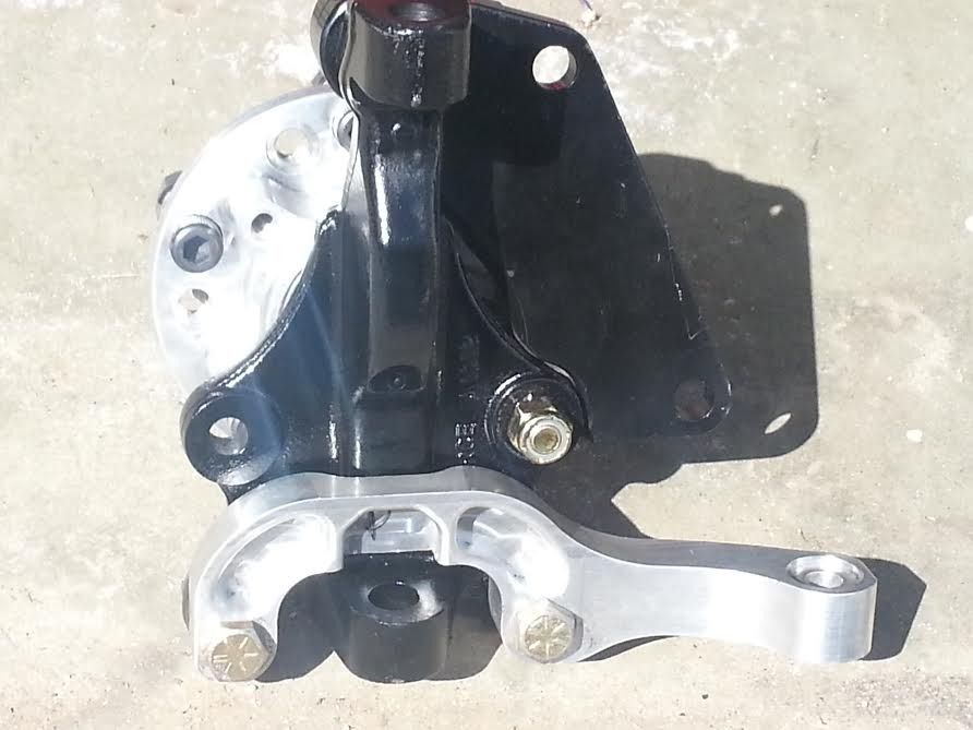

or have some made out of billet at a local machine shop? Like these on my rambler project
