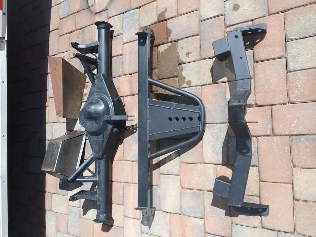

Ok, so I was all set on a torque arm for the rear of my '69 Camaro when I stumble, kind of, on a chance to buy a Lateral Dynamics 3-Link. I know the reputation of them on here but I'm putting this out there for any input anyone might have. This is not going on a hardcore track car (although it could become that), but I have to admit I like having the coolest and best performing stuff, whether I need it or not. This car started while I was married and had little money to spend on it. Now I'm not married and have more money to spend on it, funny how that works.
So, would I even notice a difference between the two? I know I have to cut the car up some, don't really mind that, but do I need (or have time) to go that far? I'm most likely going to go with Jay's full floater axle set up for the rear using my C6 Z06 brakes and while I didn't mini-tub the car I'm almost sure that's changed and now I'm going to.
Looking for any kind of feedback at all, so fire away, thanks!

Thanks for the info Mike. Do you happen to know if some of the first kits came without exhaust cutouts or shock mounting bosses in the rear cross-member? This kit doesn't have those and is also missing the diagonal support bars between the main Watts link mount and outer U-Shaped hoop.

There are some differences in the rear crossmember. Maybe I'm paranoid, because I can be, but my concern is the rear crossmember is a poorly constructed copy and not an original LD piece as it doesn't match any others I've seen pics of. That wouldn't necessarily be a deal breaker if the price was right. I could make another crossmember set up if I really had to. Hell, I haven't even been able to hook up with the seller yet to go and actually see it though either. Also, this would be a considerable change in plans for my car so I'm just making sure (I'm pretty anal if you haven't figured that out already).

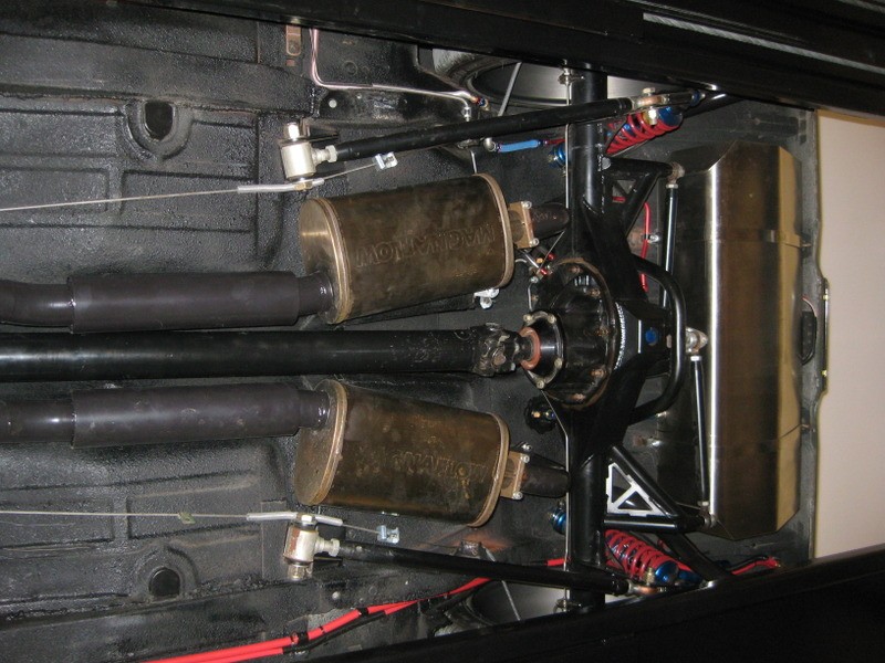

On a quick (and somewhat wine impaired look) it all looks okay except for the exhaust reliefs in the rear cross member. Let me take a shot of my exhaust system and see how much that matters.
Who's this coming from?
Edit: Took a quick look this morning. I can't get a good picture. That said, the exhaust is probably about 1/2" into the exhaust relief on the cross member on both sides. If you buy this setup, I'd add the exhaust reliefs, but move them inward a bit.
