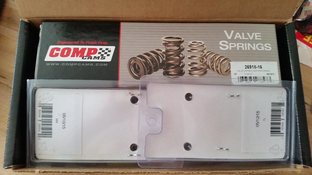

While doing some research on the CNC l92 heads that I have - I found out that the valve springs on those heads are the truck valve springs - and not the LS3 springs. The max lift on this springs is not high enough for my LS9 cam - so I decided to go aftermarket and upgrade my springs to the Comp Cams 918's. I got a 10% off coupon on the Power Tour - and used that by ordering form the trailer - they came in a week after I got home.

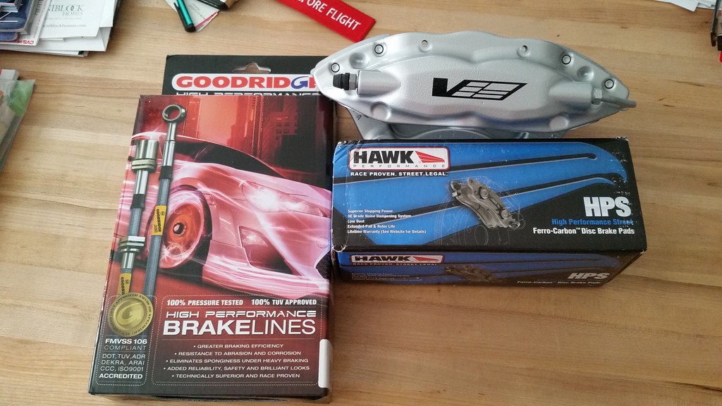

Also - after seeing a few 15 SS sedans on the Power Tour - and seeing a FB post about a Brembo rear disk swap - I started doing research. The 2015+ come with 4 piston rear Brembos - the G8 and 14 SS have a crappy single piston rear caliper and the rotors they used are super cheap and are already rusting. Since I have a set of 2009-2014 CTSV2 - front 6 piston caliper Brembos sitting in moving boxes - I figured I would get the rears. The CTS, Camaro, SS all use the same rear brake pads and pin kit - the calipers are for the most part the same as well. So using a set of 2015 Chevy SS rear rotors - CTSV calipers - I'll have a full Brembo set on my car.
Some may ask why not stick with the Chevy stuff - well the SS just says Brembo on it - no Chevy badges or anything - and then there is the price.
I got BRAND NEW both passenger and drivers side rear CTS-V calipers for $240 shipped from Amazon - the 2015 Chevy SS rear Brembo is $360 a piece!
So - I will soon have V brakes all the way around - also Hawk HPS pads, and Goodridge SS brake lines:

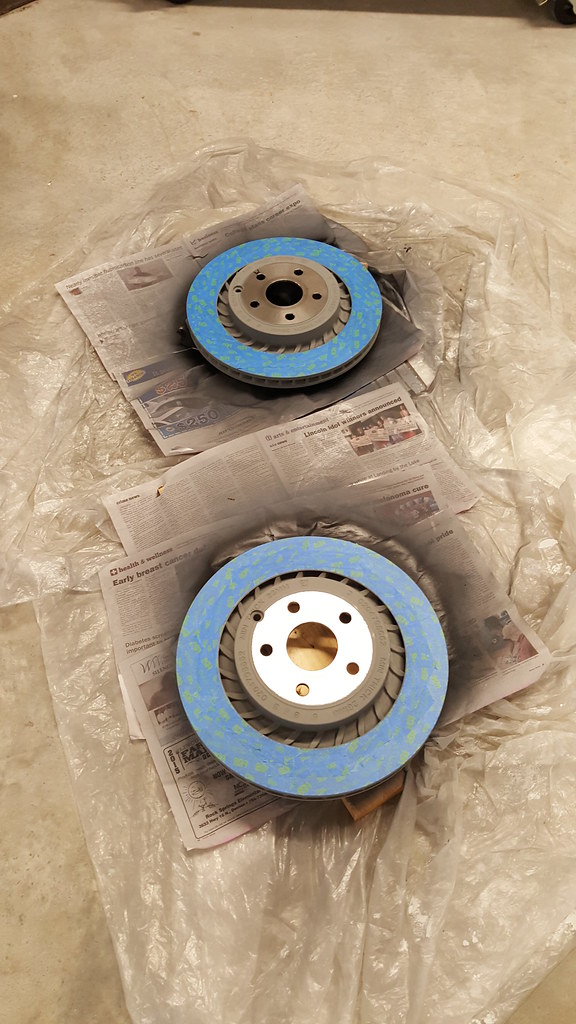

Third - The first project I plan on starting will be the CTS-V front and rear brake swap on the SS. I had the Front 6 piston brembos on my G8 - now that swap involved drilling out the iron spindles to make the brake to caliper bolts fit. I had been waiting to do this on the SS because I didn't want to do any big projects until I got the lift setup. Well I just found out the SS has the bigger holes in the aluminum spindles already - so its just a bolt on, ugh if I had only known! So I masked up the fronts and will paint them this weekend:
Brakes by 3M:

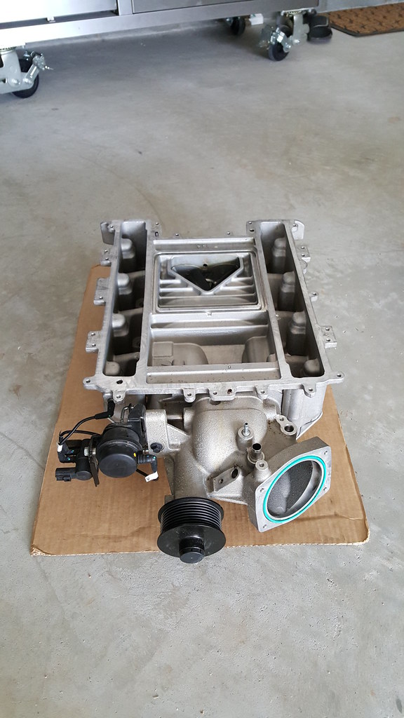

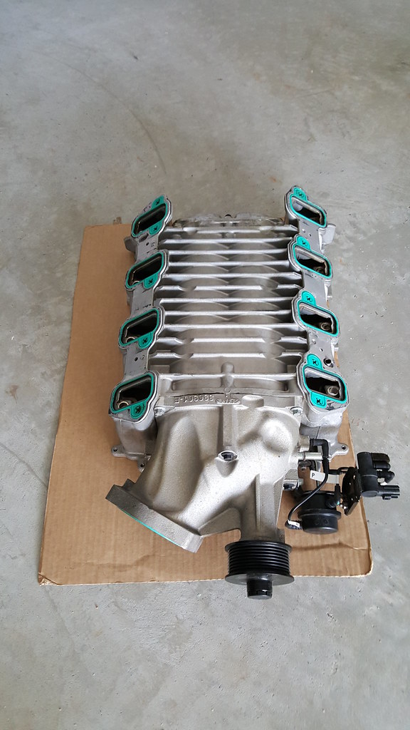

This is an LSA blower from a ZL1 / CTS-V. I got this lower blower half for a really good price. These blowers have coupling go bad inside the blower. GM doesn't want to spend the time to tear into them and replace a $40 part. Replace the OEM coupling with a CNC Delrin one - and boom you got a blower at a really good price.
Now this is going to be a long term project of collecting parts - as I still have a warranty on the SS for a few more years. I still need to get the intercooler/top lid - the pulleys and fuel rails and rest of the parts for this to be a complete bolt on.
Plus I need to get the E-Force installed on the Vette first!

So I got the fronts painted up - and have started on the rears. I will start those tonight.
Once I finish my MaxJax lift install - I will get started on this brake project.

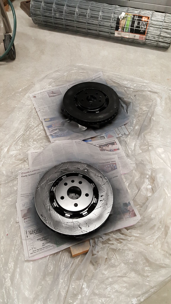

I got the 15 SS rear rotors painted up - now its time to flip the bleeder screws and the brake fluid passage tubes around on my rear V calipers - will ride on the back side of the rotors - vs on the CTS-V they ran on the front side of them - this will keep the smaller brake piston on the bottom.

I got the rears fixed up tonight - and everything together for the swap - now I'm just waiting to finish up the lift install!
