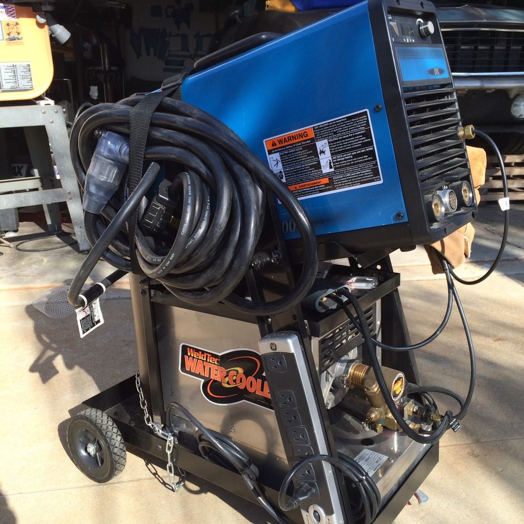

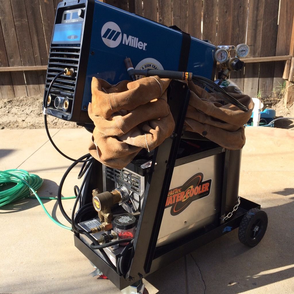

Found this on Craigslist and just had to have it. It's a 2008 model . No blue arch start or wave options but only had 5 hours on the clock. got me HF cart , cut and reinforced it and was able to package it pretty well for Mobil jobs. Now I spend all my time learning how to use it and forgot about my Camaro project.
