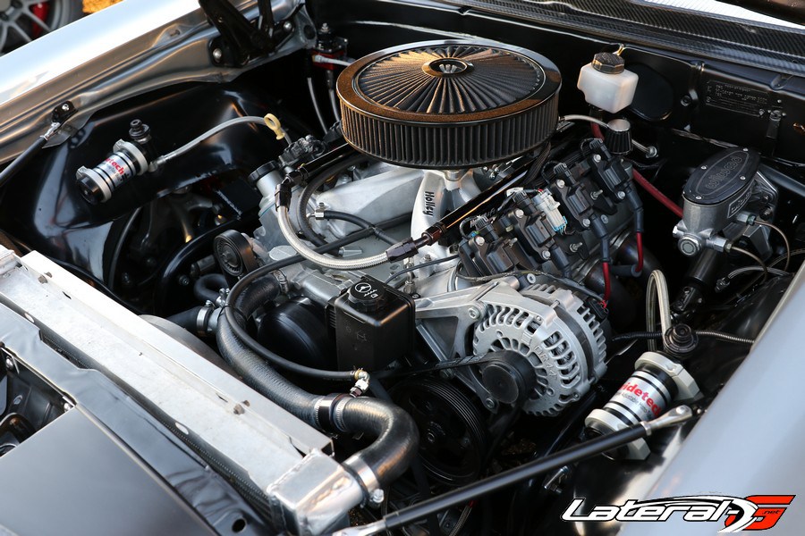

Would you mind posting your fuel injection setup? Good chance i will go with an LS on a truck project, but i want to use a 4bbl throttle body, and holley dominator setup.

I have the single plane Holley intake with the Holley 4 barrel 1000cfm throttle body, stock LS3 injectors and Holley HP EFI to run it. Only thing you have to do is re-wire the IAC pins in the harness. Use the harness for 24x or 58x and switch 2 pins.
