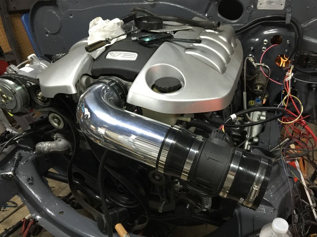

I missed my goal by two days. My FIL passed away on January 28th and I got the motor running on Saturday the 30th. My wife and I had been caring for him 24/7 for the last five months and I had limited time to focus on the car.
I'll start with the older updates
Here I got the subframe paint (by my kids) and mounted.
I took the top end off to swap the cam and remove the DOD.
The engine has 145 thousand miles on it.
Dual Valve springs and titanium retainers.
Modified the Passenger header to clear the Tru-Turn.
1969 Firebird, L-76 LS2, T56, Speed Tech Torque Arm, Build Thread
Instagram @jimmysean69

Welded on reducing collectors onto the headers.
LS7 Clutch Kit
Engine and T56 mounted
Fuel Line whip from Tech AFX
Battery Mount
Mounted the Tanks Inc gas tank, used electrical heat shrink in the straps.
Trans mount and torques arm mount.

I made my the battery cables. Bought the supplies from Polar Wire Products.
Modified a DSE pedal mount to work with the G8 GT pedal
Hurst Shifter and Twist Machine stick.
Finishing the wiring for the ECU and fuel pump.

Here is the start-up video. I have had this car for 16+ years and this is the first time it has ran since. The motor popped and had me concerned but I have since started it a few times and it seems all is well. Maybe it was learning?
