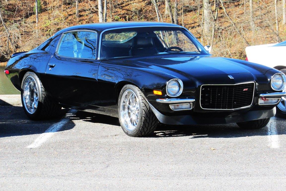

Im running 5.5 backspace on 18x12 with DSE rear and quadralink
May I ask if your fender lips are rolled or trimmed? Any pics?

Lips are not rolled, i have 1 inch to the inner tub and 1.25 inches to the outer quarter lip. Cant remember exact length of rear but its DSE so they could tell you the correct length.

sorry posted same pic, i can take pics of the rear supension, fenderwells anything you want to see, just let me know.

Please, this whole set-up is spec'd by DSE but of course not going together as I envisioned. Pics would help a ton!

If anyone else can post pics of the wheel lips would be highly appreciated
