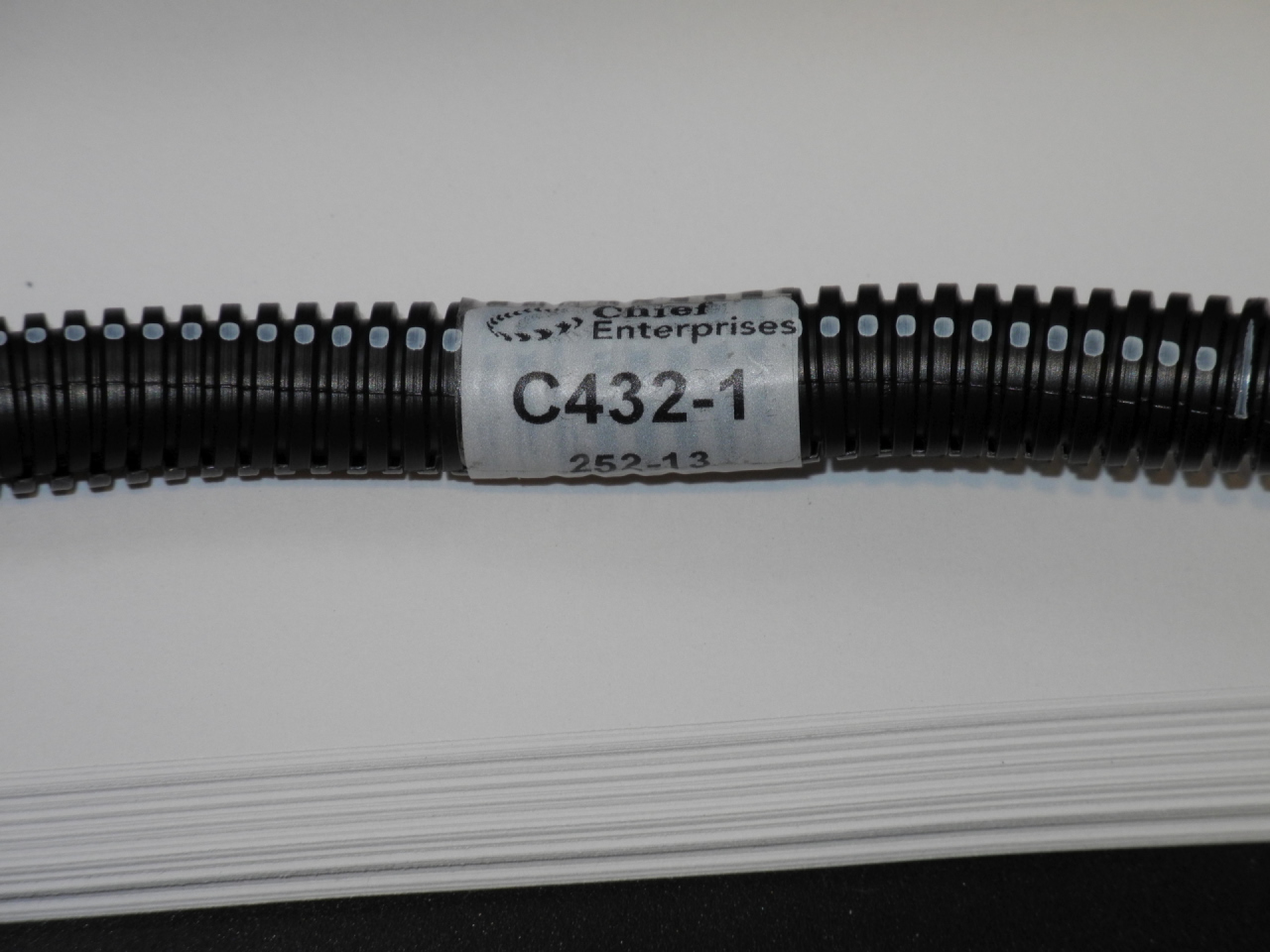

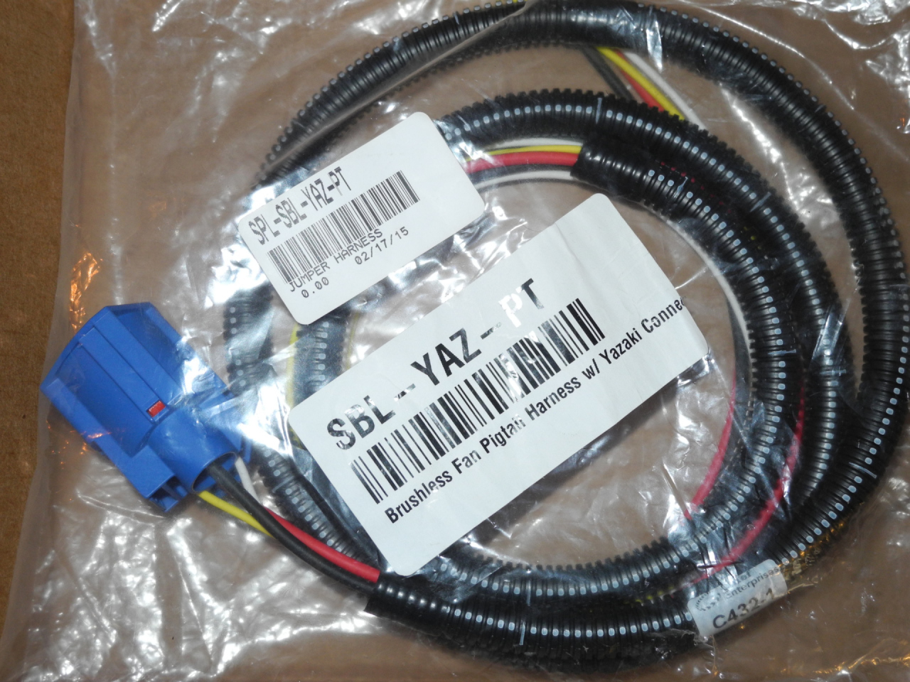

If it's the same connector that the SPAL brushless uses it's a Yazaki connector, I tried to source one without much success so I just bought the SPAL version which is assembled by Chief Enterprises

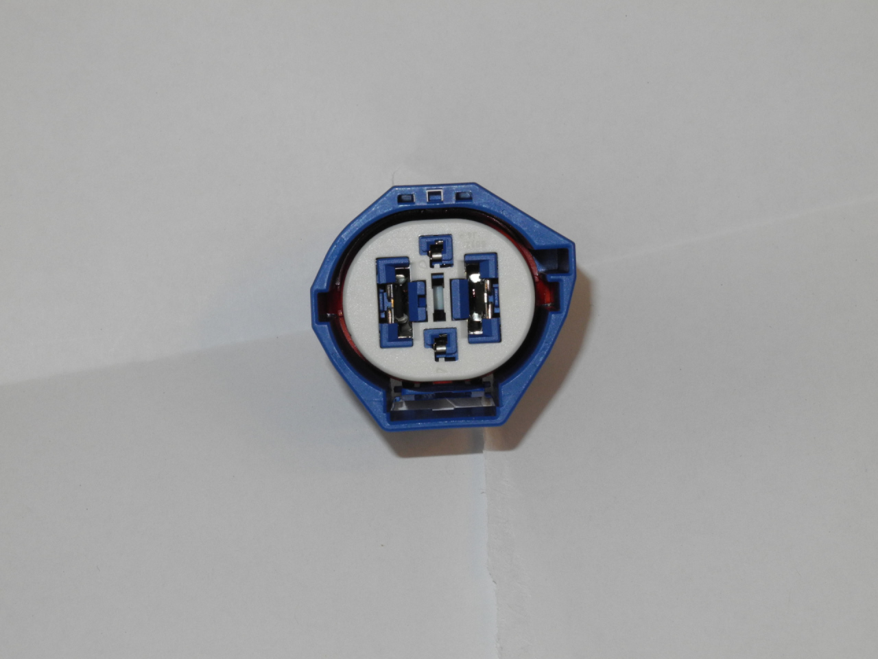

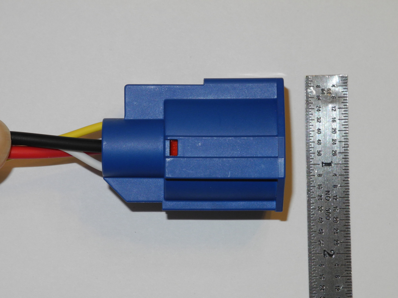

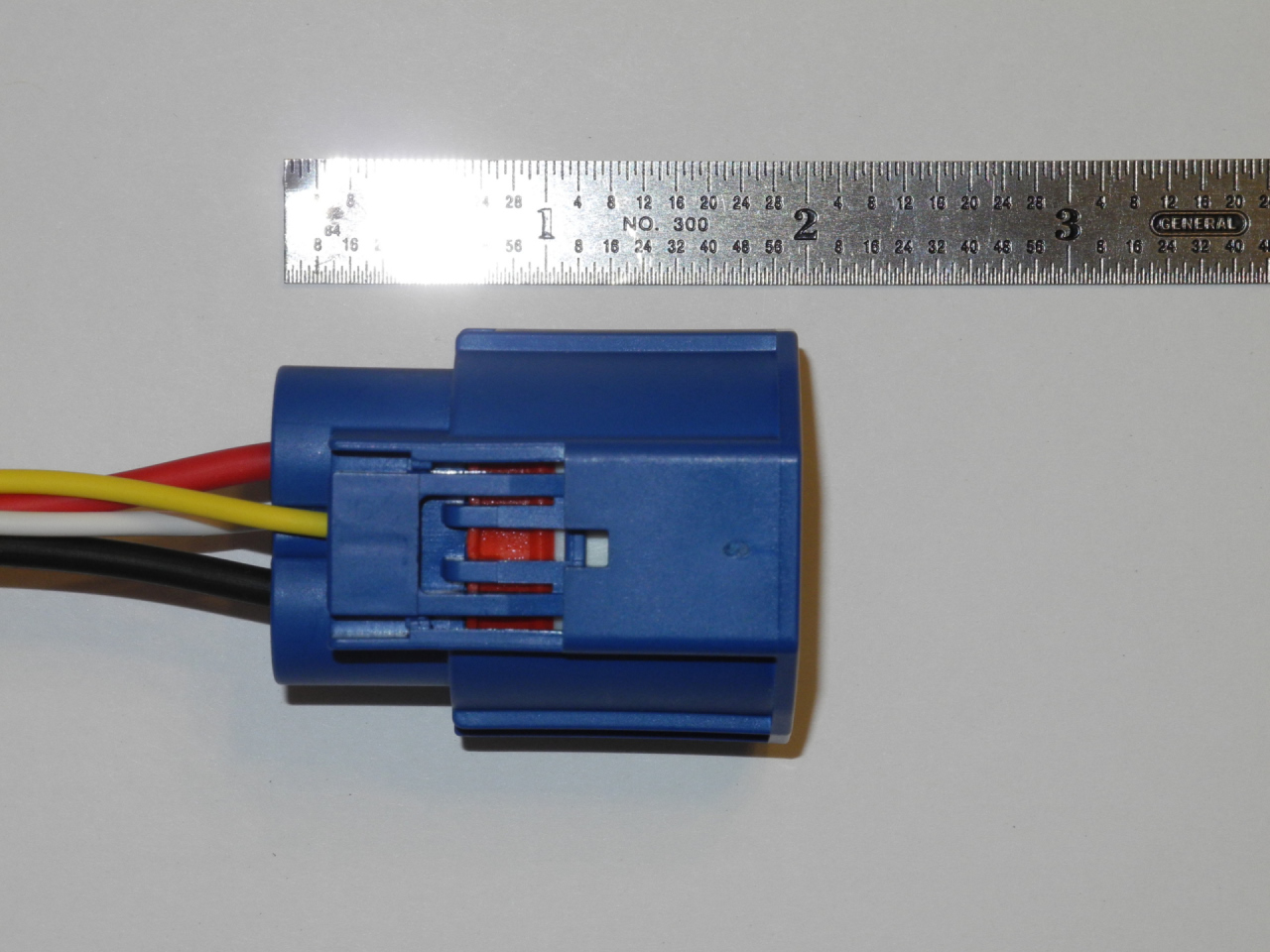

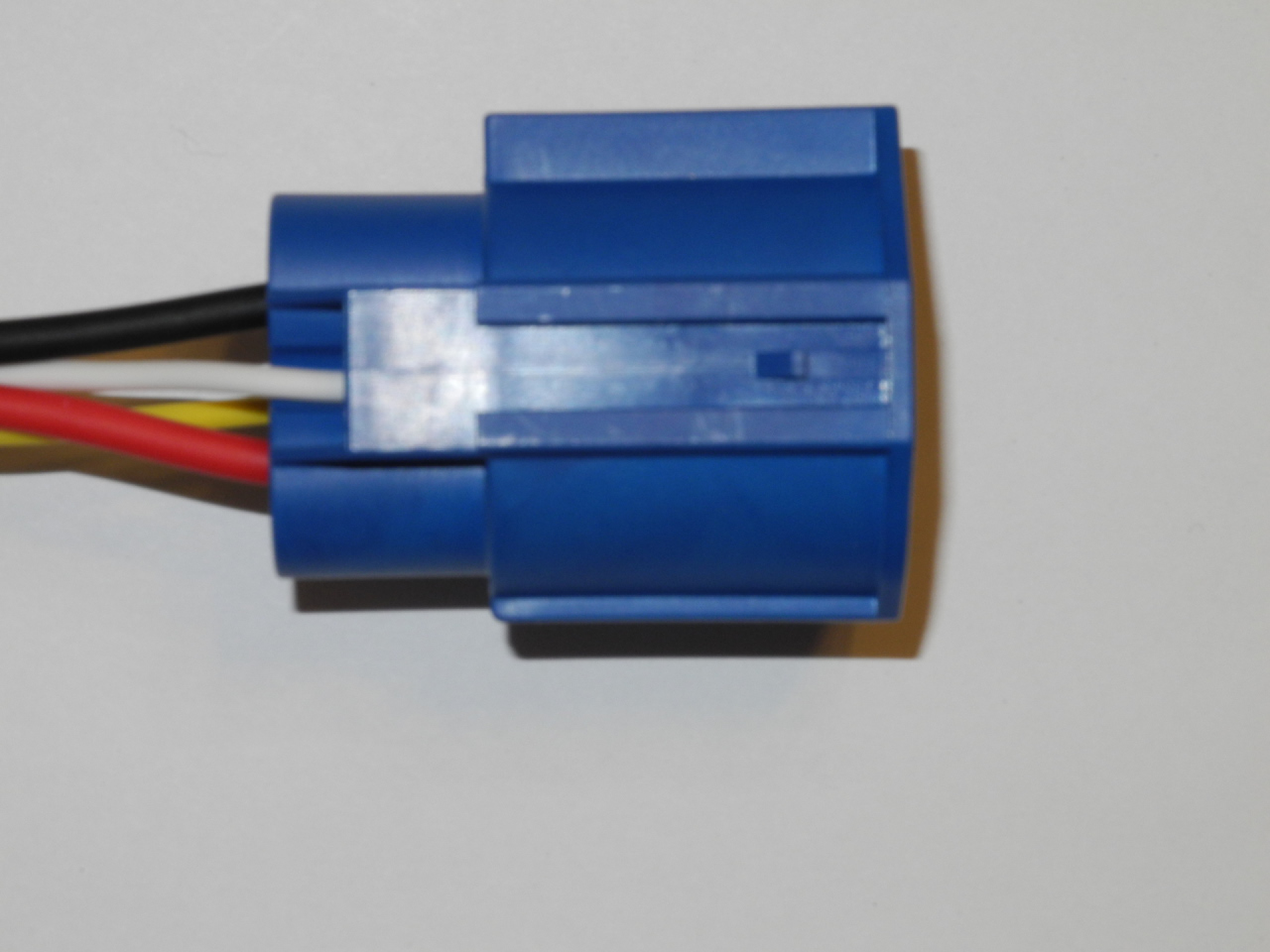

So I found some interesting information regarding the C6 fan controller and the Yazaki connectors. Someone on YB reported that the 2006-2009 Ford Fusion uses the same controller as the C6. So I went to the Pull-A-Part and their inventory showed two in stock. One had the whole front end missing, so that was a bust, but the other was mostly intact and had the radiator removed and was sitting on the engine, as if presenting itself. Low and behold, on the fan shroud was a very familiar finned aluminum box. I had to borrow a T25 Torx, but after a minute I had the controller off. The connector at the controller looked exactly like the Kostel connector that we've been sourcing from Mouser. On the power feed side was a mondo Yazaki male connector. Of course on the chassis wiring side was a matching female connector. I scored the whole thing, took it home, plugged it into my Cougar and it worked perfectly.
Today I went back and got the female Yazaki connector from the Fusion that had the front end missing. These connectors are super robust and by the accounts here, should fit the new CTSV/ATSV fans with the built in controller.
Now, if we can only find the part numbers for the large female terminals, then we will be all set!
