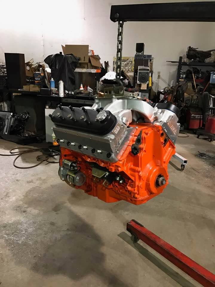

Nice looking motor, Mamo knows his stuff .
Yes he does!!
John, don't leave us in suspense, we need some engine specs please!
Thanks Dad!!

Motor specs.
It's Chevy orange. Has a chromo crank.
Connects to the TR6060 via a pretty clutch.
