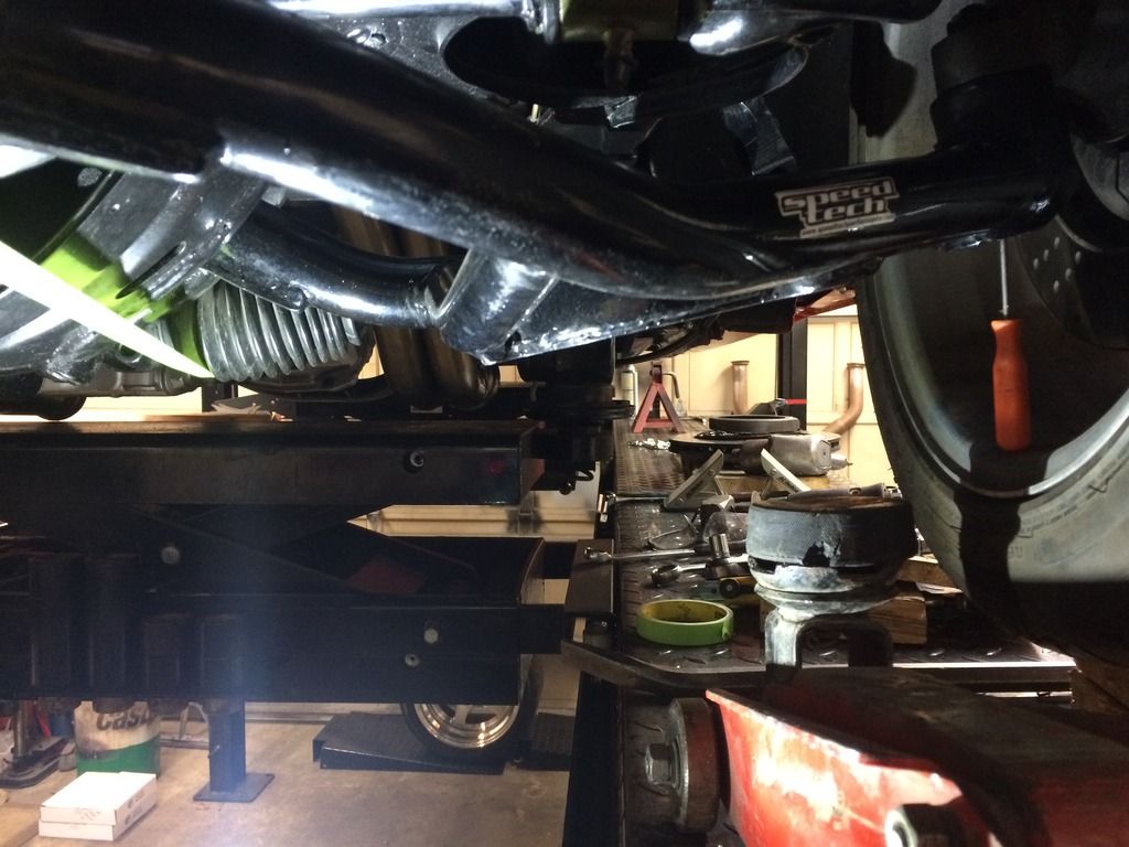

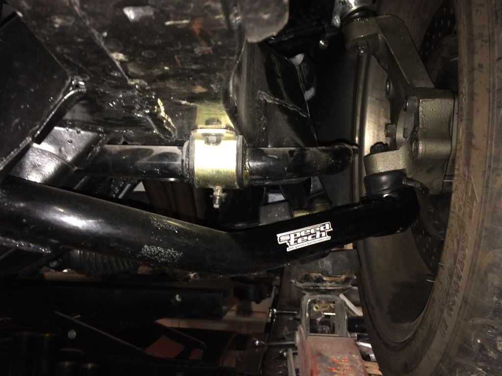

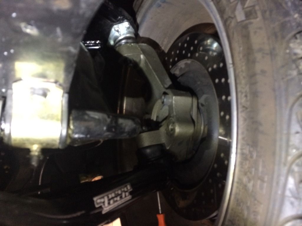

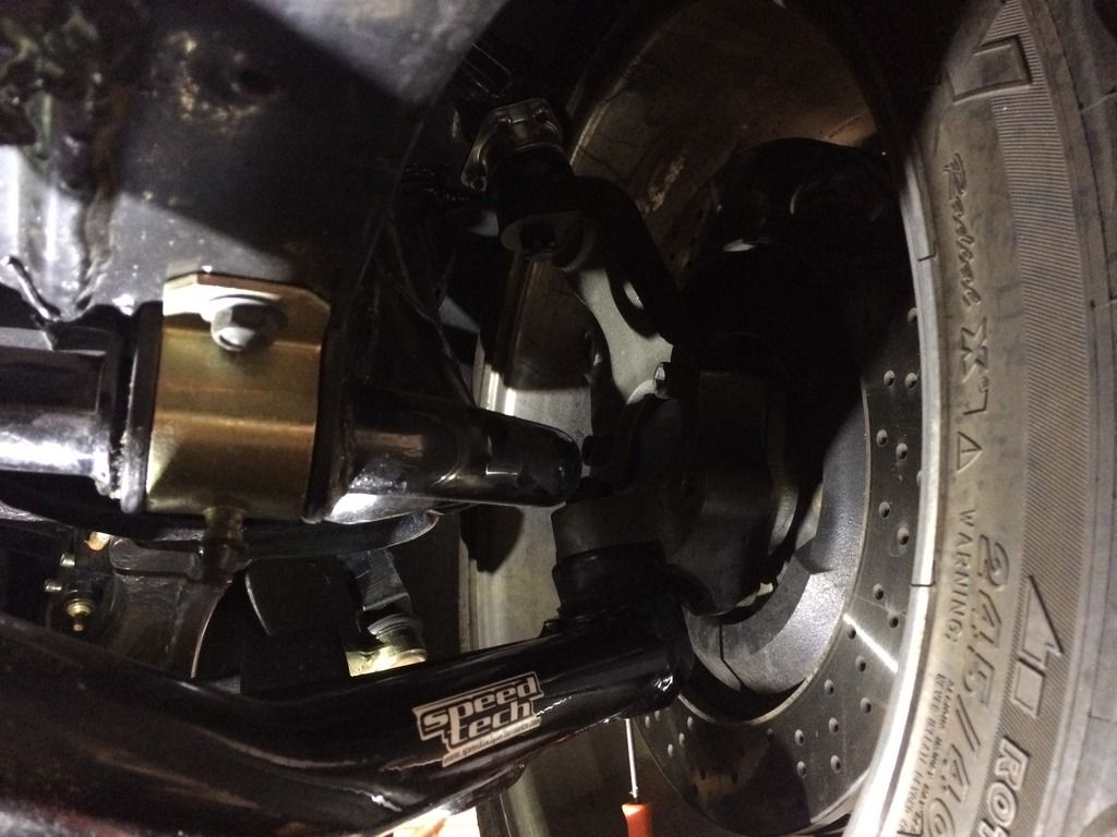

I am gonna swap out my coil overs for a set of ride tech to match my 4 Link. I was taking some measurements that Ryan asked for at ride height and was wondering if my lower control angle is ok? The bottom of the control arm is not level to the ground.
