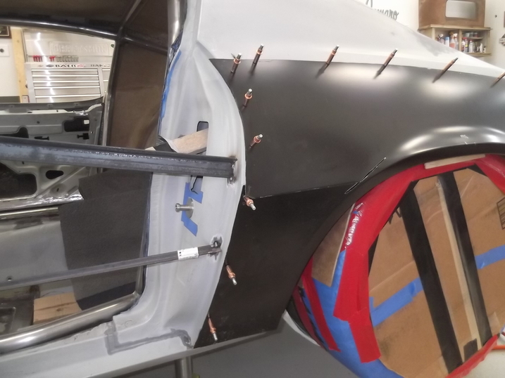

If you look at the pics I posted you will see that there is about 1" of the original fender behind the door jamb, that's the "stretch" in the front. I would have done the same in the rear, similar to Steve and John but I opted to just let the rear end get wider...and yes this will require changes to the rear tail panel which I had already planned for. No real play book here, I do recommend looking at Steve and John's builds, both are done very well.

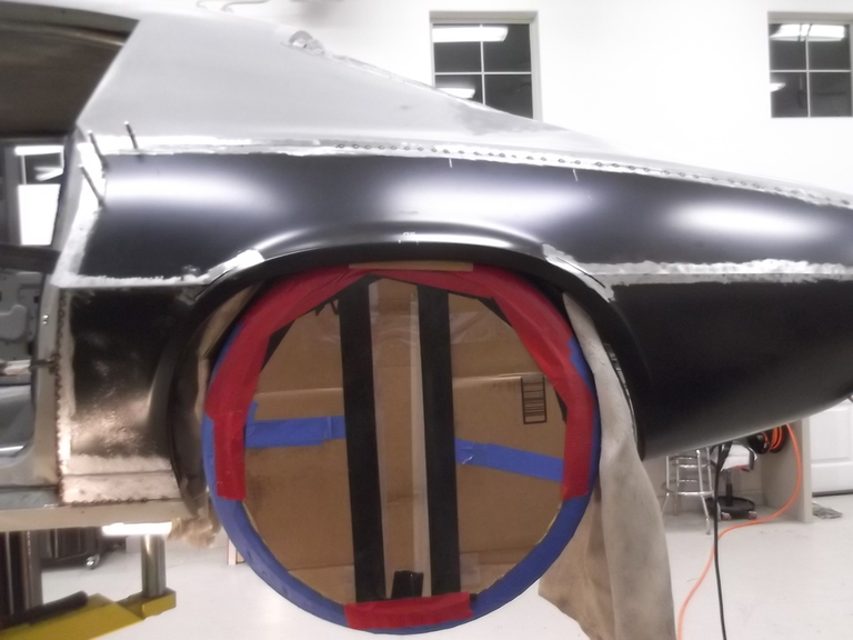

Driver side rear flare underway. Should be done tomorrow. If anyone ever uses this method to flare a sec gen, the key to the upper line flowing properly is bracing the joint from the backside. Kind of boring pics to put here but if anyone wants detailed pics, PM me and I will send them to you. Worked pretty well. One pic included here, you can't see the nut behind the square tube with the washers but it pushes the tube which pushes the existing and the new fender into a nice flowing line.
