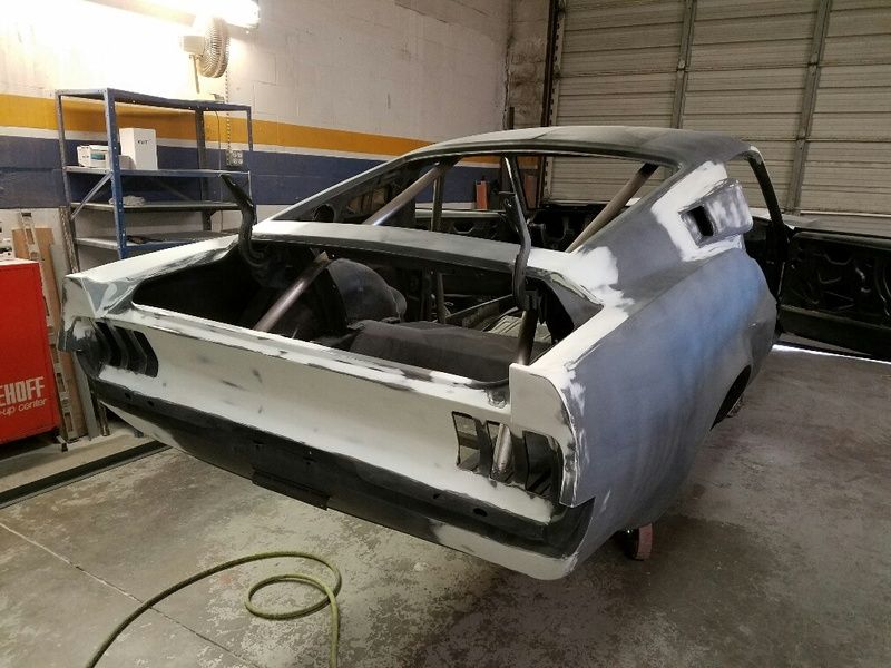

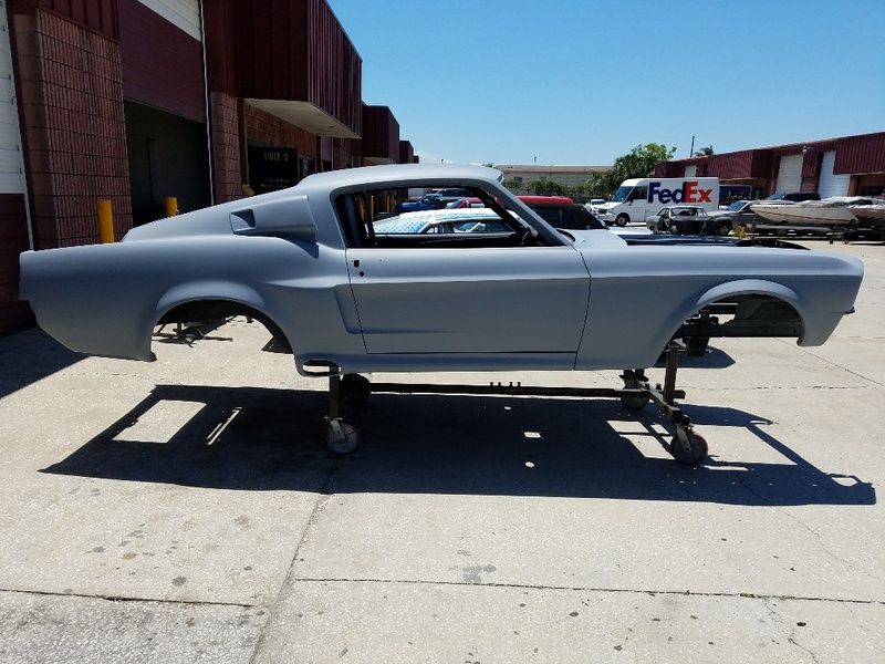

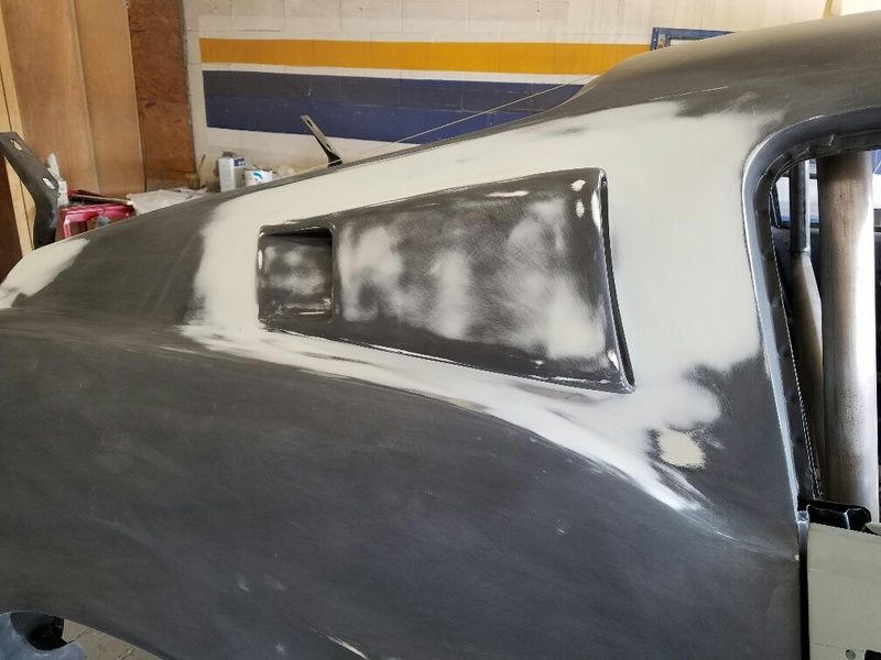

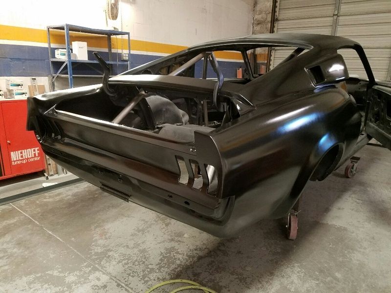

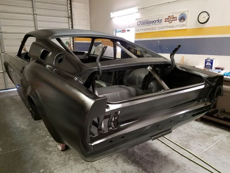

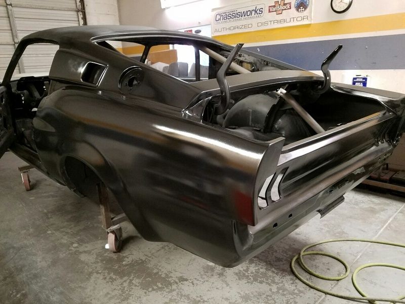

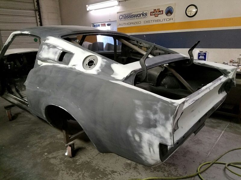

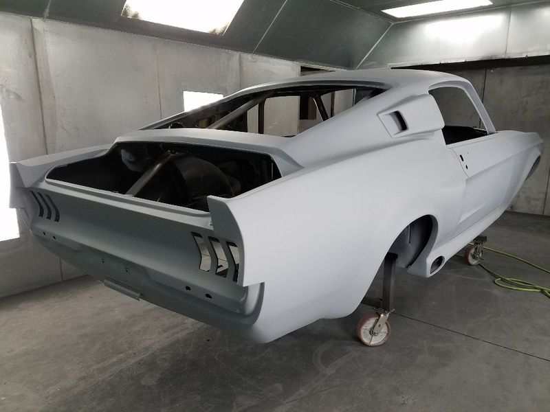

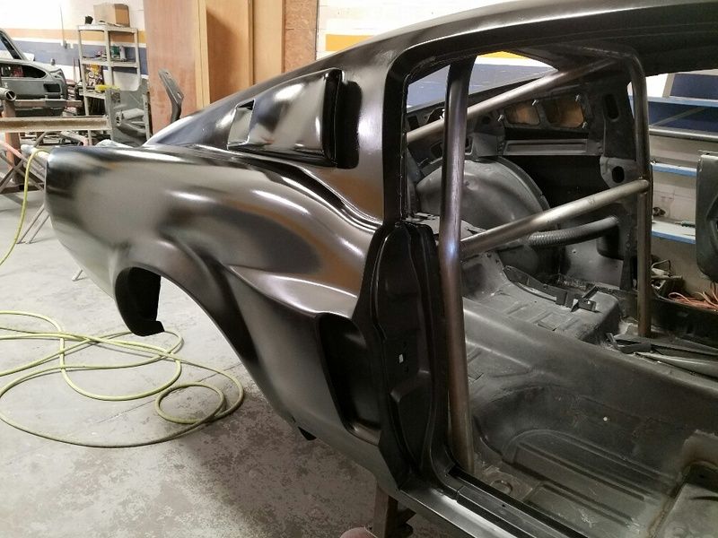

Quarter scoops were bolted and bonded with 3m8115 panel adhesive.
Major bodywork finished on the rear of the body yesterday
Today I sprayed two coats of SPI epoxy primer

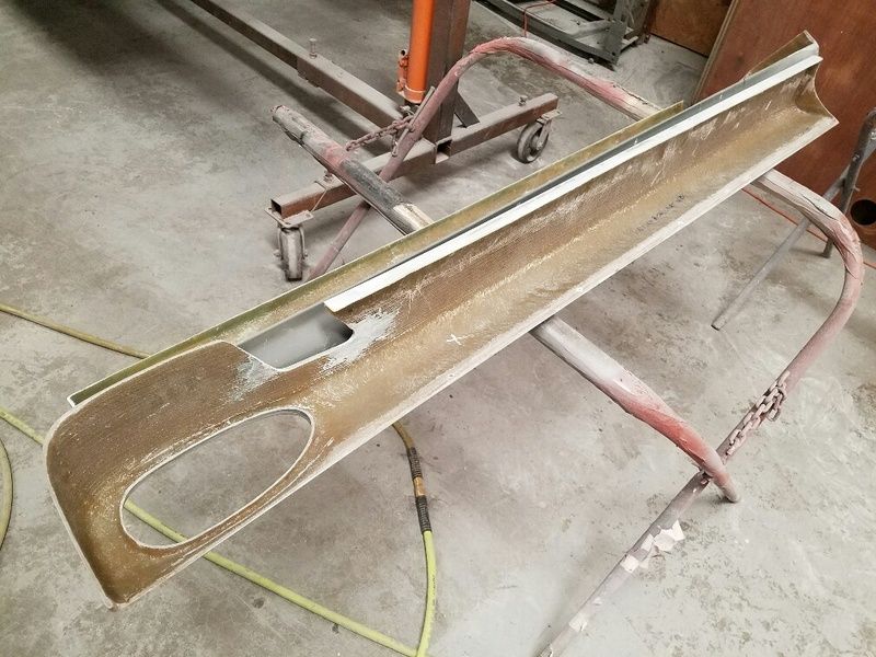

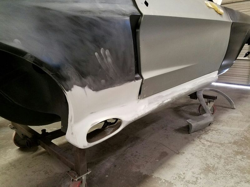

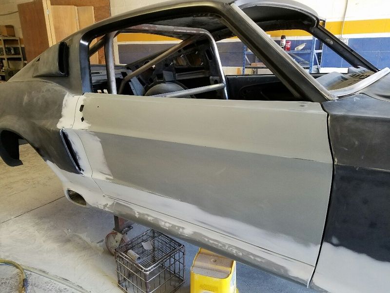

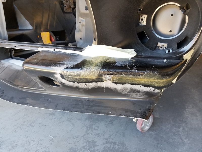

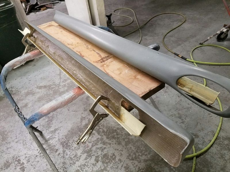

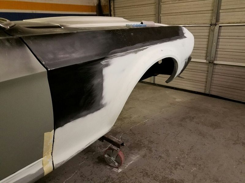

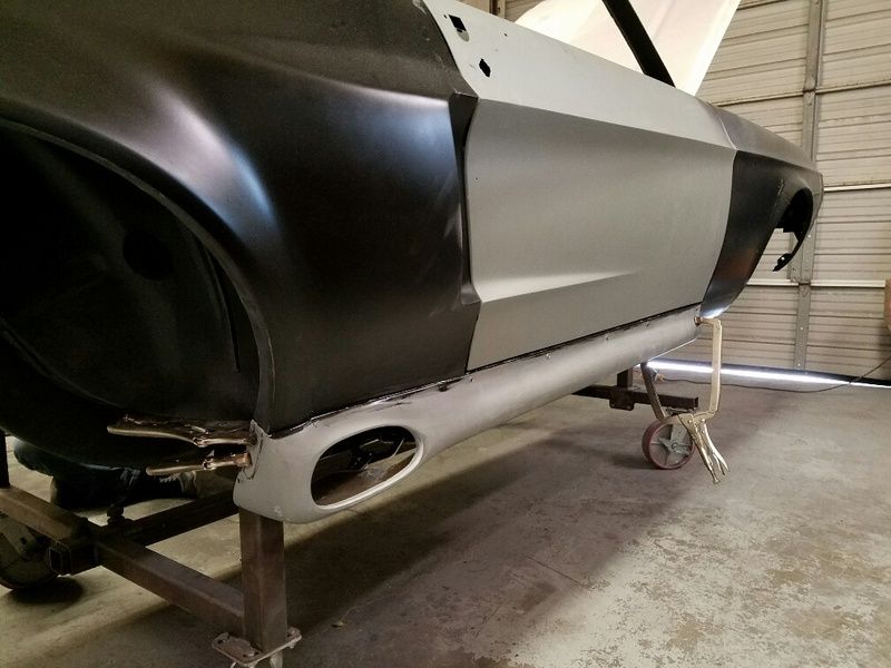

We had to add fiberglass to the side exhaust skirts to give us something to bond to the pinch weld.
Bonded to the rockers

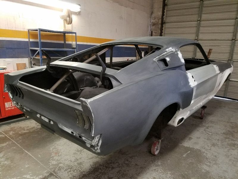

Started the bodywork

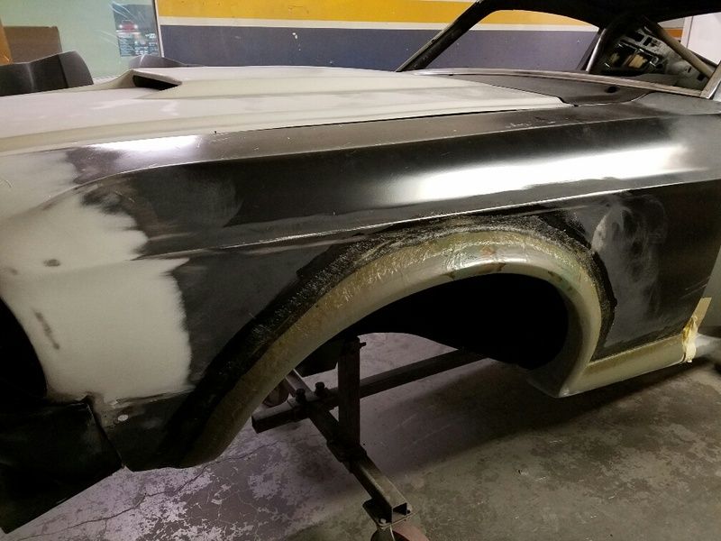

Headlight bucket was bolted, bonded and fiberglassed to the fender
Front fender flares installed
Bodywork getting everything to line up
Ready for a couple coats of SPI epoxy primer

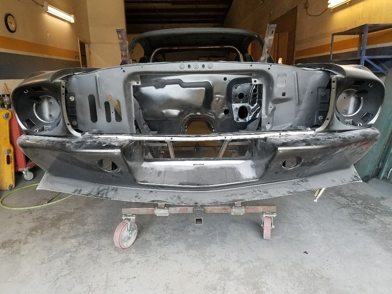

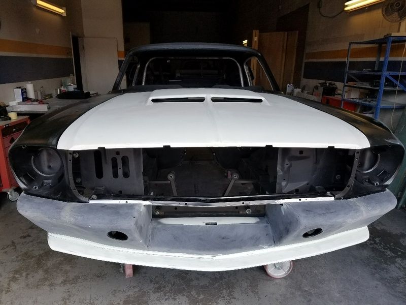

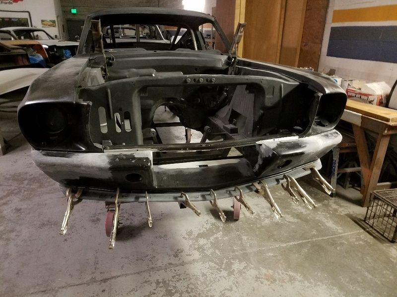

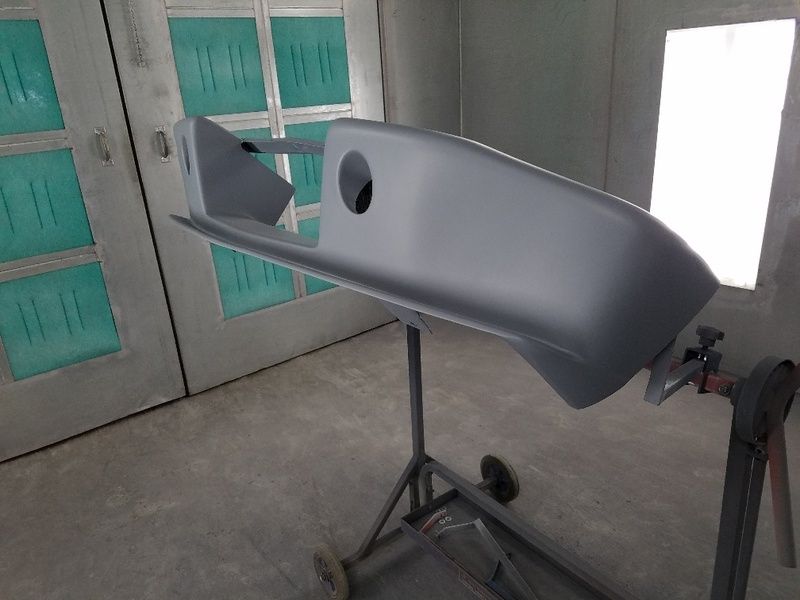

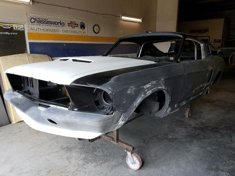

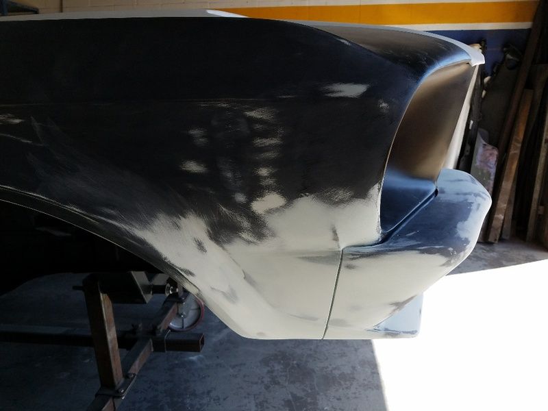

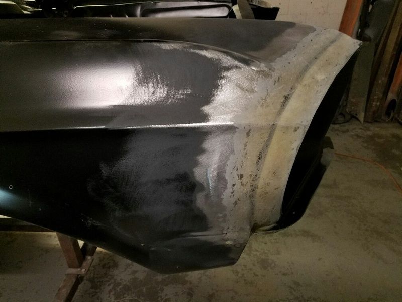

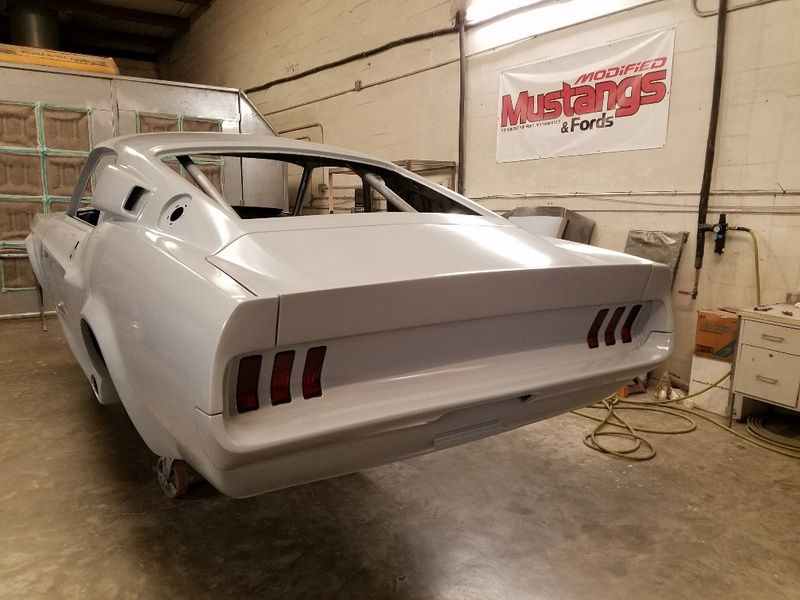

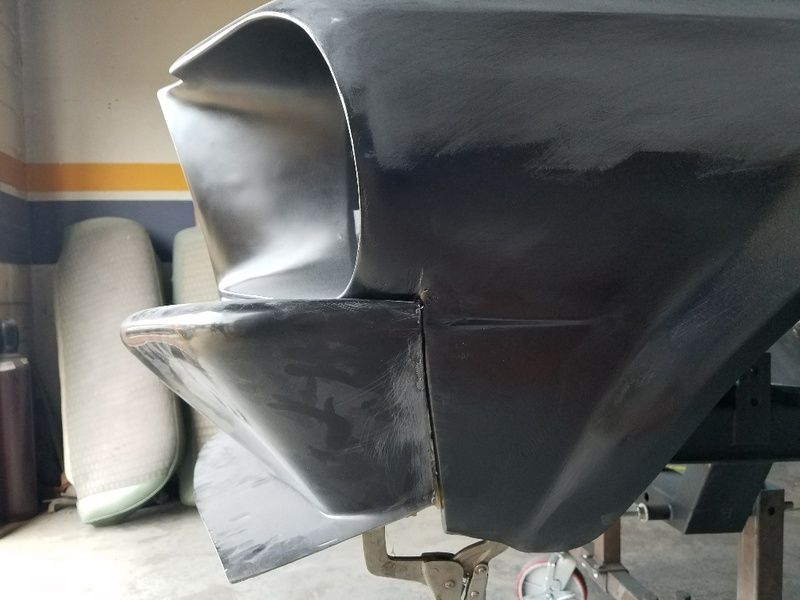

Starting to fit the front apron
The shape was wrong under the headlight buckets so we cut it apart and glassed it back together
The spoiler was cut down and the front lip bonded back on.
After sanding
Bodywork to match the fender to the front apron
After a lot of sanding and priming

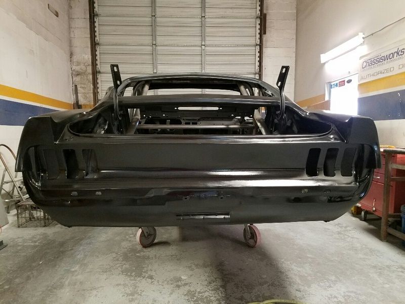

SPI black epoxy to seal the bodywork
Two coats of SPI Turbo primer

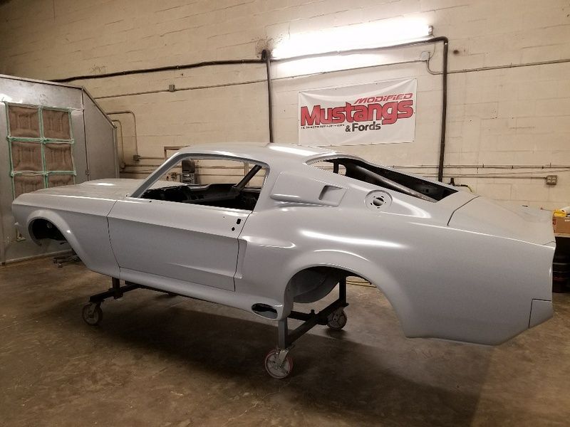

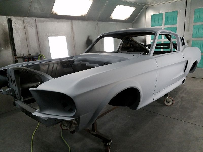

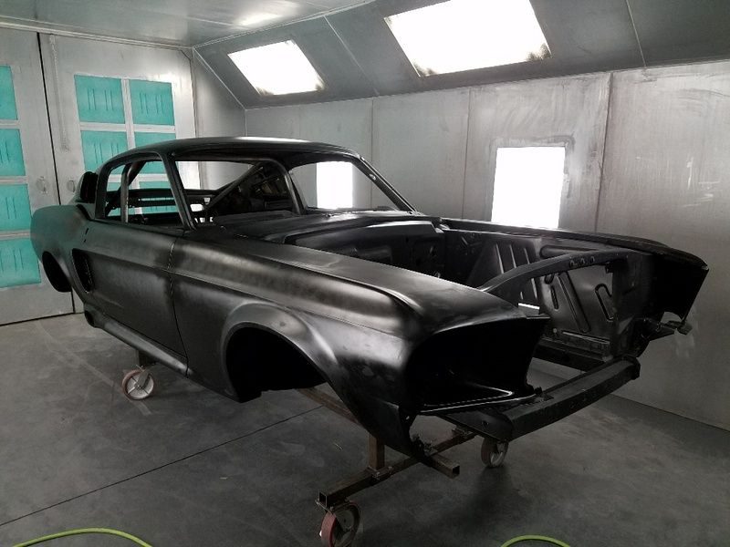

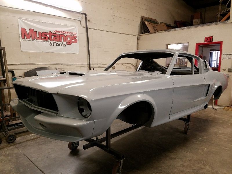

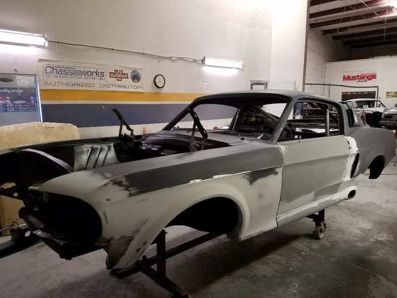

Test fitting all the body panels
