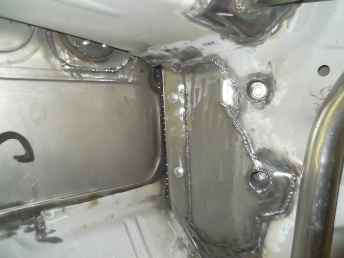

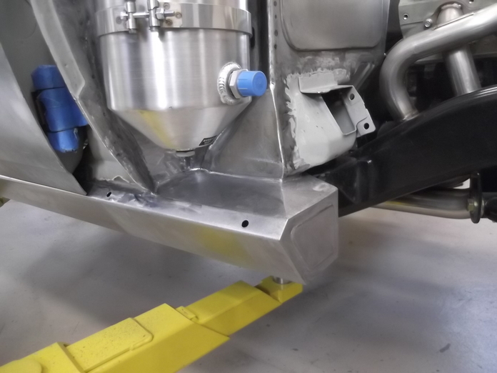

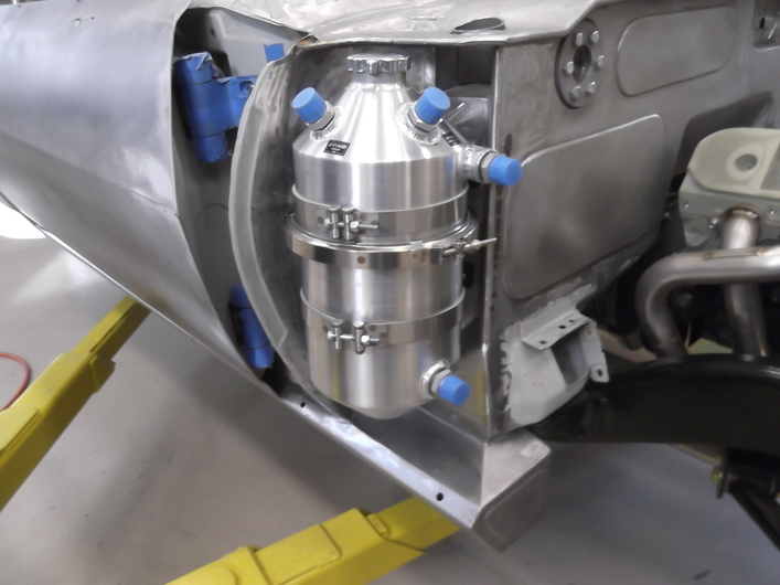

Combined the install of a 2.5 gallon oil tank with finishing the fab of the extended rocker panel. Thanks to many here...Steve, JJ, Tim McGilton and others for the concept and advice!
Used a 1" tube through the rocker to provide access for a bolt to attach the front fender. Even though I've done everything I can to eliminate any water from getting down here, I still prepped the metal to withstand the elements.
These access holes will be covered by a splitter...coming later.
Had to push the tank into the interior just a bit.
Sealed off the rocker.
Sealed off the interior.
Will have to relocate the filler and install a site tube. Prepped for this but will wait until I'm routing the oil lines.
Have a great day!
John
My Build Thread:
https://lateral-g.net/forums/showthread.php4?t=53320
