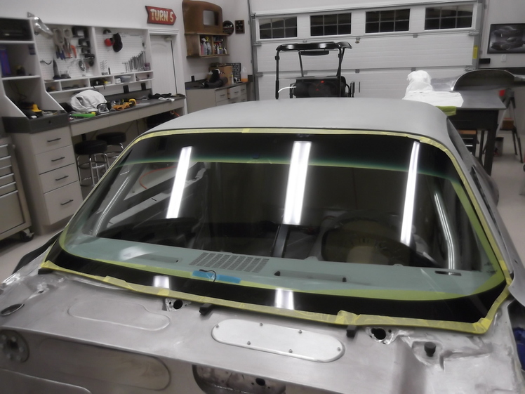

Test fitting the Fesler flush glass. Fits well!
Attachment 64079
Let me know how that goes. I am still tempted.
