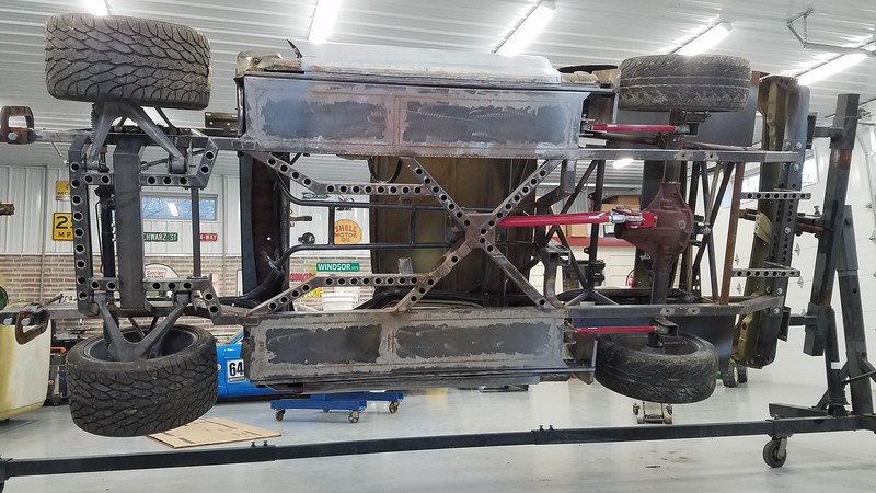

Are the wheel lips the same height? Looks higher in the front? No?

Did Vince or Greg tell you to ask that? Ron Sutton did the suspension design where he had me take all the rake out of the car. Me knowing I will at least have 1" of rake on the street. Fearing if I made them the same front to back, the car would look like it had Gabriel High Jackers on it when I did put some rake in the car. I lost all my Foghat 8 tracks, so I had to cover the tires a bit in the rear.

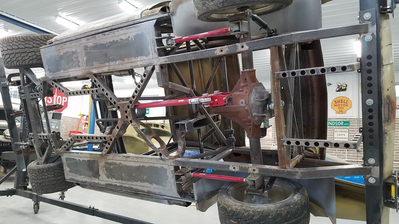

Finally got the crudely welded together panels done. Pull some fiberglass molds off of these panels, then the part. Yahoo, then I get to do body work attaching them to the car.

Quarters have had the molds pulled, now I need to finish the welding on the car

Let the sparks fly!!
Thanks for showing the undercarriage, it's VERY interesting!!
