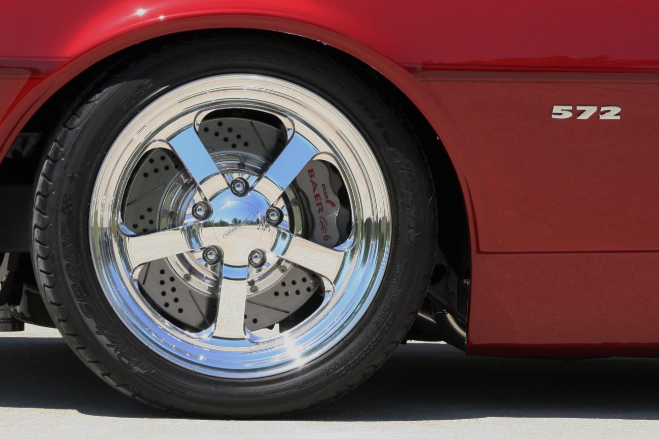

As you can see in the attached pic, I run 6 piston staggered bore Baer/Alcon's.
For me, it was the best available at the time. Think 2004.
Yes, it took me forever to build my car.
Although I don't have much to compare them to, like the new market.., but my Baer/Alcon's stop my car like the dog hitting the end of it's chain.
As far as your car, I'm clearly no expert, but if you are running what you are running in the back, I would go with a more robust front caliper.
My uneducated two cents.
