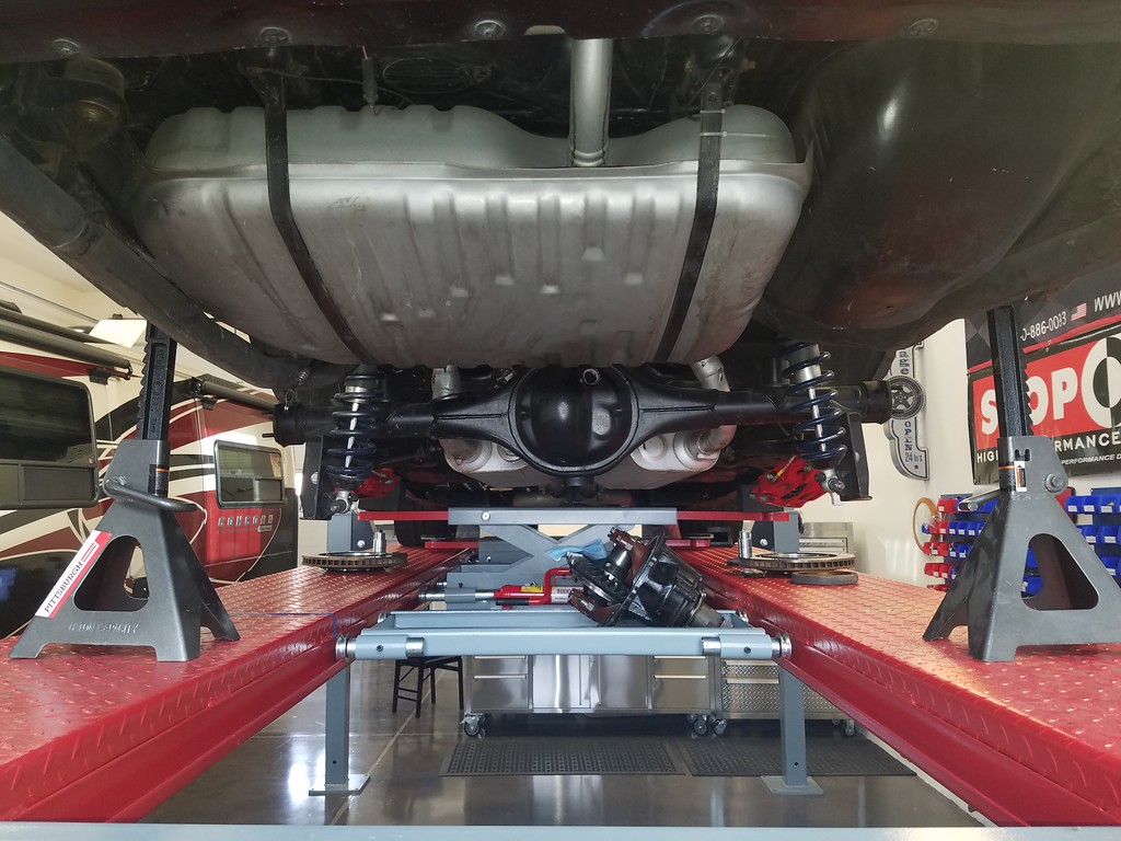

So I'm knee deep into my first project on the new lift, and thought I'd update you all with my experiences. The project was to pull the third member out of the rear axle to inspect and repair (metal in gear oil) and it involved getting the back half of the car up in the air and secure while lowering the rear axle enough to get the third member out from under the mufflers.

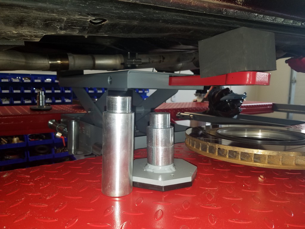

What I have found is the pad extensions for the chassis jacks are either too short or too long.
The long extensions won't fit under the frame at ride height and the short extensions won't lift the car high enough to get my jack stands under the frame.
There are a couple of different options to fix this and I'll probably implement them both. First a shorter set of jack stands (preferably with a flat pad type top) would make this a LOT easier and second, a set of extensions machined about halfway between the long ones and the short ones in length would also help.

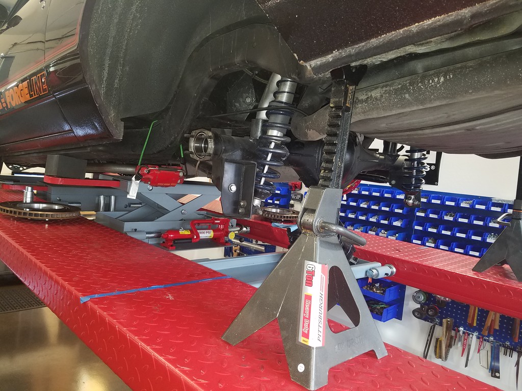

Here is what I ended up doing for now. I used two of the short extensions on each side and lifted the car from the #4 body mount position (right in front of rear tires) high enough to get my jackstands under the frame behind the rear tires. I then moved the chassis jack forward far enough to get out of the way and lifted it up high enough to just support the middle part of the frame as a safety measure.
At this point the car was very stable on the ramps and the axle was hanging low enough to get the third member out.

Rotary has these lift blocks for their rolling air jacks in two different heights. I have 8 of the tall ones and 8 of the short ones. They are nice and "grippy" for lifting on a round axle, pinch rail, etc. and don't dig in or leave marks.

Move the jack up so it rides on the top of the lift where the tires go. Works way better that way and gives full expansion at all heights.
That would be a 4" jump up on the whole jack assembly, pretty sure the pads wouldn't go under the frame at their lowest point then. Interesting out of the box thought though.

I really think the answer is very simply just shorter jack stands. I'm debating on either modifying mine or trying one of these sets.
10.71" - 15.6" tall
13" - 21" tall
Most stands (including mine) start at about 15" high

I have a set of the "big reds" --- they're real lightweight and a very small base.
I keep them in the trailer and use them more as a "chalk" to check the floor jack if changing a tire. They're "okay" but that small base -- under anything at an angle - that's dangerous. Dangerous enough doing that anyway.
