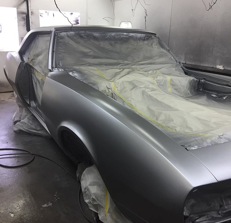

07-14-2018, 01:56 AM
Brianstanford
Join Date: Jan 2017
Location: Houston, TX
Posts: 146
Thanks: 40
Thanked 22 Times in 12 Posts

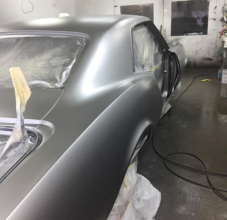

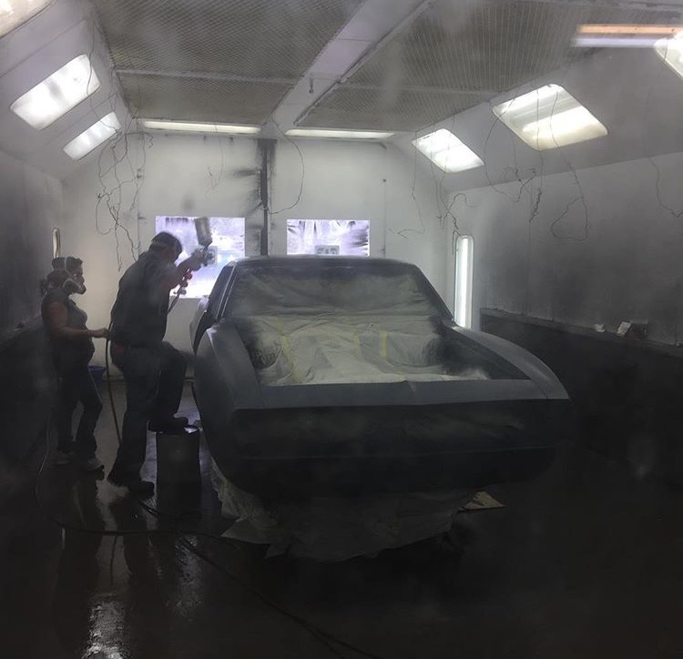

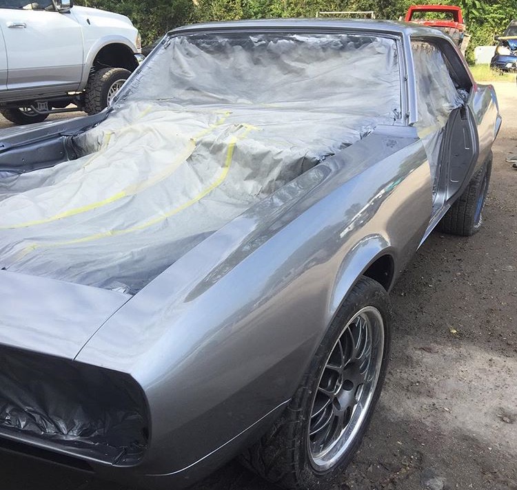

November 2016- She's in the spray booth getting some color. Went with Dodge Billet Silver Metallic
02:32 AM

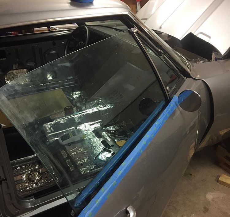

07-14-2018, 02:04 AM
Brianstanford
Join Date: Jan 2017
Posts: 146
Thanks: 40

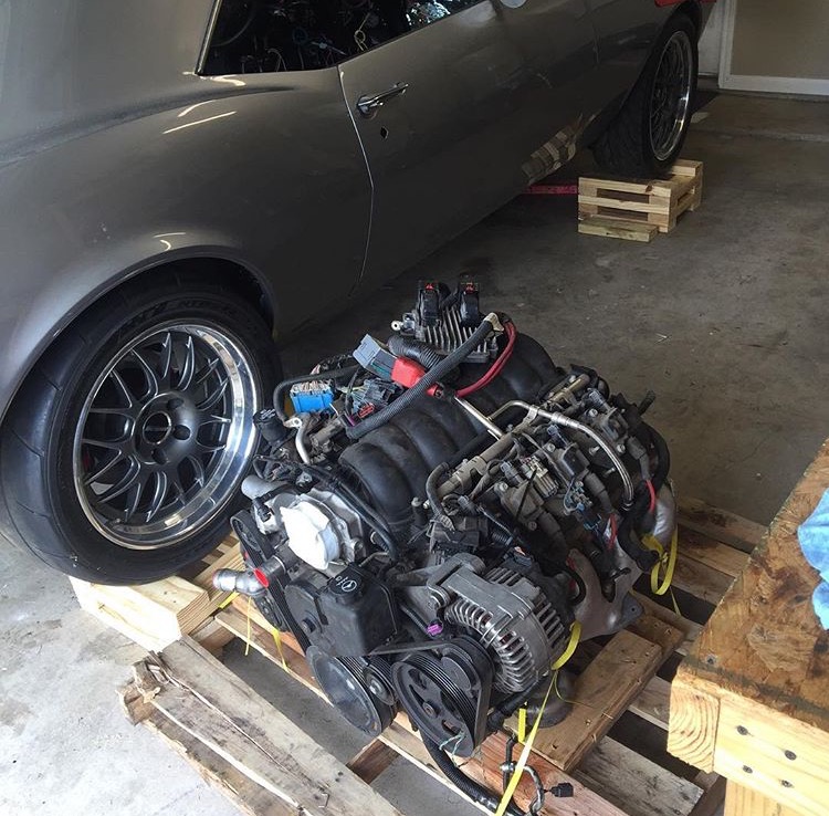

December 2016- Clear coat, engine bay, tail panel, wet sand & windshield/rear window in
Holley LS swap motor mounts installed

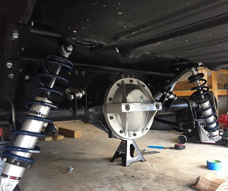

16
07-14-2018, 02:18 AM
Brianstanford
Join Date: Jan 2017
Posts: 146
Thanks: 40

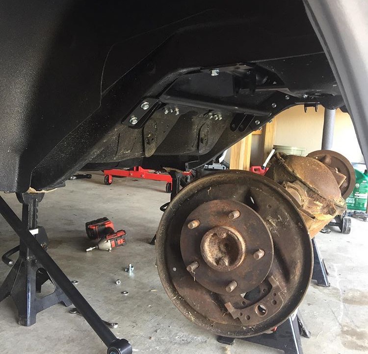

January 2017- Craigslist buy- '73 nova 8.5'' 10 bolt. Installing Ridetech 4-link. Built rear - narrowed 1/2'' each side, 3.73 gears, eaton posi, moser 30 spline axles & cover. 99-02 camaro rear brakes

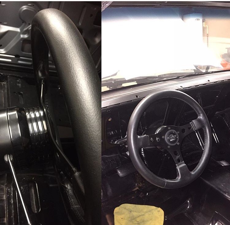

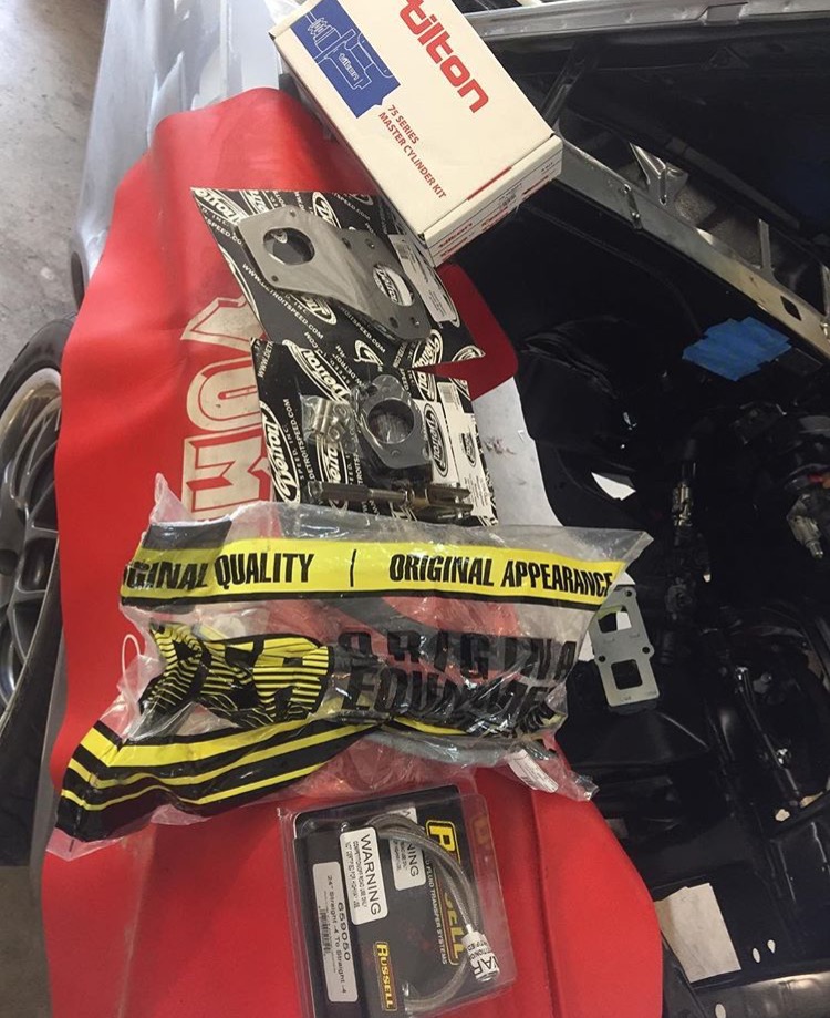

January 2017- Tough Stuff 9'' booster and S10 master. Ididit column with Grant wheel and Flaming River knuckle

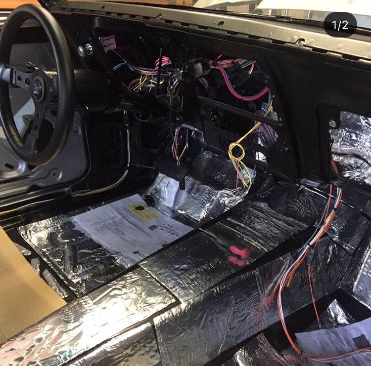

19

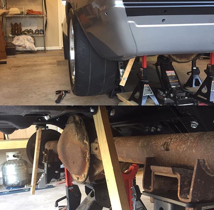

07-14-2018, 02:30 AM
Brianstanford
Join Date: Jan 2017
Posts: 146
Thanks: 40

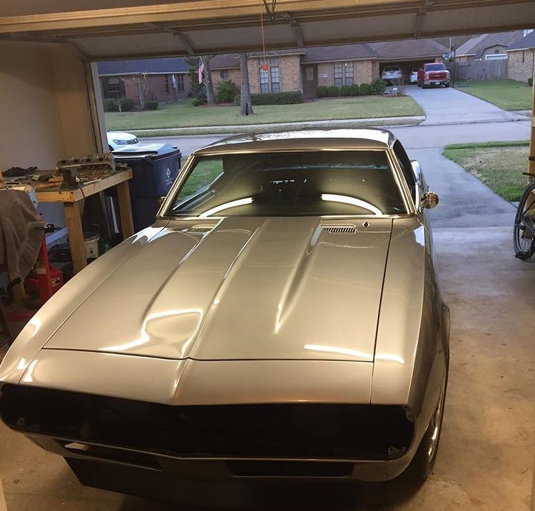

March 2017- Roller status!! I'm looking in to why the rear wheels sit so forward in the wheel wells. Would like to have them centered- picture #3....Any suggestions?
Brianstanford
Find all posts by Brianstanford

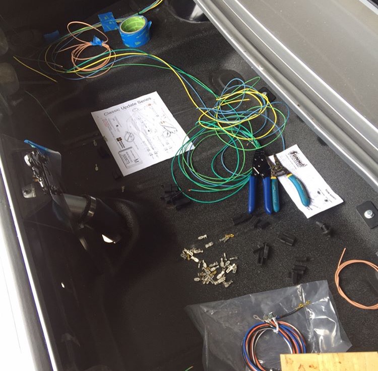

June 2017- Clutch hydraulics/parts. Sound deadener. American Auto Wire Classic Update Series
