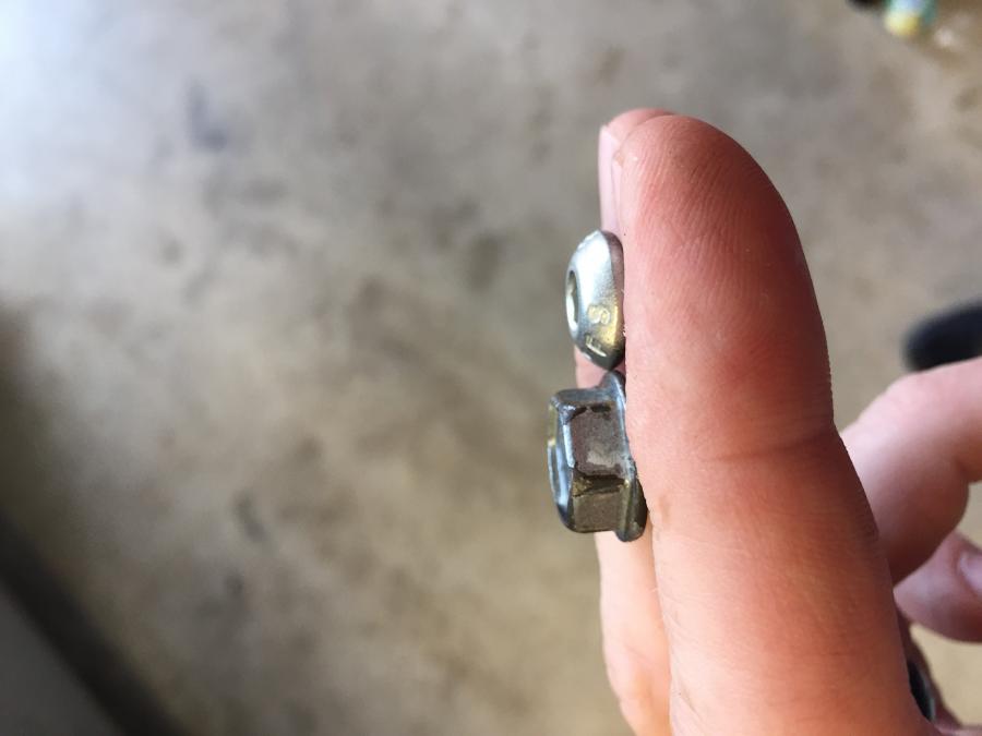

Already had some rubbing. Replaced the outer fender bolts with button heads and made some room with some hammer taps. No more rubbing
I did the same thing.
Add some negative camber for increased margin.
