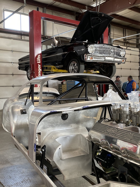

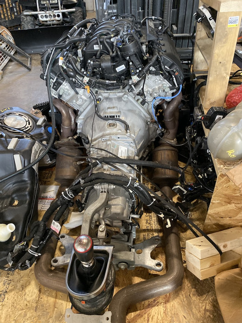

.... and we are off! We are now going to start the teardown of the Sprint and soon after start the 'RaceDeck' Voodoo Falcon build.
