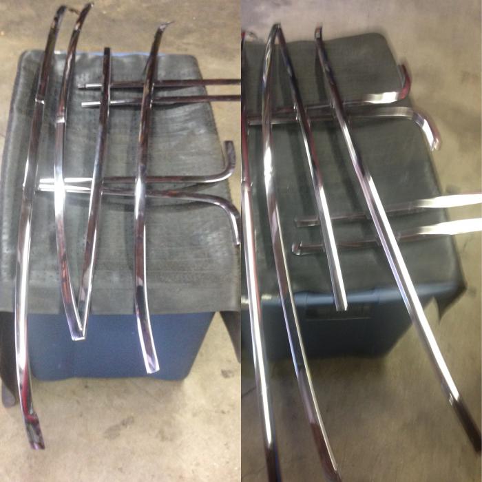

Spent three weekends straightening sanding and polishing 51 year old stainless so I felt compelled to post a pic
I could have bought the repop rechromed aluminum but this to me is a better route ... takes much longer but feels so much better to me ... I want my car to be a mix of new technology and throwback style... Plus paying homage to the craftsmen of the past
And they wonder why it’s taken me 10 years lol
How did your chrome turn out and what did you polish it with?I plan on doing the same with mine.
Not to split hairs but the only chrome I have left on my car is the rear bumper and the wing windows .. I had those show chromed at an old school shop in Lawrence MA they use nickel came out amazing.
For the stainless I used a body hammer a mini anvil and small piece of hardwood for minor dings. Then wet dry sand paper 400 800 1000 1500 ... picked up a bunch of of cotton wheels and white and red metal polishing compounds
https://www.eastwood.com/eastwood-wh...SAAEgLsA_D_BwE
Then I used jewelers polish for the final finish... lots of work and still more to do but so worth it. Hope this helps

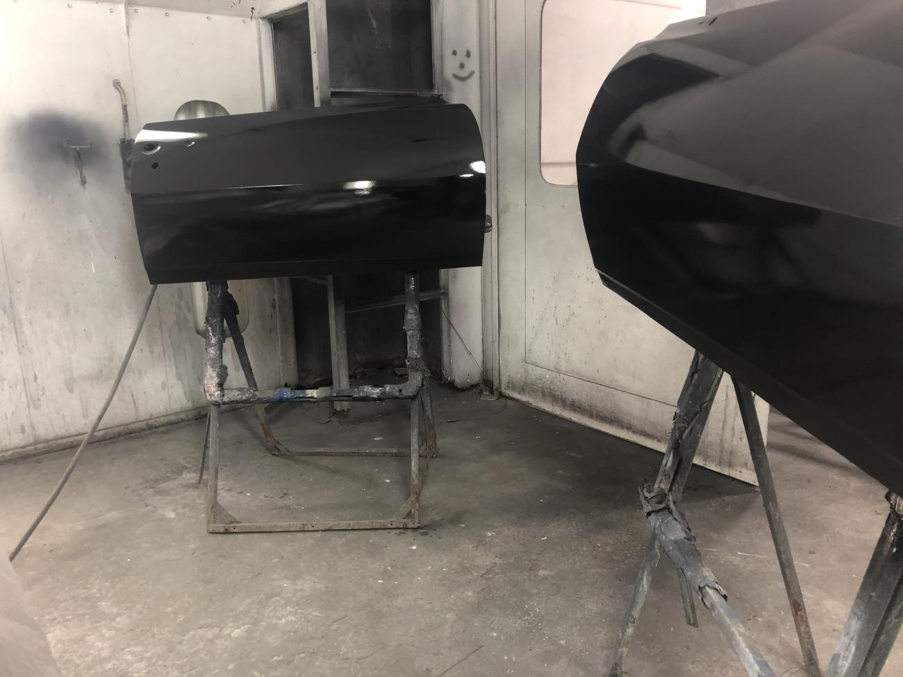

Default Color makes me smile
Its closing in on 2 years at the body shop.. small shop + Lots of work= it takes a long time for quality.. I am so psyched to see color getting laid down.
For the first time.. the end is in sight..
PS is Not black its Green 3 more color coats then 5 coats of clear to go ..

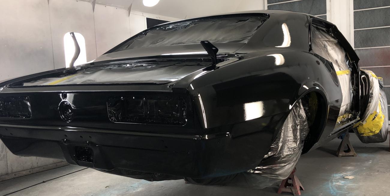

Default One more night
Car is in color and cleared baked over the holiday... sanding then another night of clear to go.. then assembly.. very excited..

Congrats on getting the paint done! I bet this is going to look great in the sun since it's so dark. Is that also a picture of all the flakes?
yes its a dark green metalic with lots of pearl and flake
