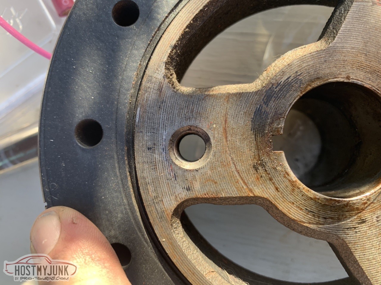

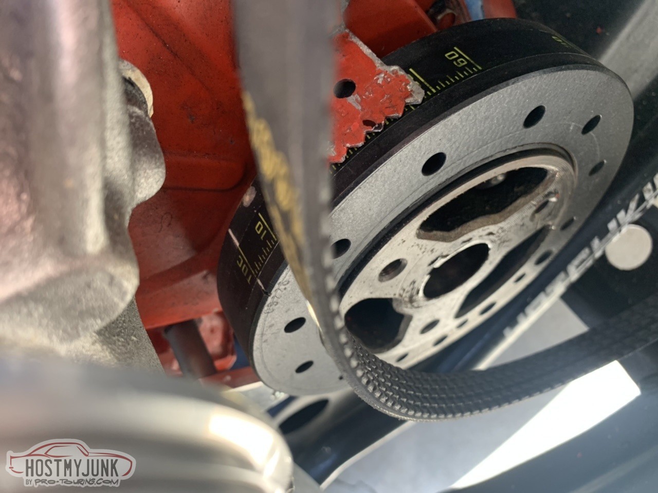

I went back and scanned some of the posts. I don't see where you've confirmed 100% your timing.
Do this with a piston stop, or at a minimum, pull your balancer bolt and check the orientation of your keyway with your timing mark. I needed to confirm TDC on my car recently. Here's mine and it was correct:

I verified TDC with a piston stop a few months back (must have forgotten to mention that in my posts). I check/verified the crank keyway was good when I installed the new balancer over the winter.
