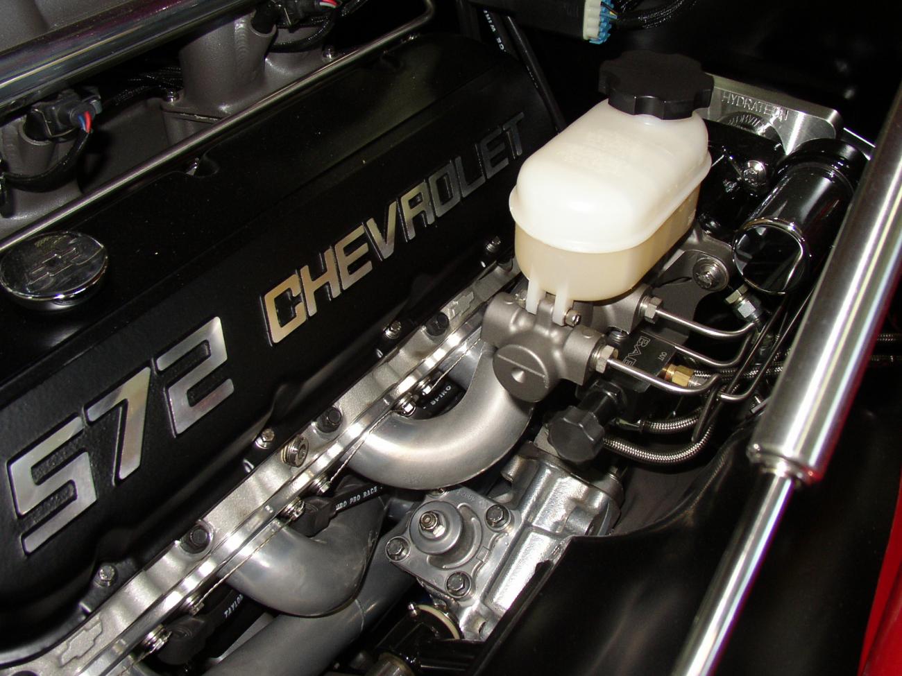

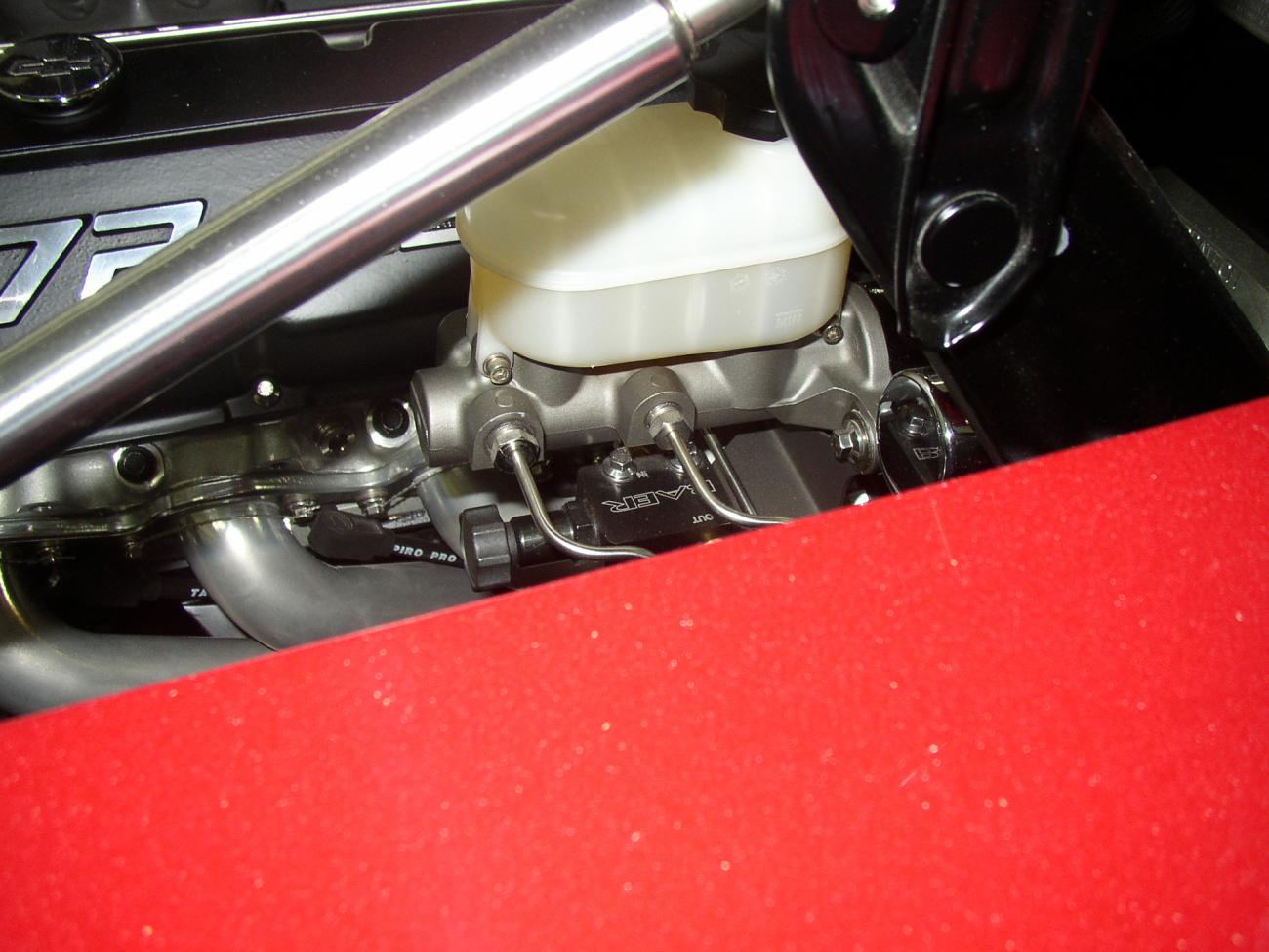

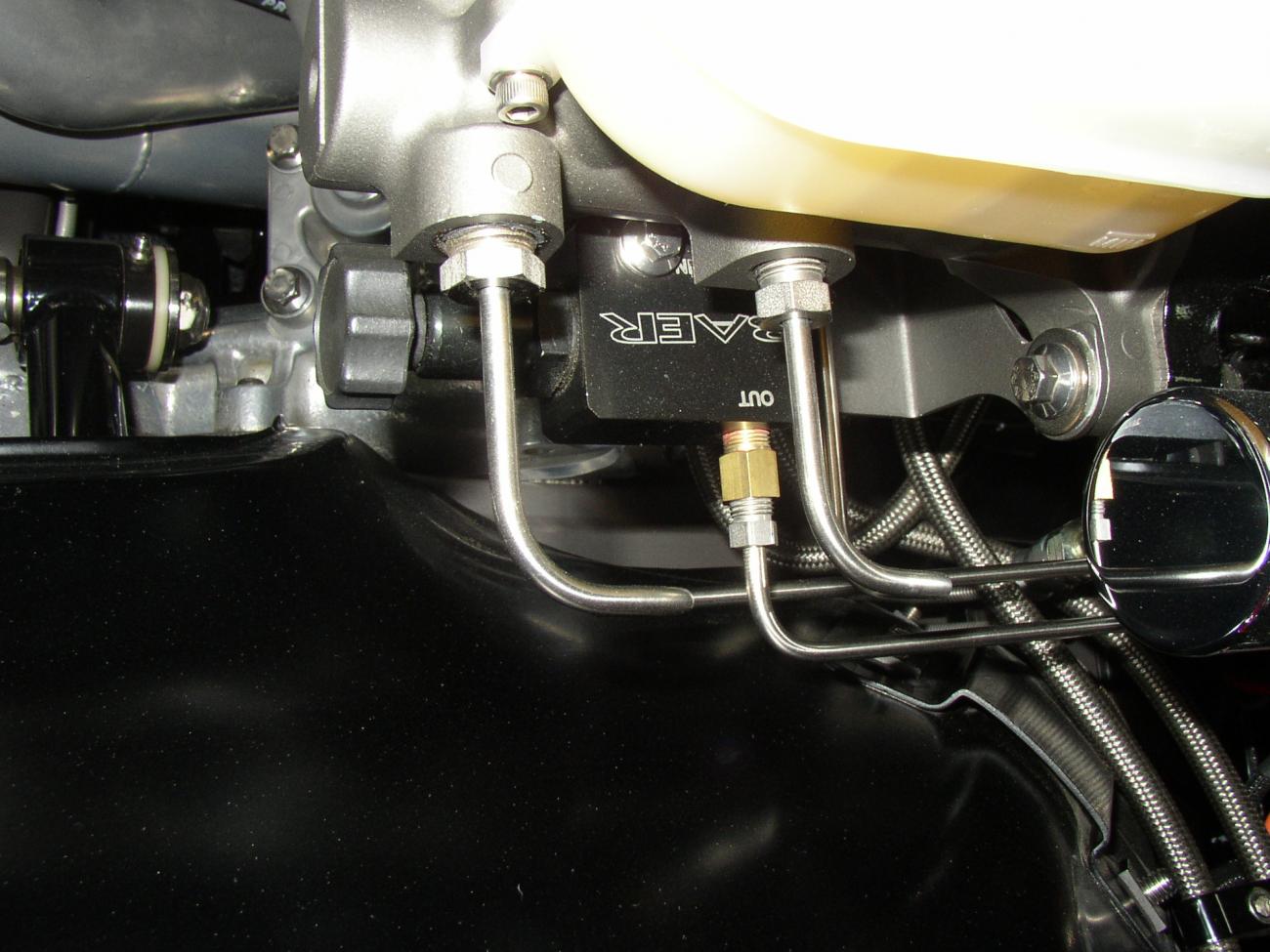

Hey Ron,
Sometimes it's tough to trust a stranger when it comes to BRAKES.
I just came back from the shop with four pics to give you a visual so you can gain faith in what I have shared.
Here goes..,
