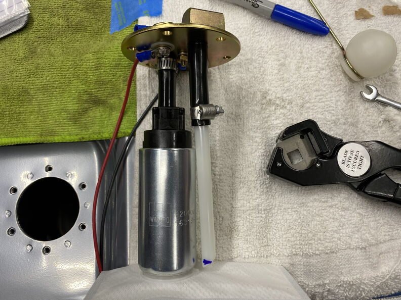

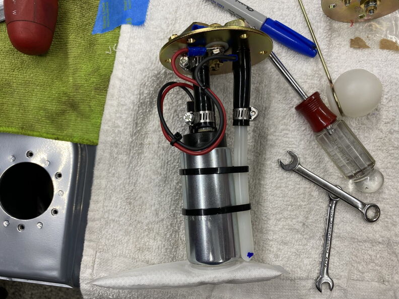

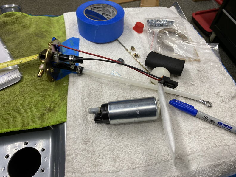

Default Holley EFI Tank (( 09-17-20 ))

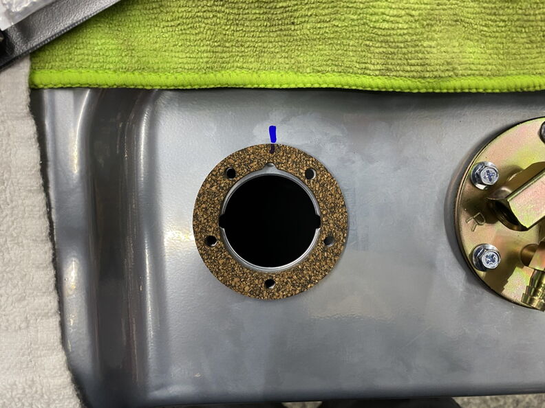

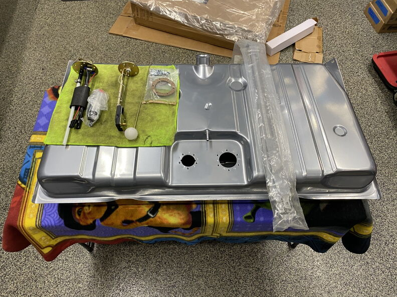

It's time to put the tank together and it was a very nice day to be out in the garage.

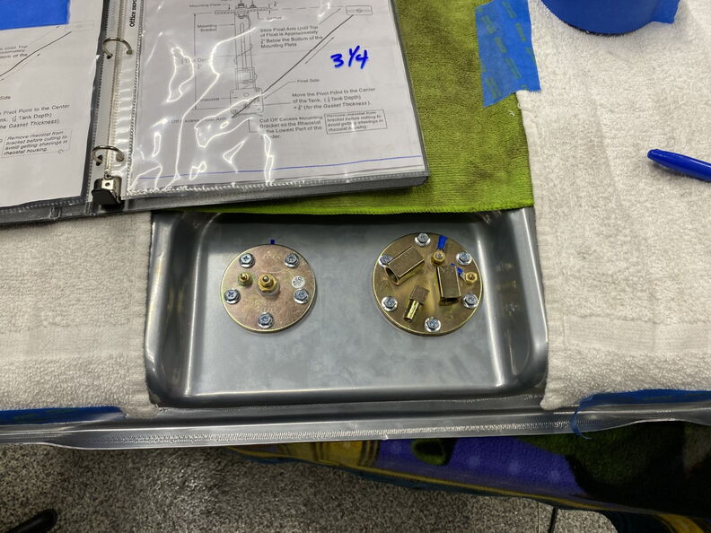

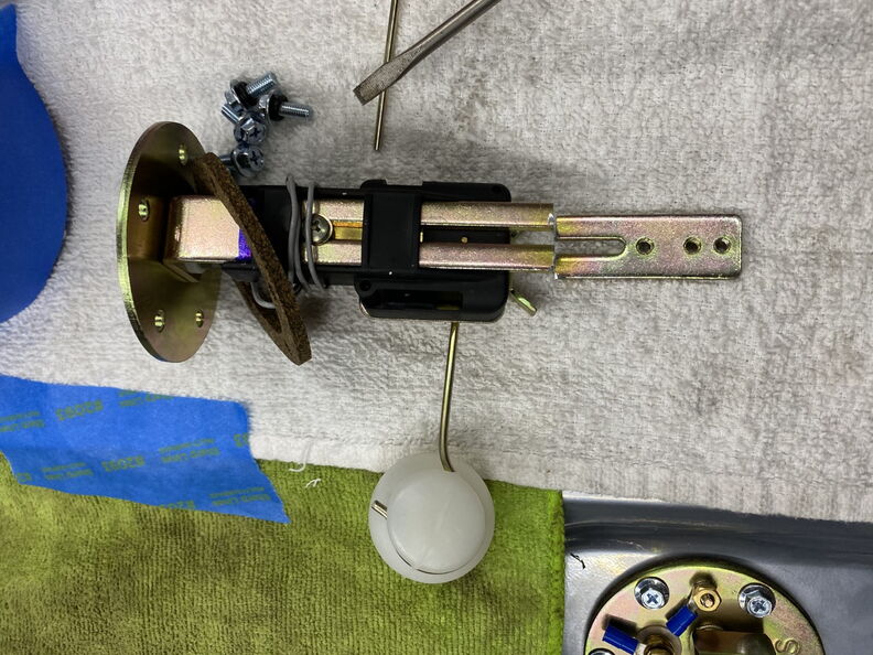

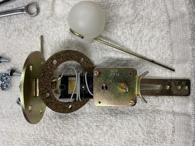

Pieces & Parts

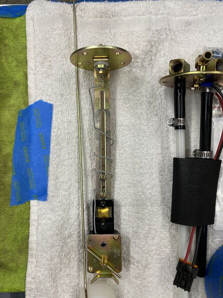

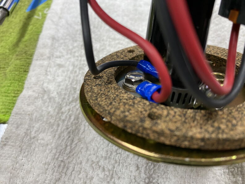

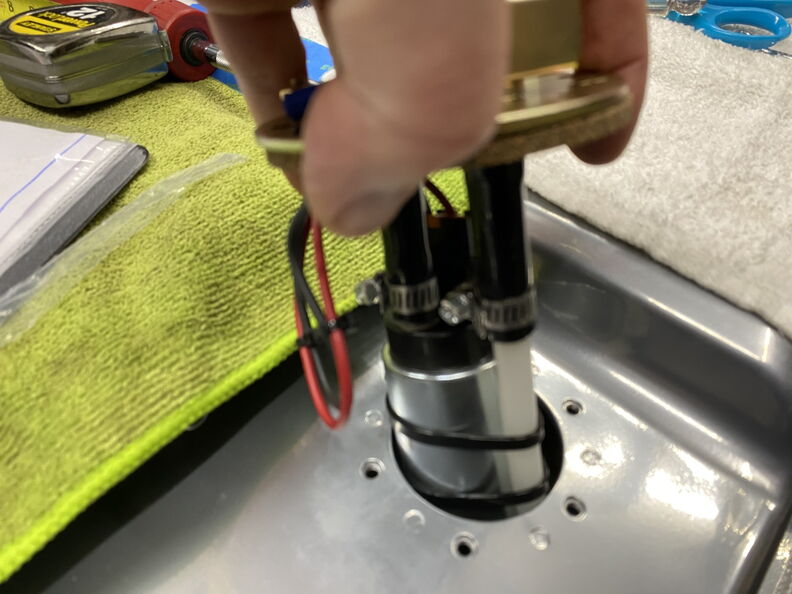

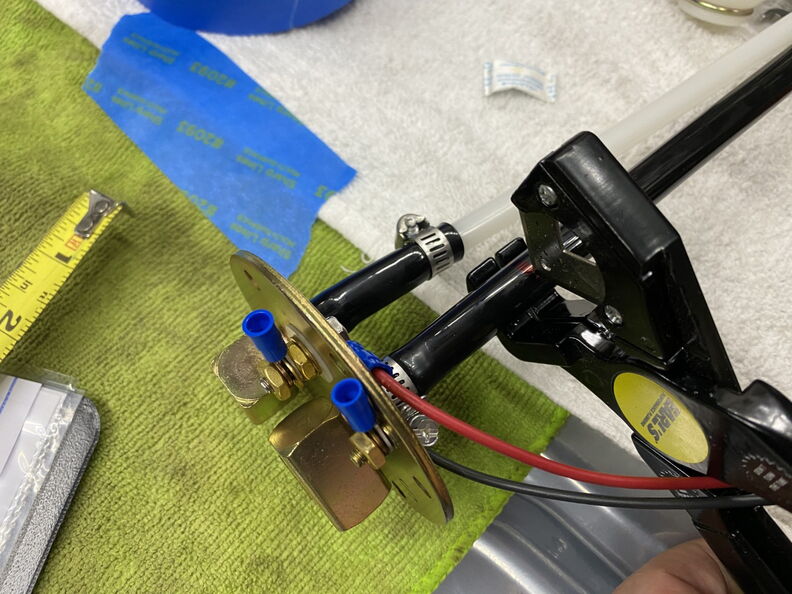

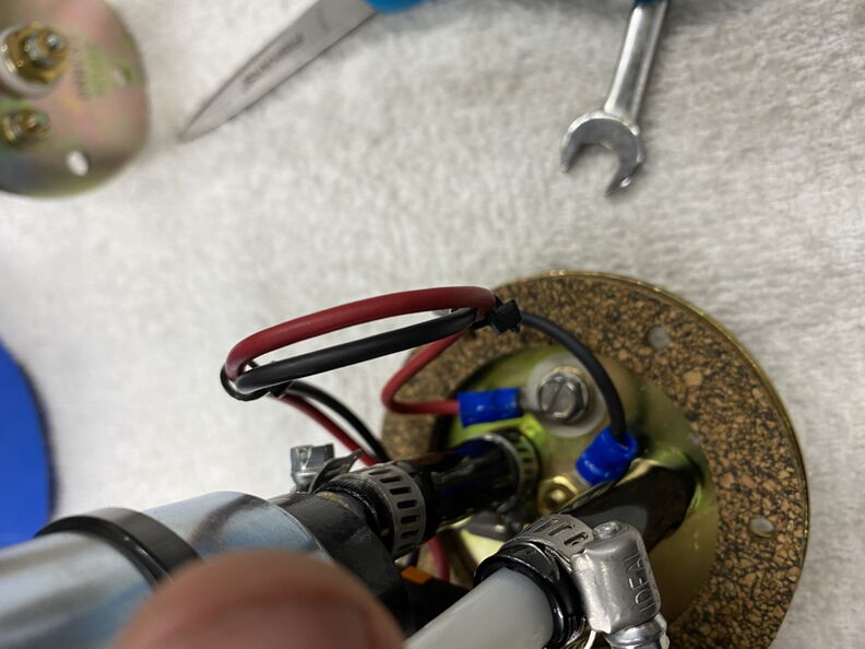

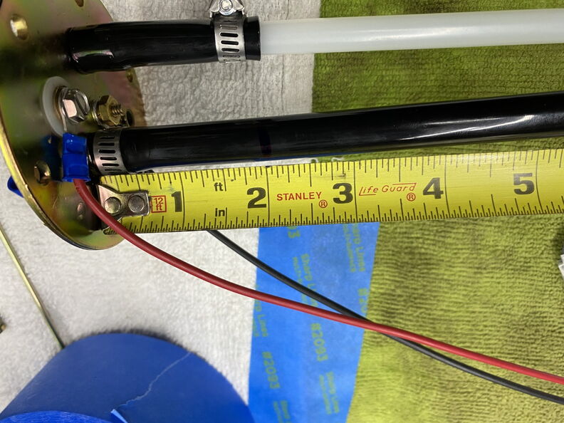

Time to build the the fuel pump/fuel level assembly.
You may have to move the wires over a little bit so make sure you look.

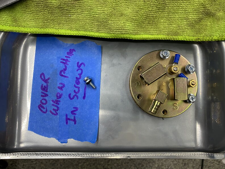

Very important note here. Make sure you cover the hole for the float because if it can happen it will happen.
Just in case you wanted to know yes I dropped a bolt inside the tank. Ugh !!!
The float assembly ready to drop in after it was modified per the instructions.
Remove the excess off the bottom.

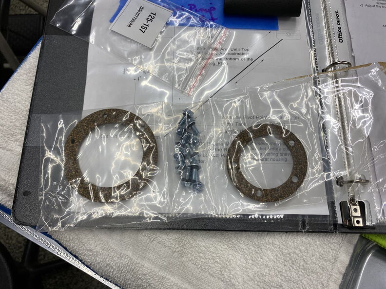

Make sure you line up the gasket correctly.
Call your daughter and ask her to help you pack it up and put it back in the box.

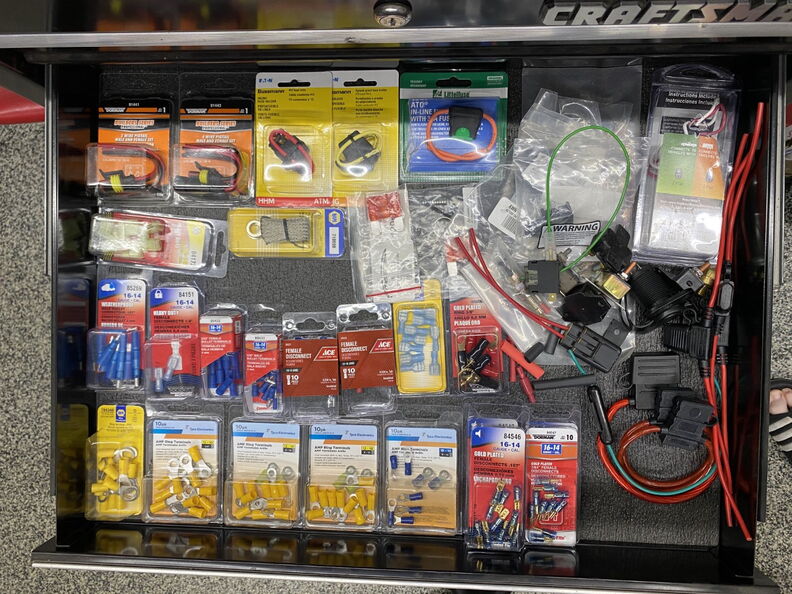

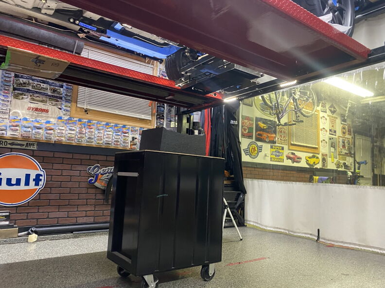

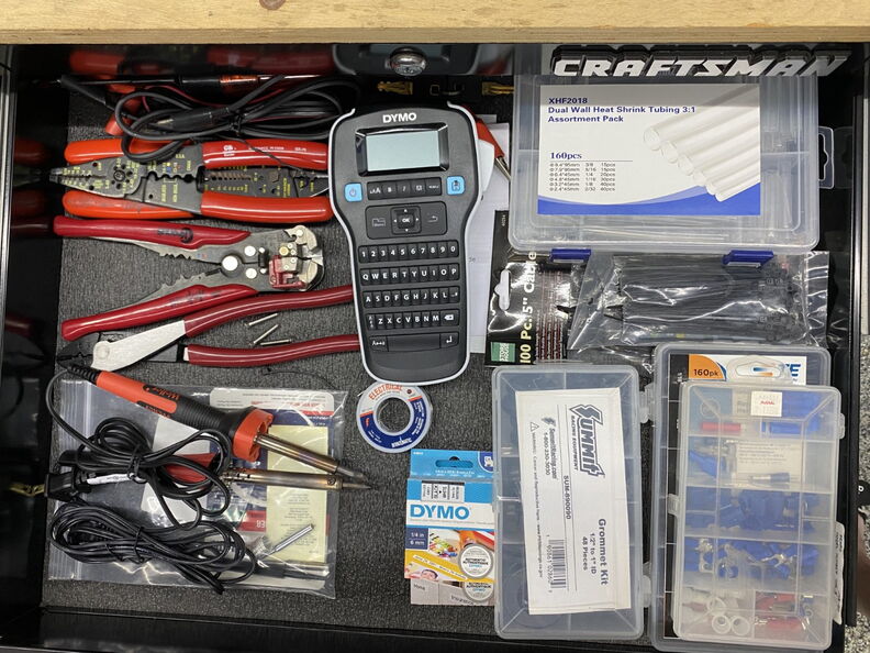

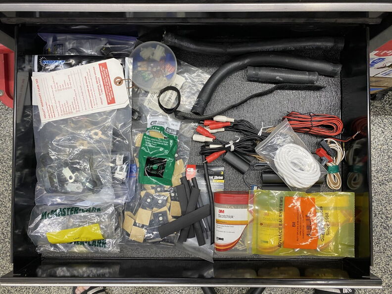

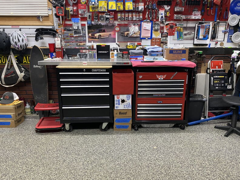

Default A Wiring Specific Tool Box (( 09-19-20 ))

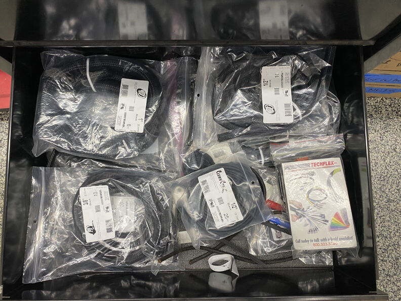

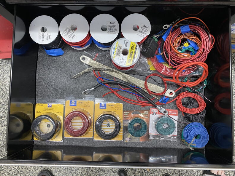

Since I will be planning and running the wiring in the car it is time to put everything wiring in it's own tool box. So years ago I bought two of these toolboxes from Sears in a close out sale for $60.00 each assembled. They have been sitting in my warehouse for years and I have finally found the perfect use for one of them.
Trust me fitting up this folding shelf was not planned and the fact that it was a relief.
All of this is going to find a proper home.
marty-mj

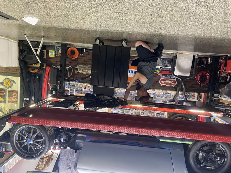

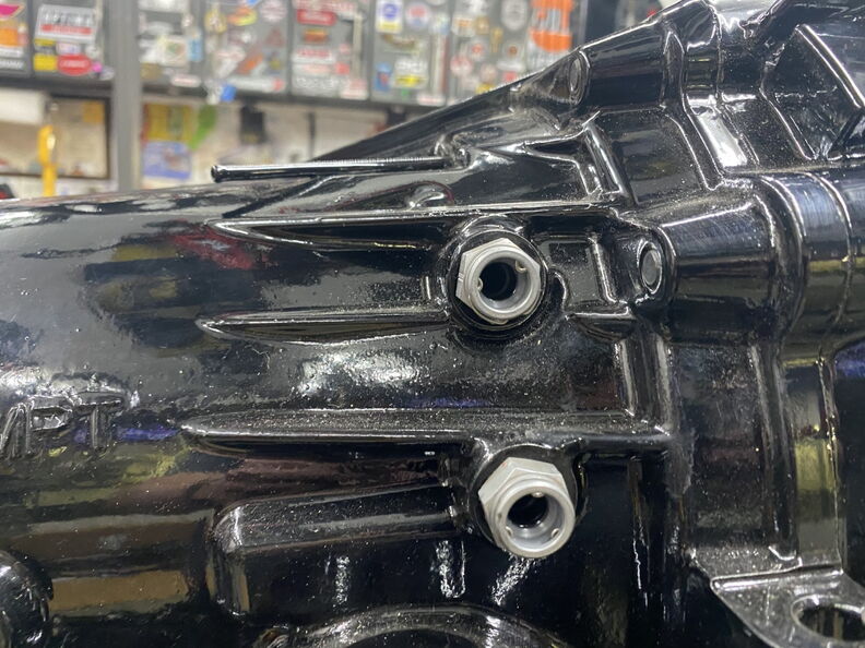

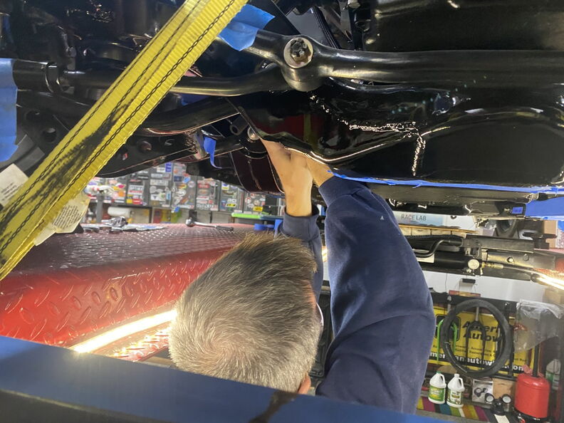

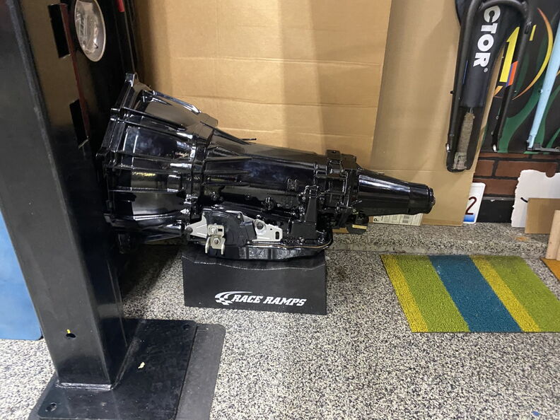

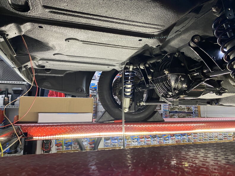

Default Removing the Atomic 4L60E Transmission (( 09-19-20 ))

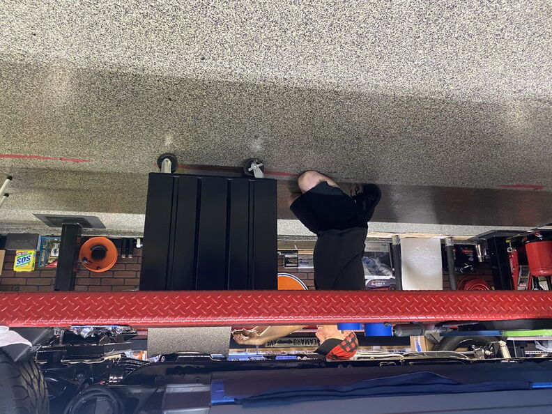

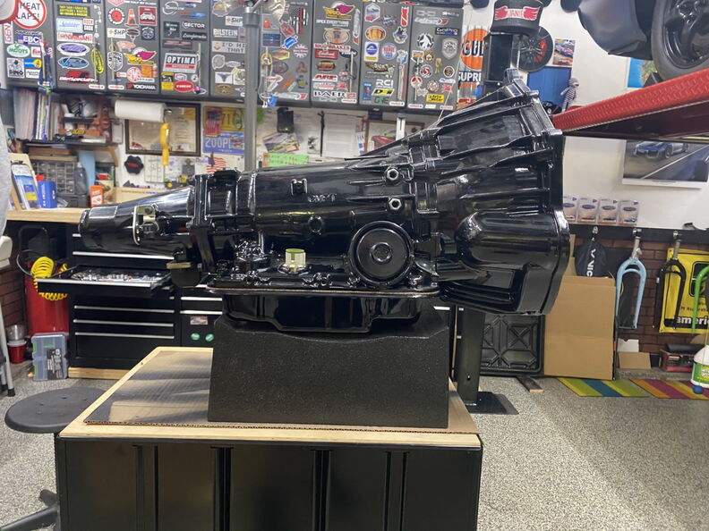

Now that I know how the trans fits and the fact that I will need to redo the trans crossmember. I am going to remove the trans so I can install
the fitting for the trans cooler lines. Plus it will open up the are under the car so I can get some work completed under the car.
I will be replacing these fittings so I can use the Holley PFT line with AN fittings
Good thing Mike was over to help.
Don't be afraid we have a plan...
Oddly enough I couldn't convince Mike to be under the rack while I lowered it down.
Perfection !!!
Opps
See you in a couple months.
marty-mj

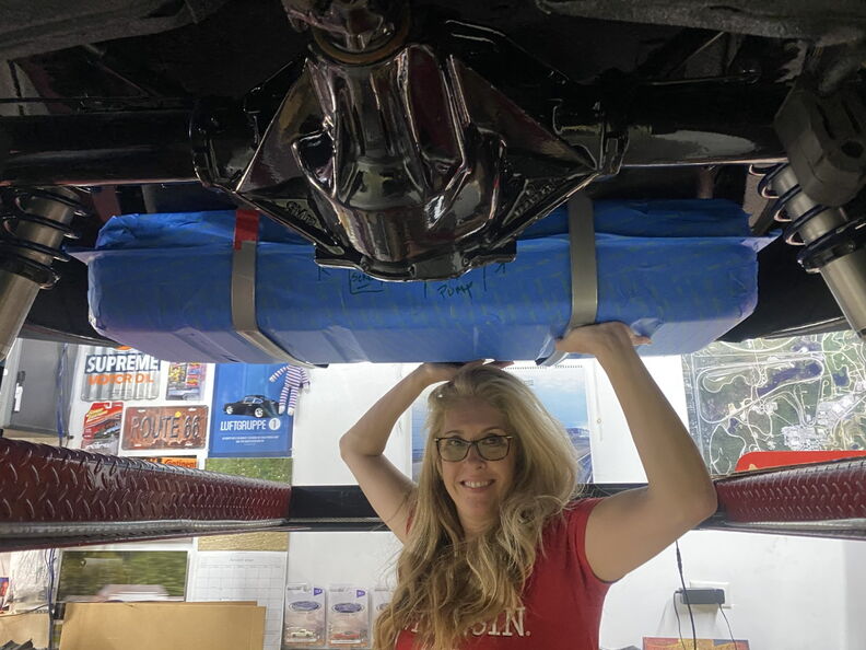

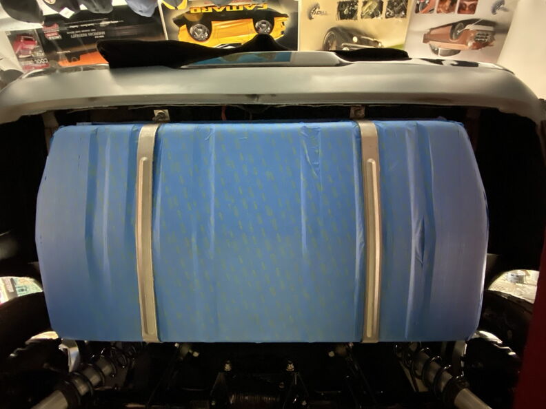

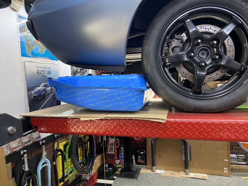

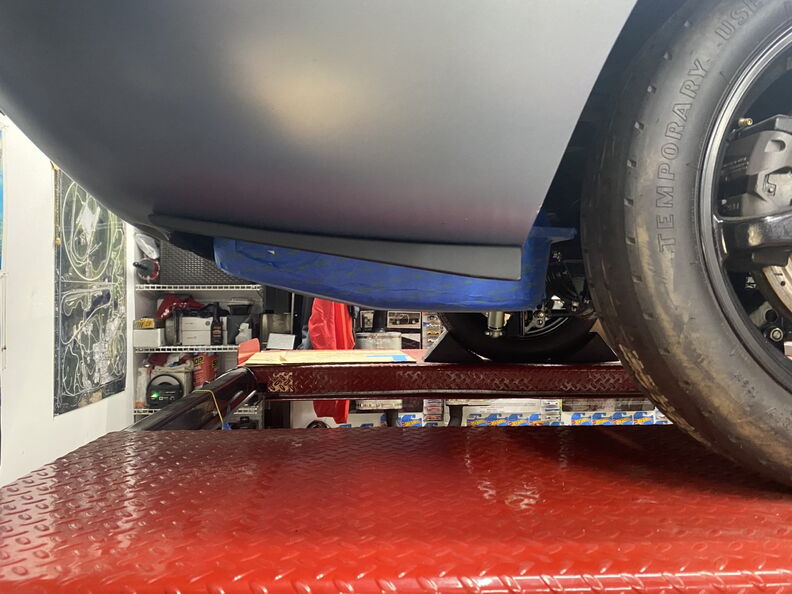

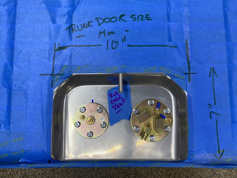

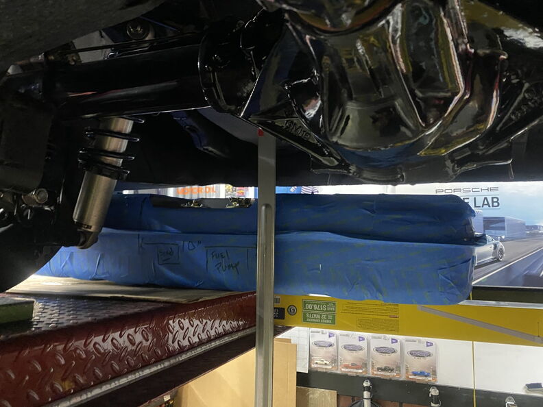

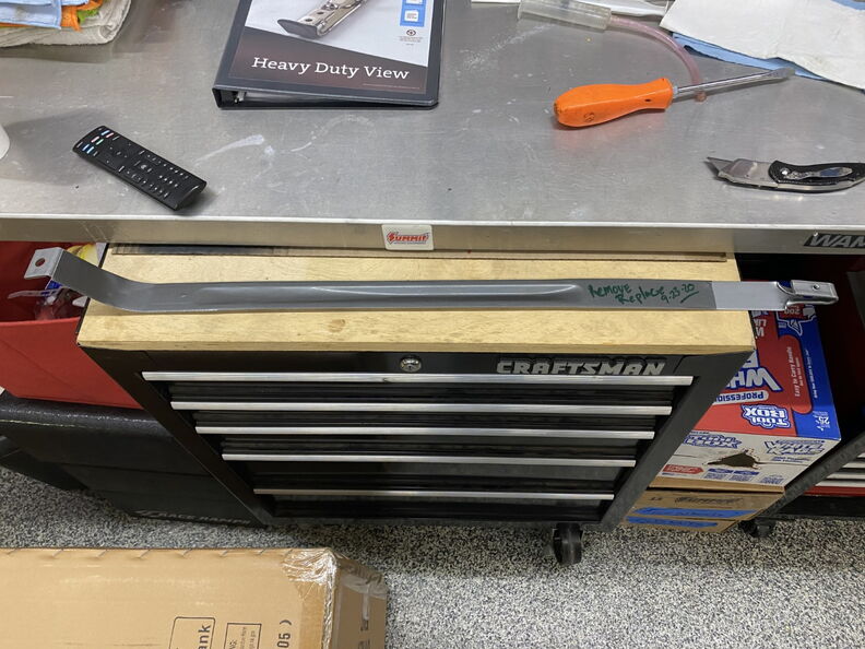

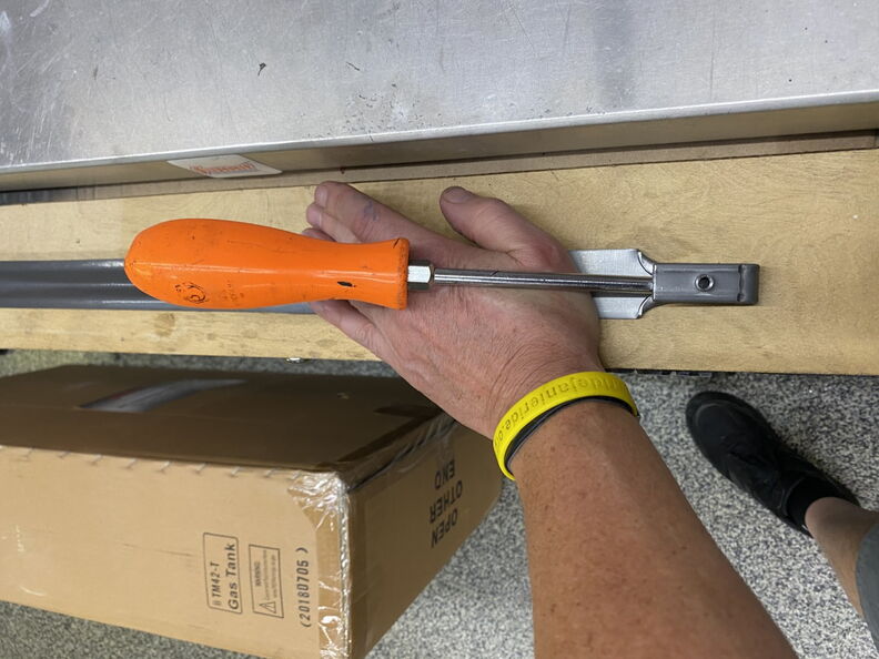

Default Installing the Holley EFI Tank (( 09-23-20 ))

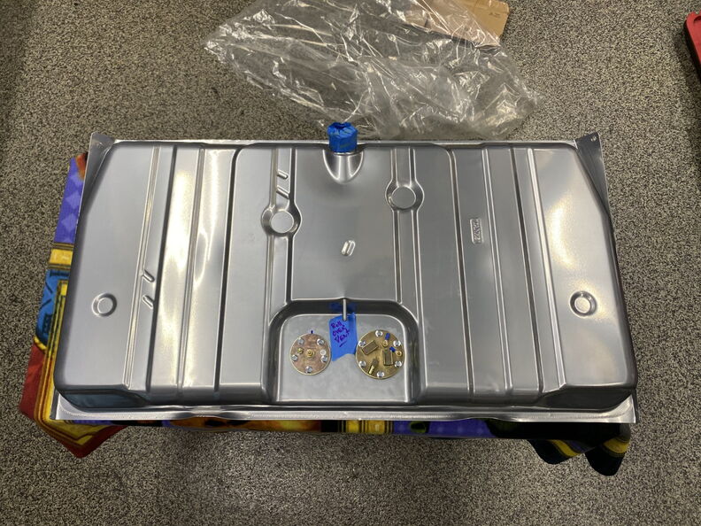

Looking forward finally installing the Holley EFI tank.
Since the rubber isolator strips were in my garage attic and there was some duct tape nearby. I taped the straps so I wouldn't scratch up the tank.
I needed to open up the end so I could hang the straps.
All taped up and ready to install.

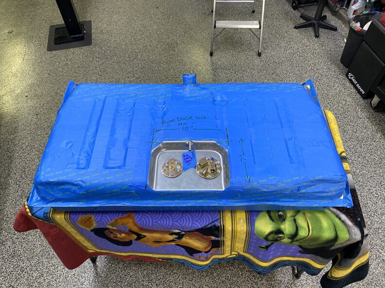

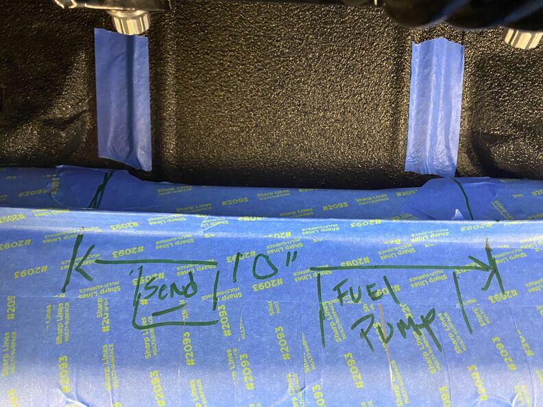

Since I plan to install an access door I took a few measurements so I could figure out where to cut the hole in the trunk floor.
This does not look like it is going to be fun to do by myself.
Time to call for back up.
marty-mj

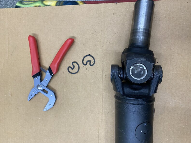

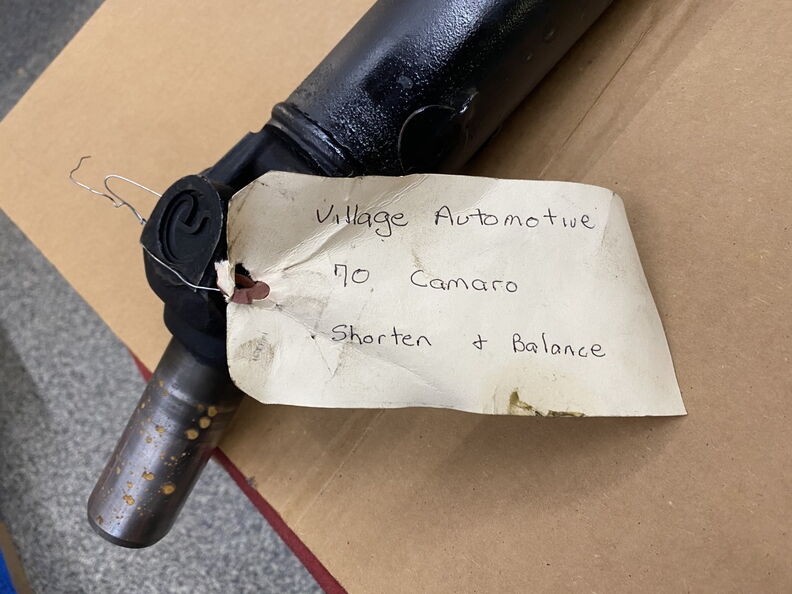

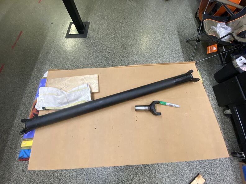

Default Driveshaft - Village Auto (( 09-27-20 ))

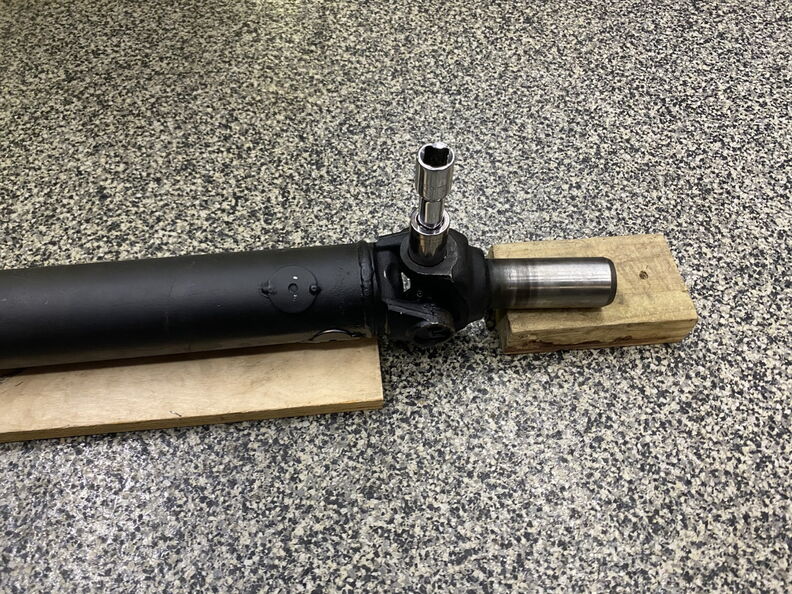

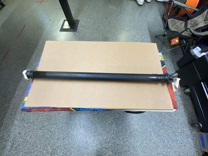

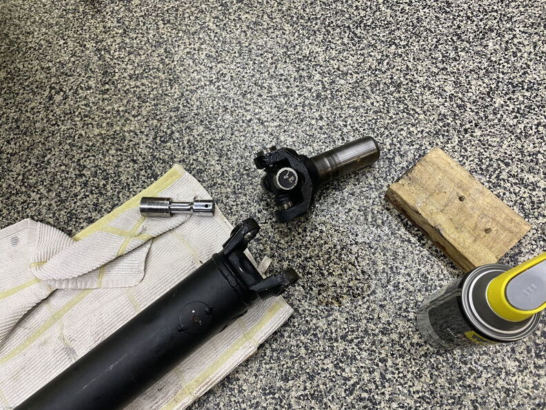

Don from Village Auto stopped by and measured up my driveshaft for me.
It was shortened and balance and now it's off to the Powder Coater.
Just need to take it apart first.
Off we go to Pro-Tek Powder Coating so I might as well bring more parts.
Still can't find Chunky Bars so I found a substitute.
marty-mj

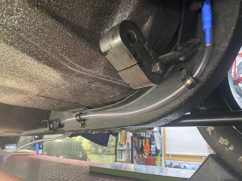

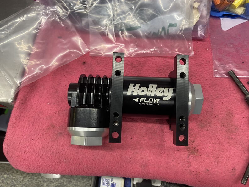

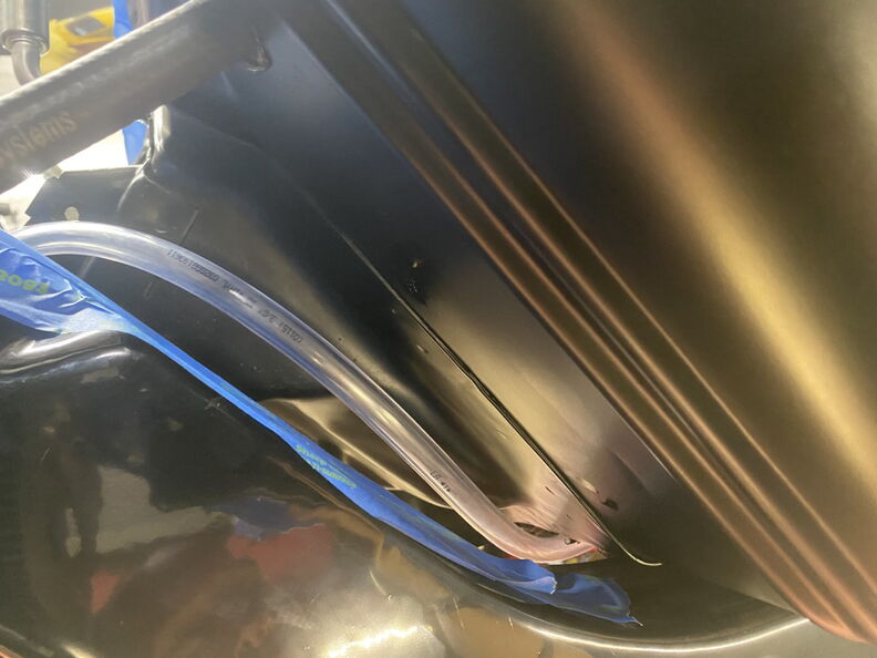

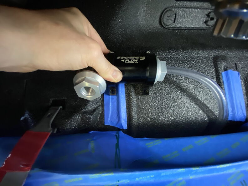

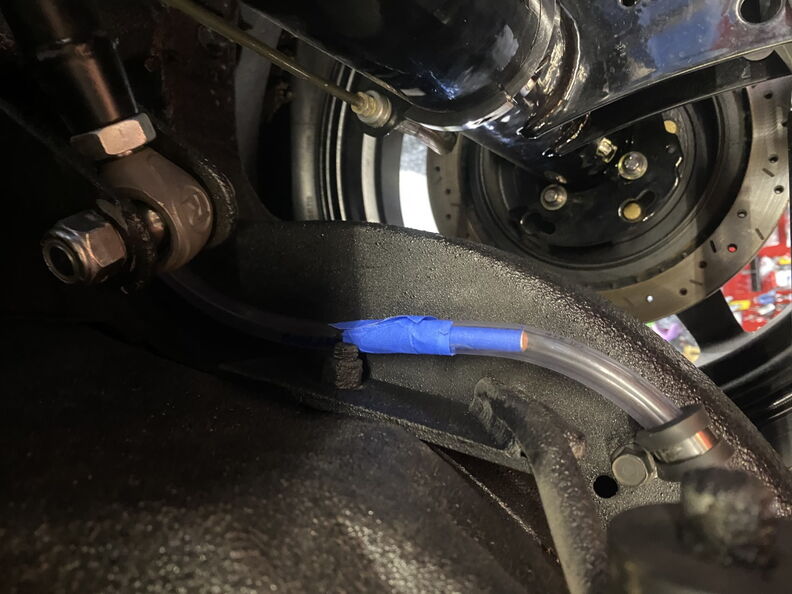

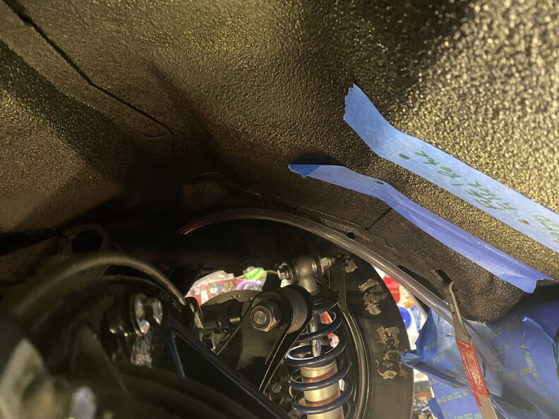

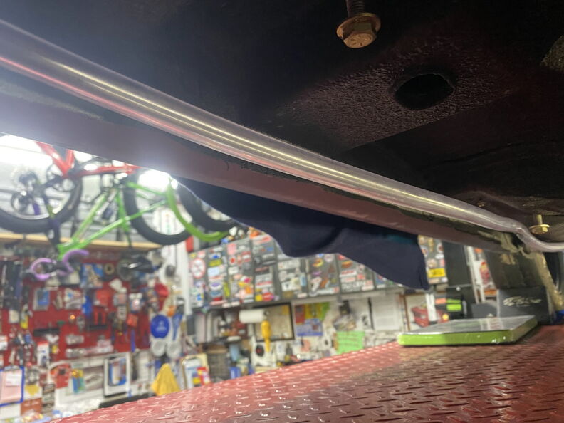

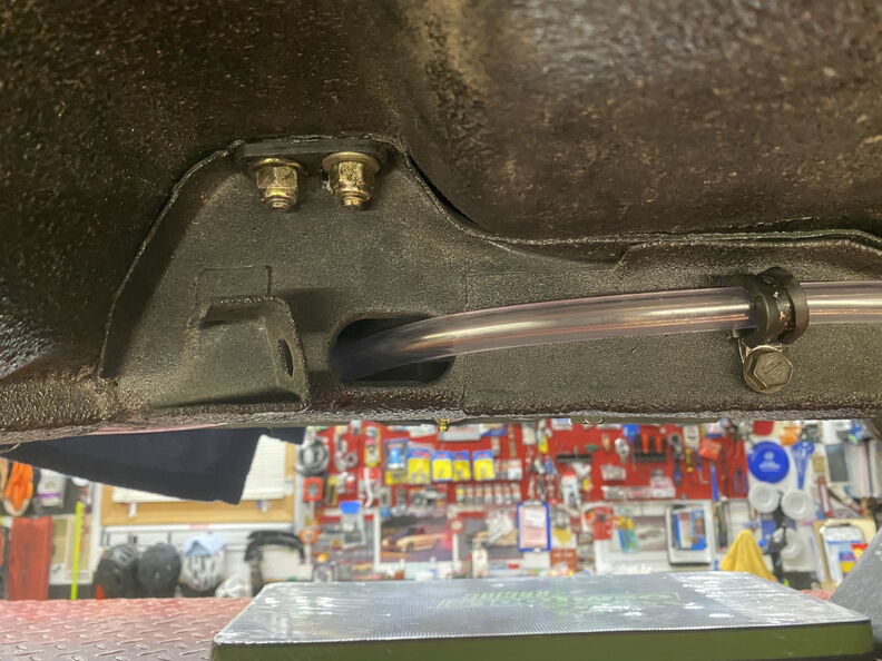

Default Mocking Up the Holley Fuel Filter Regulator & Fuel Line (( 09-29-20 ))

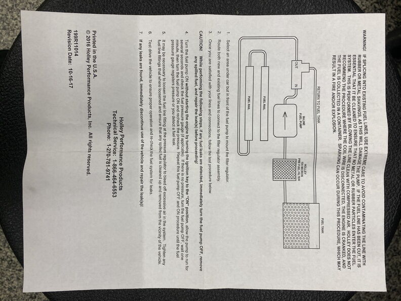

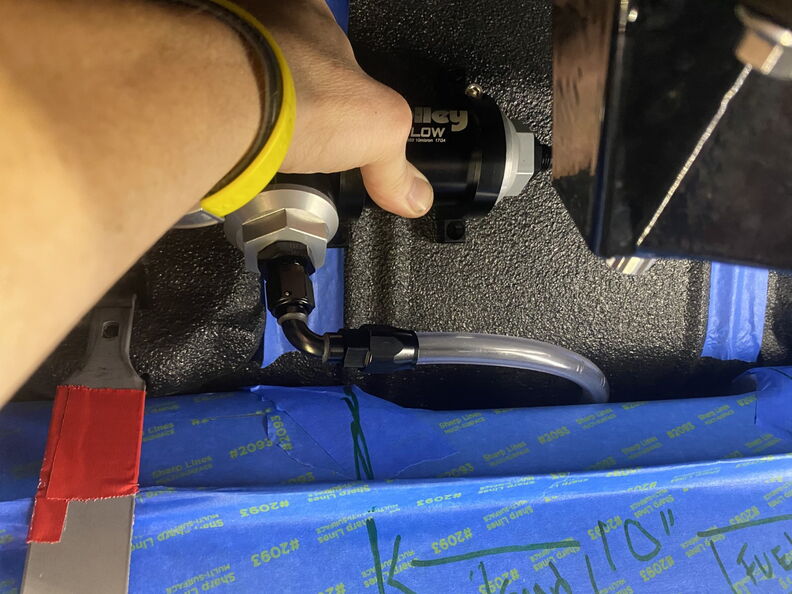

The plan here is to find a suitable location for the Holley Fuel Filter Regulator.
I plan to use this clear hose for mock up as it is roughly the same size as the -6 PFT line.
This looks like a possible location.
Time to drill a few holes.
Mocking up the fuel line.
marty-mj

Hey Marty,
You’re a busy man! Love the write-up, all of the detail, your organization and attention to detail (and nice find on the tool boxes, they work perfectly for all you wiring materials). Does the Holley EFI tank use one of their hydromats for fuel pickup? If not, is it baffled to avoid fuel starvation? I used a Rick’s Resto-mod tank in my Chevy II, which has corner pick ups, though they say they really aren’t necessary with the OEM fuel modules used in those ranks. Thanks,
Brian

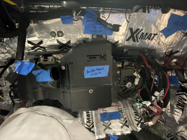

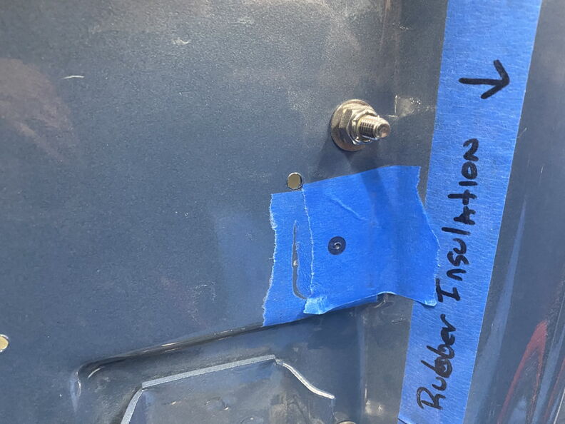

Well it looks like I am going to do some testing with a hair dryer. Not sure how much of and issue it will be on the inside of the car. More worried about the stuff in the inner fender.
Edit
I did use a heat gun to shrink the heat shrink tubing. What’s your thoughts ??
I used a heat gun on some shrink tubing nearby. If your labels survived the initial tubing shrink, you're probably good.

Marty, you might want to use some Permatex Aviation sealer with the cork gaskets. Napa usually has it in stock.
Andrew

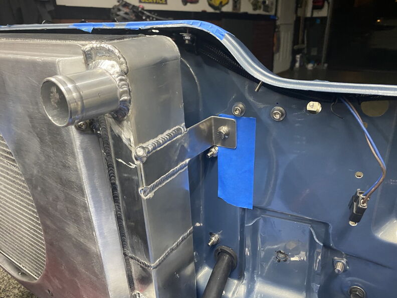

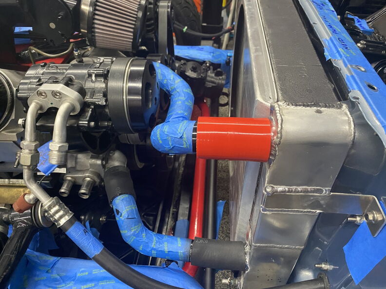

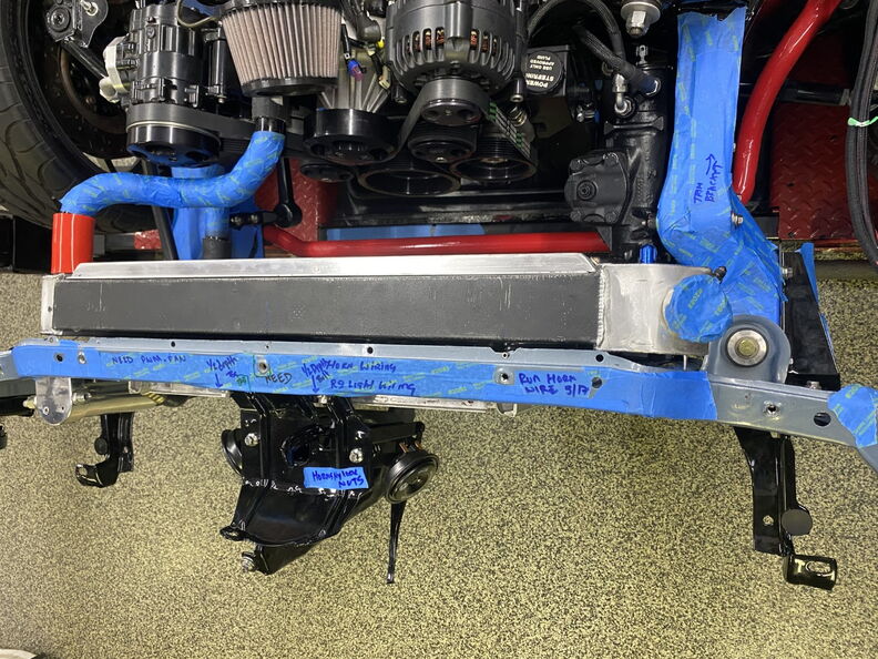

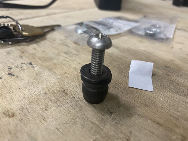

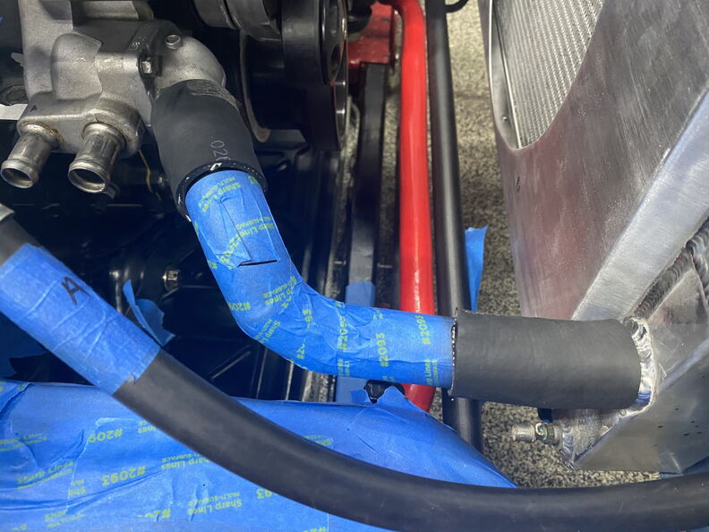

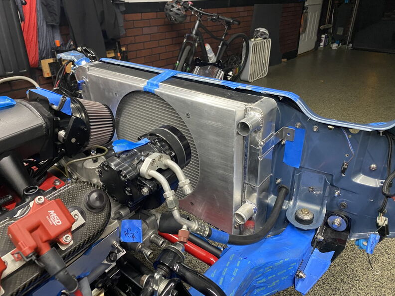

Now that the Afco "Direct Fit" Radiator is home and modified so it will work I might as well test fit it.
Cutting up some cheap radiator hose to make make sure I order the correct size hoses.
Next up...drill holes in the Core Support.
Eventually I will drill the holes larger and install "Well Nuts"
Works perfect
Testing a 3" Hose that I borrowed from a friend
Perfect Gap.
Marty, I'm not sure you'd have enough room for the radiator to 'move' as it heats and cools down with the side to side mounts. You may need some wiggle room there so the radiator doesn't crack somewhere. Maybe take a look on a modern cars cooling system. There should be 'pins' on the radiator that go into usually large grommets. Just a thought.
