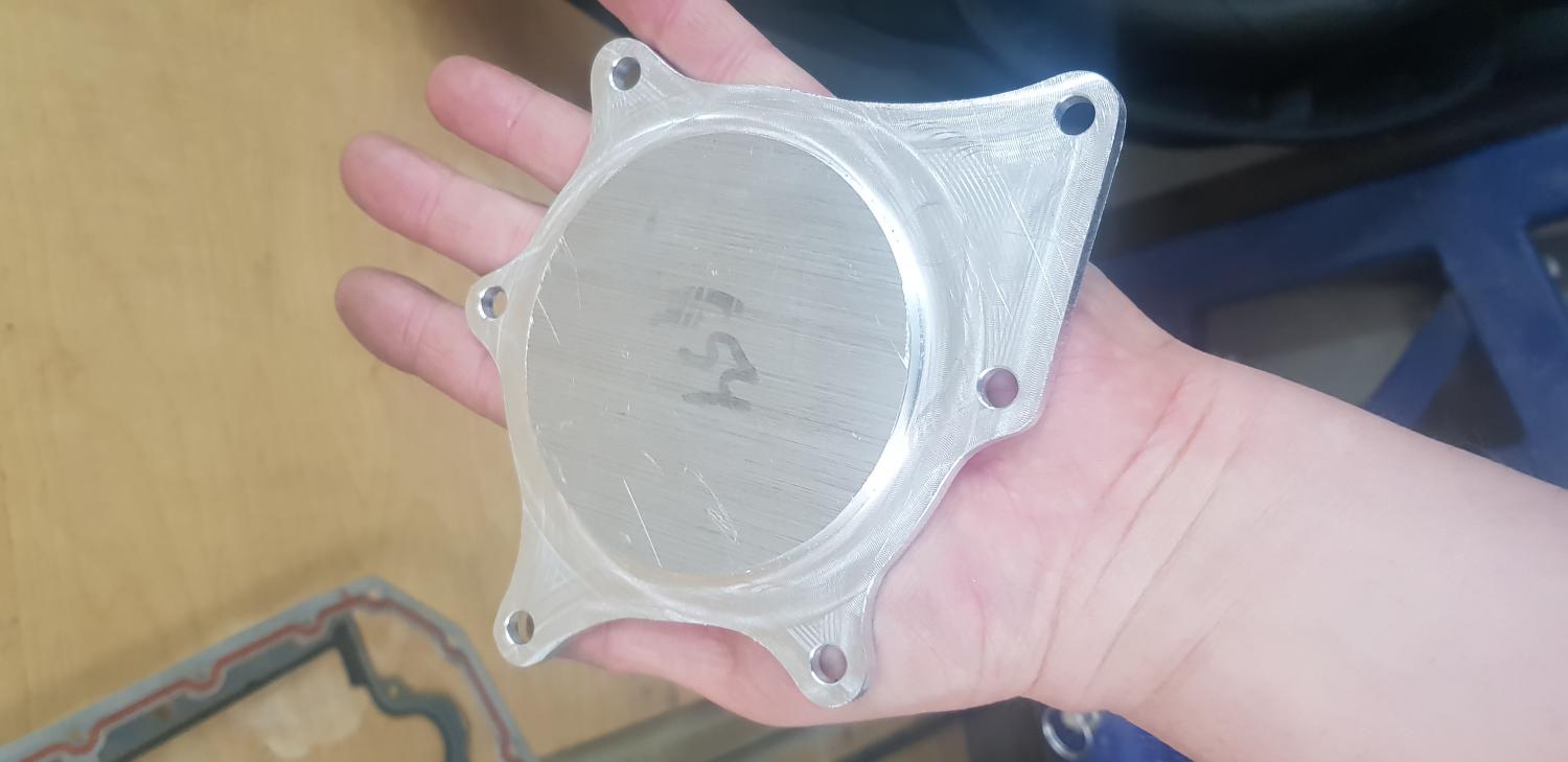

I'll tell how Im doing this, for another reaaons but kind of same thing.
I need to loose the stock water pump. Dont have room for it. So I machined boltable blocking plate and I will machine "tower" for guide pulley to be bolted, welded or threaded when I know where and how long. So I can play with belt rounting.
Running BMW Piesrburg electric pwm pump.
, Juhani

Again easy with LS, aftermarket support is huge.
Try to build something out of Viper engine.
Had to make it yourself.. still need to countersink all the bolts.

Totally agree, good job!
