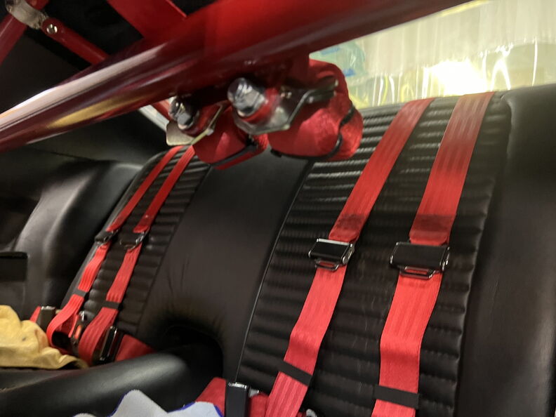

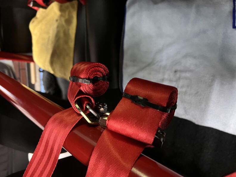

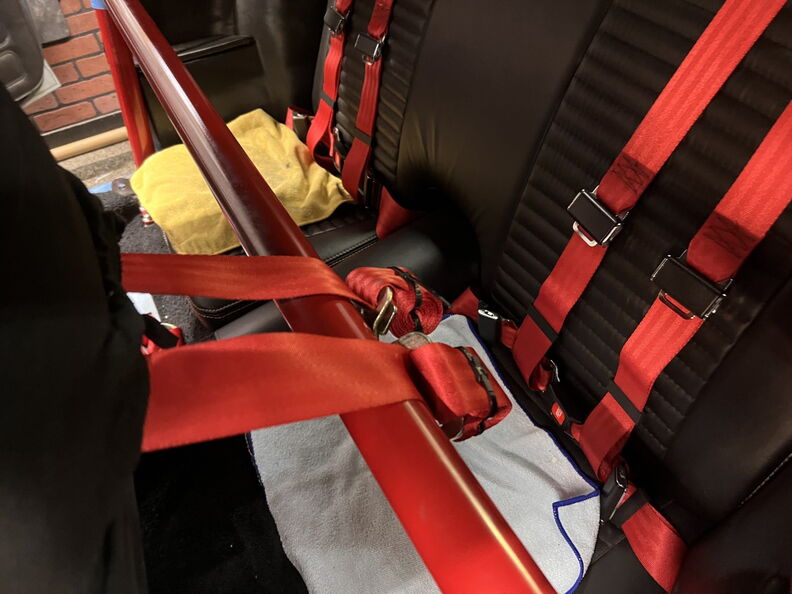

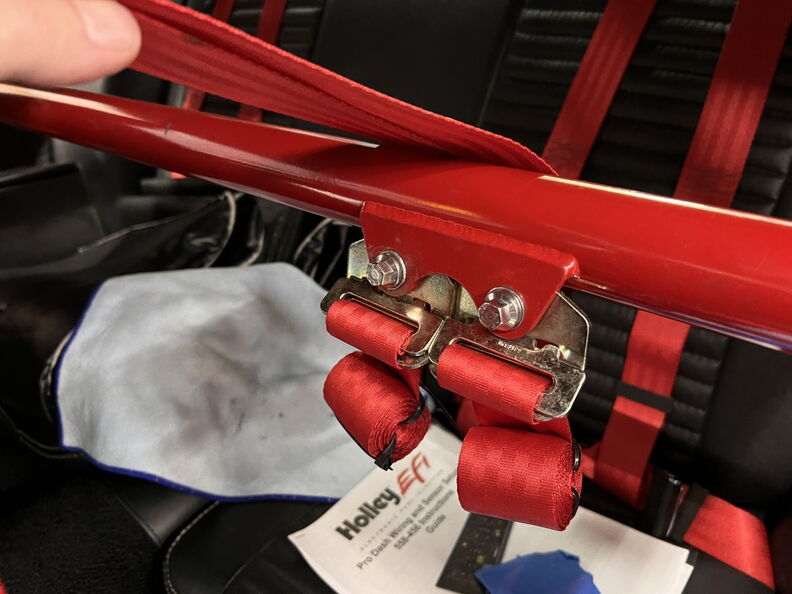

Hi Donny,
All of the bolts are tight and the brackets can't swivel. However, since the brackets are so close together I need to put a
washer behind one of them so the brackets can be flat. In the rare occasion that I have a passenger in the back seat I was
worried about them bumping the bracket. On a side note you will have to be one hell of a contortionist to get back there.
Here is a side shot of what it looks like and I am open to your advice as I this is all new to me.
Thanks for the side pic. That is all wrong and it will never be perfect but it can be better.
Turn the harness bar around so the welded tabs are on the back side but still pointed down. Then bolt the harnesses on the back side. I would consider bolting them on with the angle going forward even, assuming it will fit that way.
Side bar. Nobody you like should be sitting in that back seat with that harness bar there.
Donny

Morning Donny,
I will flip it around this weekend and thank you for catching this I really appreciate it.
ps I looked back at old pictures and it was on the way you explained.
