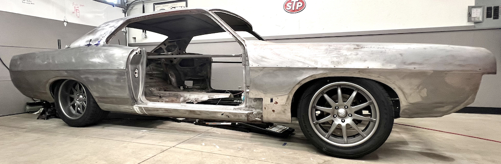

Hey everyone,
Is there a rule loosely followed when sizing tires rear versus front diameter difference?
Looking to buy tires in the next couple of weeks and would like a 295/40-18 for the back and 245 or 255/40-18 for the front.
So i am looking at 27.3 for the back vs 25.7-26.0 for the front.
Thanks
joe

I don't know about any rule, but mine usually end up 1/2" to 1" taller in the rear than the front. No issues.

Thanks Jody
Ya "rule" was a weird way to put it
Ended up ordering Nitto NT555 G2
255/45-18
295/40-18
My tape measure, calculator, and back got a workout on the concrete over the last three days

It depends on the vehicle and the look you're going for really, Joe. Way too many variables involved to provide any guidance other than make sure it goes with the look you're after. Never go smaller diameter in the rear is the only rule I would say.

I always look at the different heights of the fender cut outs. On most cars and trucks the front wheel opening is taller in the front than in the rear. If you lower it and give it the ole muscle car rake, a 1" taller rear usually looks the best in my opinion but, it all depends on the vehicle. Some times you may need to go taller than 1" in the rear to fill the fender wells.
