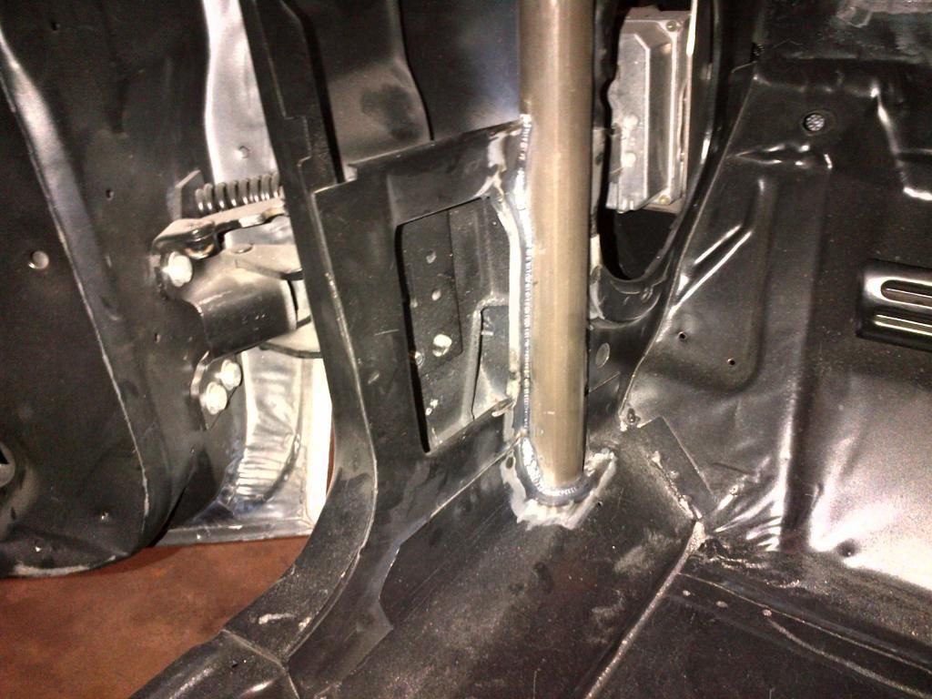

A couple more shots from my crappy Blackberry.
To package the air cleaner was a bit of a task. Having all the inlet air come from the grill and sealed from the underhood air is worth a lot in power and drivability.
We tried something new for the front A-piler bars. We sunk them into the structure in the hinge piler to get more room for stuff under the dash and to keep them away from my ankels. Now I can have a dead pedal and keep the stock parking brake.
Matt also weled the bar to the dash on the pass through.

Looks great Mark. Sinking it into the hinge pillars has to add big time to the rigidity.

Looking good Mark! How much reinforcing do you do to the floor for your integrated crossmember? Do you have any pics? Thanks
