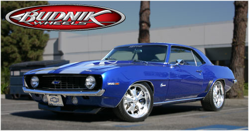

I'm going to agree with Frank at Prodigy and that 275/35/20 especially being you are running an 8.5" wheel. Anything wider then that, and it just won't work well on that rim width. Not only will it not look right, it's just not safe.
Here's a photo of my 69 with the same tire on an old Budnik 20x8.5. Tire is a Nitto.
