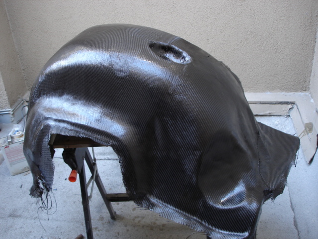

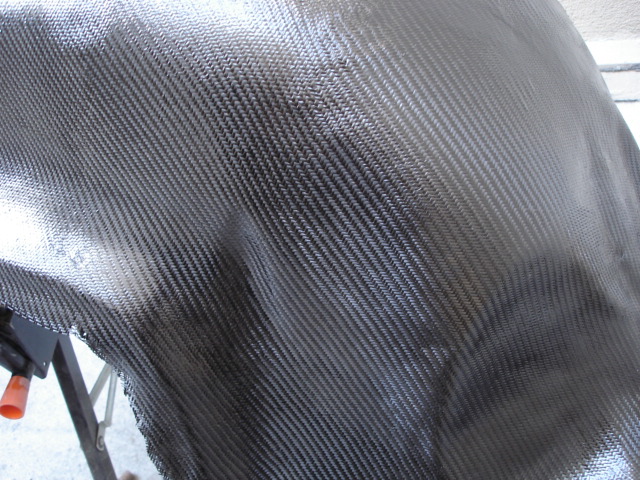

Started Laying Up The Carbon Fiber Parts Today. Looking Sweet.....

Pre-Preg and Vacuum Bagged? (Ceiba-Giegy)

I used some of the radiator structure with Nomex filler,wet lay up with a vacuum bag. No autoclave though. The fender wells and hood just wet lay up. The undertray I'll bag too so it won't rip off at 200.........
