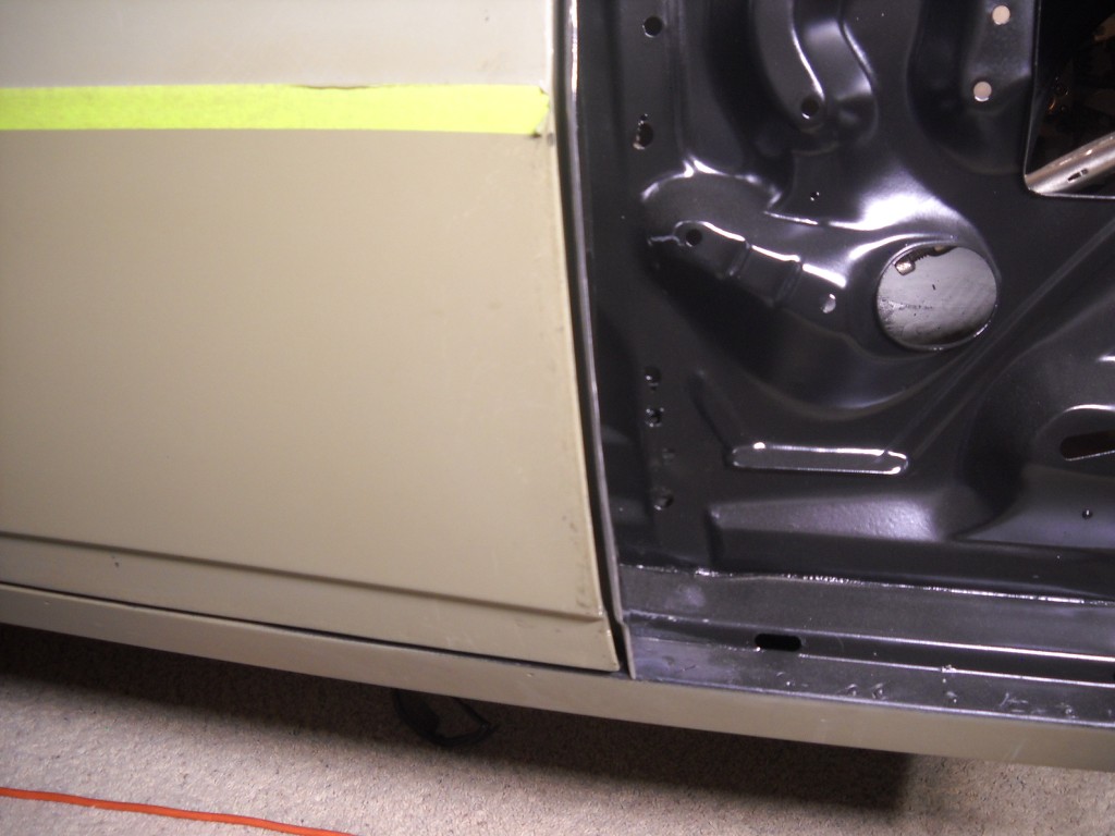

Smile Update 4/16
Cutting up some more of the AMD quarter panel ... trying to get the door gaps better than a 1/2 inch!!! Figured it was easier to metal work the angles of the door jamb that were rounded with the quarter off, and no tension on the panel ... yeah I'm backwards thinking too! Got it to 3/16" metal working the jamb area and I haven't used any gap spray yet
Now I'll put the quarter back on and see how much of gap I'll have to fill in with metal, I'm guessing 3/16" in most places .... been a good day in the garage!
