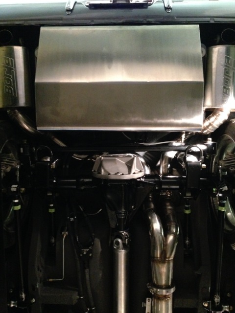

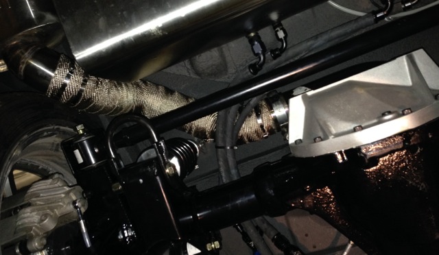

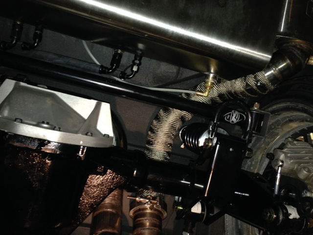

So i finally got the exhaust finished up After being mocked up i don't know how many times! Its complete stainless from the headers to the tailpipes and heat wrapped wherever its within 1 inch of touching anything! It was tricky fitting it around the DSE Quadralink suspension but having the trunk floor notched and fuel tank narrowed it turned out real nice! Ive got 3" header pipes crossing under the car and merging into the turbo and a 5" pipe coming off the turbo to a 5" braided flex then to a Borla Xr1 muffler ( mid car ) then I split the 5" pipe into two 3" pipes just before the diff. I managed to fit the 3" pipes in and around the suspension to the rear two Borla Xr1 mufflers on each side of the fuel tank. So even though it's a turbo car i really wanted that classic duel exhaust sound and look! Heres a few under car pics. ( sorry the pic qualities not so great! )

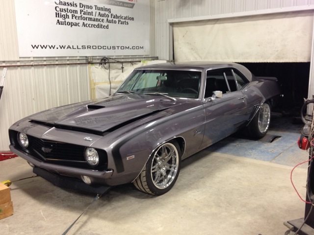

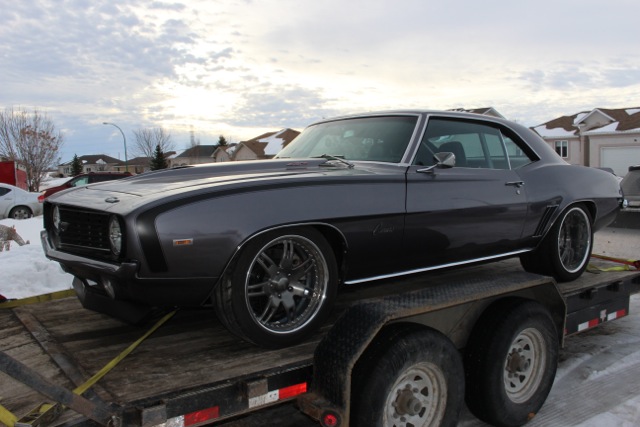

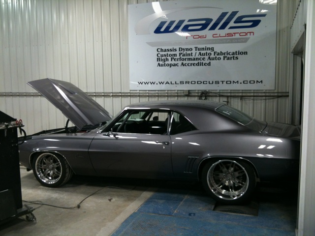

Well it was finally nice to get the car outside into some natural light! It was early and cold out but its was worth it as I'm taking it to "the shop" to get her up and running. If all goes well i will get some dyno time and hopefully get her dialed in with some base line RWHP #s
