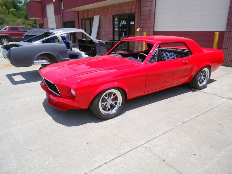

I took this Mustang in trade toward some of the labor on painting a 68 Shelby that belonged to a friend of mine a few years ago. Over the years I have changed my mind a lot on how I was going to build it. This is what I started with it had rust in the floor boards, trunk floor, bottom of quarters and doors.
The first thing we did was the rust repair and than I flared the fenders and quarters with steel. I left them attached at the bottom and spread them out 1 1/4" at the top.

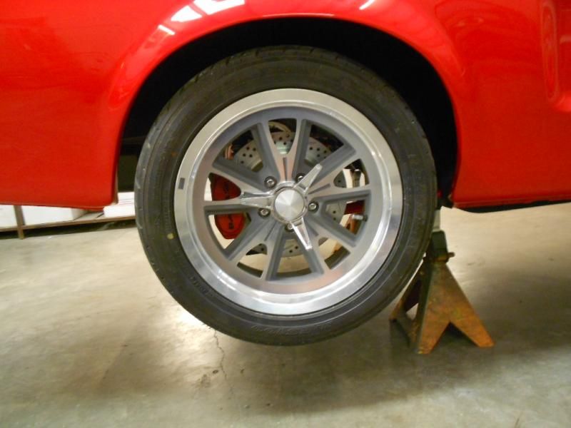

Since I have raced a big block FE since 1969 that is the only engine for my coupe. I have fought shock towers all those years so they had to go. I went with Rod & Custom coilovers with dropped spindles.
