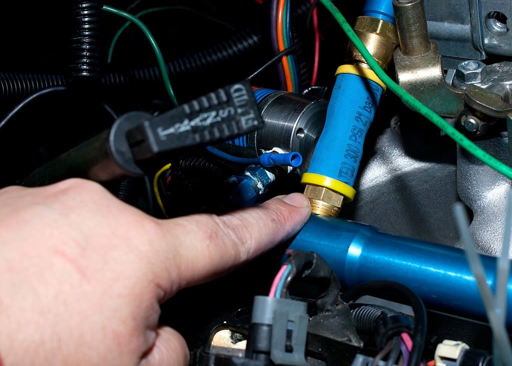

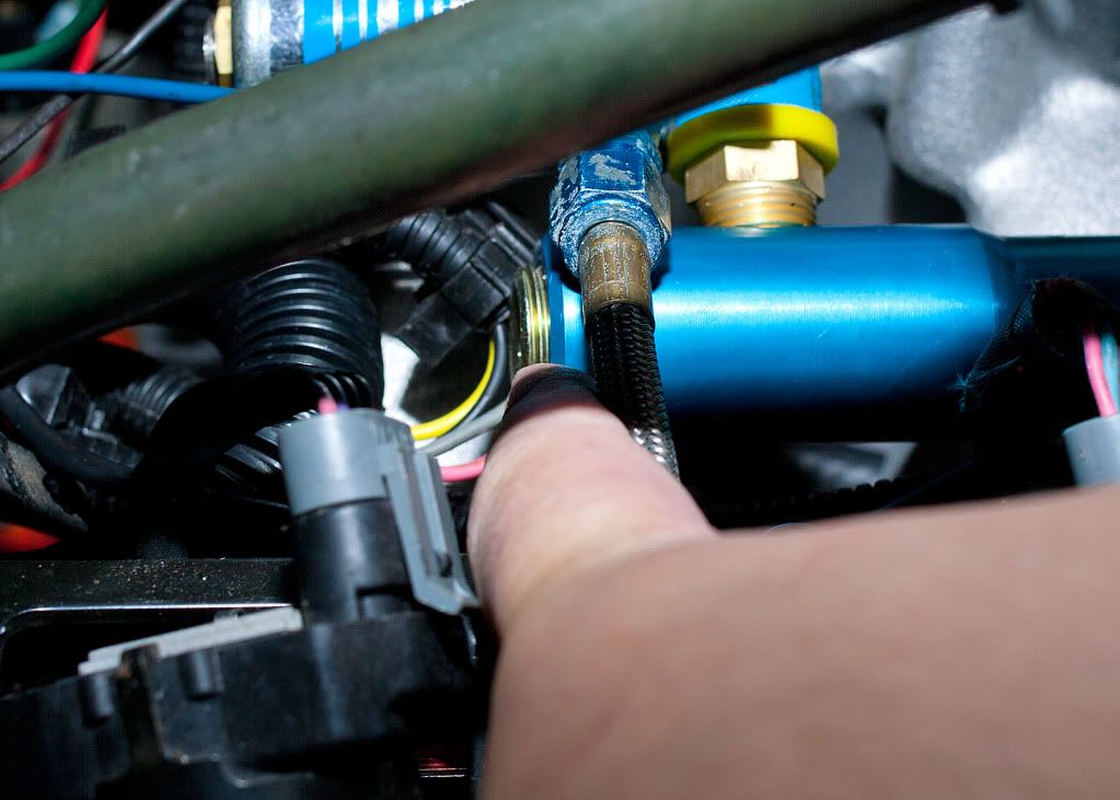

Installed the new fuel pump today. Wired it up and it works. Looks good too and fits better than the last pump. Odd thing is I found two extra holes under the old pump bracket that were exactly the correct spacing for the new pump. Don't even remember drilling those.
Bad news: I have fuel leaks, mostly on the crappy fuel log I'm having 2nd thoughts about.
Leaks here:
Here:
Here:
And Here:
Also this fitting leaks...
Also wired the fuel pressure guage and it won't work. Suspect the sending unit is dead.
