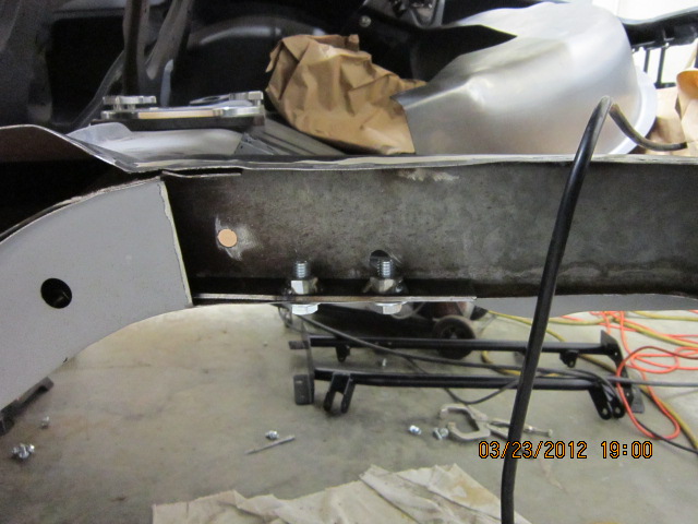

This is a picture of the bracket bolted in. I still have to add one more plate with 3 more nuts welded to it. The plate that I have not made yet has to be installed after the bracket is made and installed. You bolt it in and then weld the plate to the lower part of the bracket and then your done. I will drill a few holes randomly to plug weld the bracket to the frame once I have it finished and am ready to close the frame rail back up.

The bushings that came with my Airbar are heim joint on one end of the upper link, rubber on the other end and the lower link came with poly on one end and rubber on the other. I'll change that all up after I get the car on the road
Nice so your plate goes in before you close up the frame for the mini tubs? Very nice!

Yup! Nothing pertee, but it will serve it's purpose well. The close up picture of the frame rail from the inside shows where the hole I had to raise up from where Ridetech had the hole on the cradle. I had to move the hole up on the cradle as well. I am using 1" 7/16"x14 thread grade 5 bolts with matching nuts. I'll post it all up on my thread tomorrow evening if I manage to get it all done and back in. I'm going to make a template so I will be able to duplicate the bracket for the passenger side. I'll make one up for you too and scan it.
