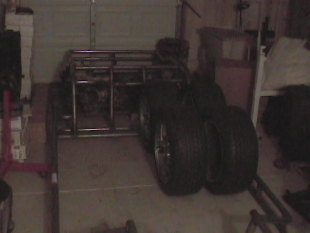

Thumbs up Collecting parts
This week my frame was delivered. Long story short; thankfully no one wanted it when I was trying to sell it and I was able work something out to keep it.
Additionally, I bought some corvette z06 rims 17x9.5 front and 18x10.5 rear to use as rollers and mock up the proper sizes for a set of custom billets. I also bought a 350ci 4 bolt main block. This will be stroked to 400ci after I use it to mock up the engine mounts.
Pictures should be available tomorrow.
Mal

Here are the pics as promised. My garage is a little small. You can see the block in the back.
Mal
