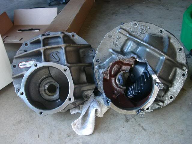

Well, first track outing with the T56 was interesting. I didn't know how much grip the track had so I tried a small burnout and staged. I softly let the clutch out at 2500 RPM, the tires dead hooked, it rolled out 10 feet and nearly shut the engine off. I managed to keep it running, threw it back into gear and ran out a 13.0 @ 118. After another short burnout to clean up the tires I staged again. This time I dumped the clutch at 4500 and the car didn't move. It made a hell of a racket out back and rolled a foot. Turns out the bearing support in my stock 9 inch case snapped off sending the pinion walking up the ring gear and ripped the housing apart. After disassembly, I found a broken case, chipped ring gear, bent splines on the axles (Currie 31 spline) , and all of the studs bent (Strange 1/2-20s). The housing, locker, and yoke were all fine.

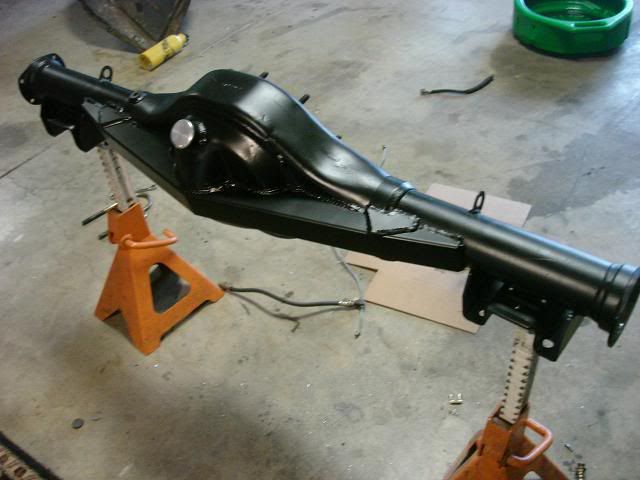

So...I ordered all new Moser 35 spline axles, new locker, Strange Pro-G case, new 4.33s, 5/8 studs, and billet pinion support. It might be overkill, but I also braced the hell out of the housing yesterday so it'll be ready for the next bullet I put in the engine bay. Lesson learned- stock 9 inch Ford third members don't like big launches on big drag radials. Pics:
Calm before the carnage
broken case
new vs old
braced rear ready for hell
Should be back on the road next week.

Yep you sure did some damage. That new housing should handle the extra power. Tha car looks great.
