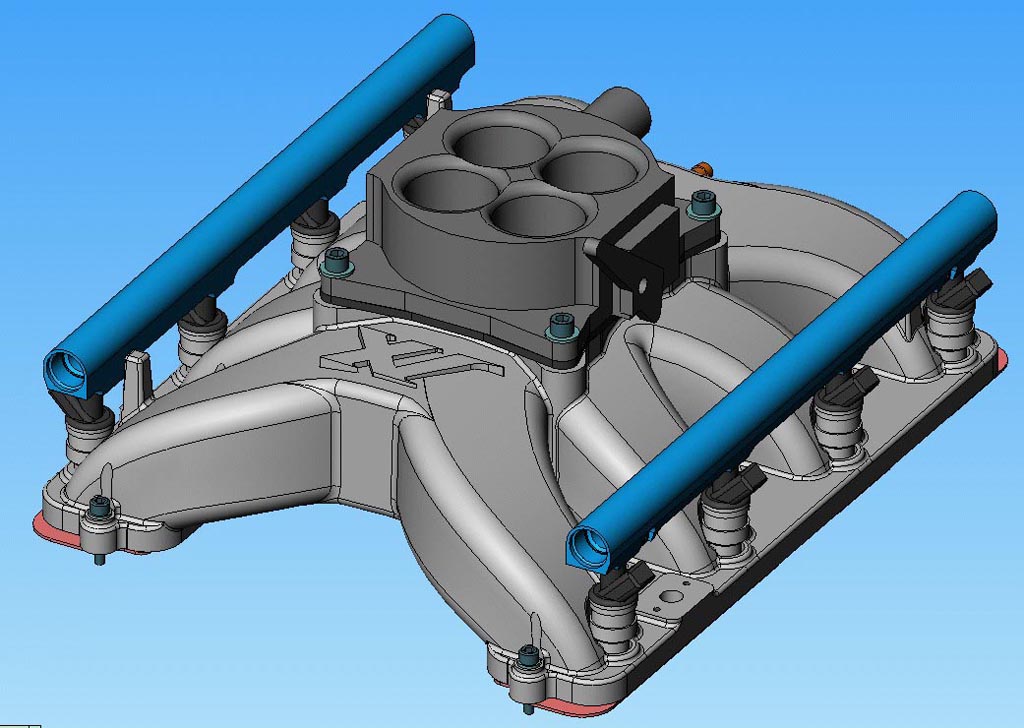

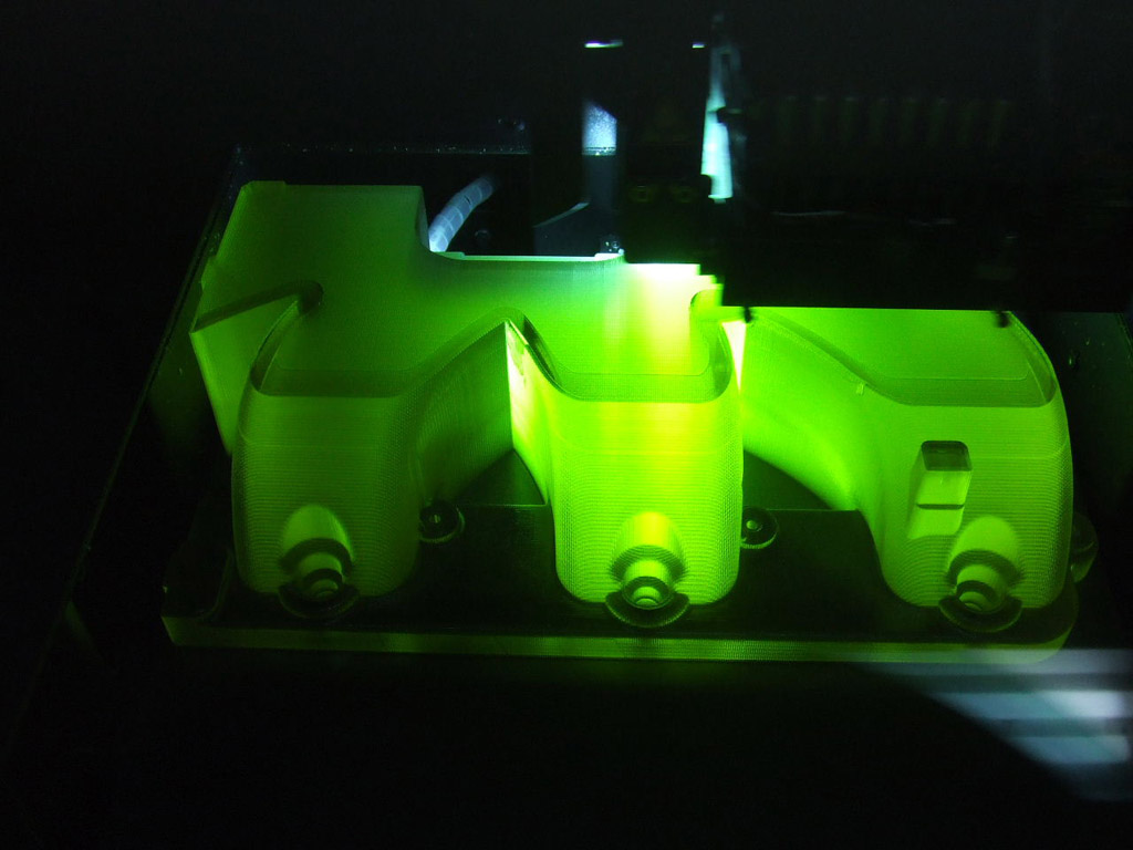

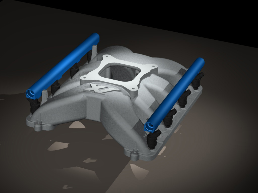

We already have a (normally aspirated) single plane four barrel EFI intake well underway for the 6.1 Hemi. Was designed in CAD and then a prototype made using Stereo Lithography. Stereo Lithography basically takes the CAD data and makes a prototype part building it out of resin layer by layer - almost like a three dimmensional printer. The prototype is already bolted on a 6.1 Hemi on an engine dyno waiting to be tested and run with different cam and header packages. See the pics below and you can see how the intake has come along.
The intake was done partly so we could run functional shaker hoods and scoops and we really didn't want to run the factory plastic tuned runner intake w/ a cone filter - we thought these cars would look much better with a more period correct four barrel air cleaner type setup and we really wanted to have the factory scoops and shakers be functional. Dream Car also filmed this including the intake being made on the Stereo Lithography machine.

I've seen that resin prototyping on TV before. Way cool stuff. I like that you want to keep a somewhat period correct look under the hoods of these cars. It's a nice blend of old school aesthetics/character and modern technology.
