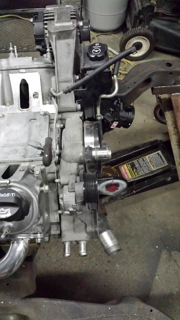

I'm running the stock corvette set-up as it is the most compact from the factory. It also was a complete pull out

C6? Is the alternator high on the drivers side?
yes from a c6. here is a pic:
[IMG][/IMG]
[IMG][/IMG]

Check out post 14 and 18....what set up is this and will it work on an LS3? I think they are F-body drives?
https://lateral-g.net/forums/show...t=19486&page=2
yes,those pics look like the f-body set-up
