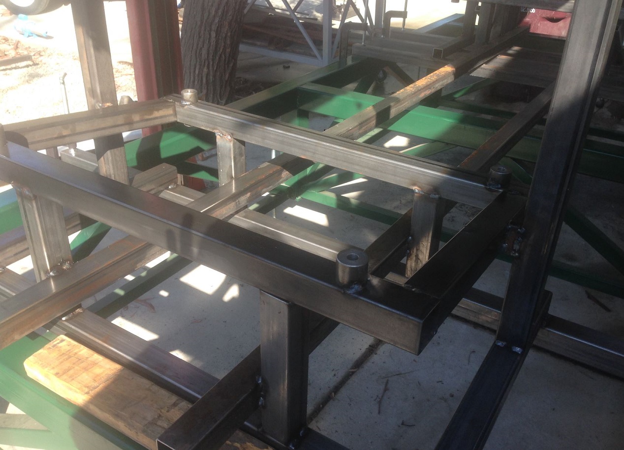

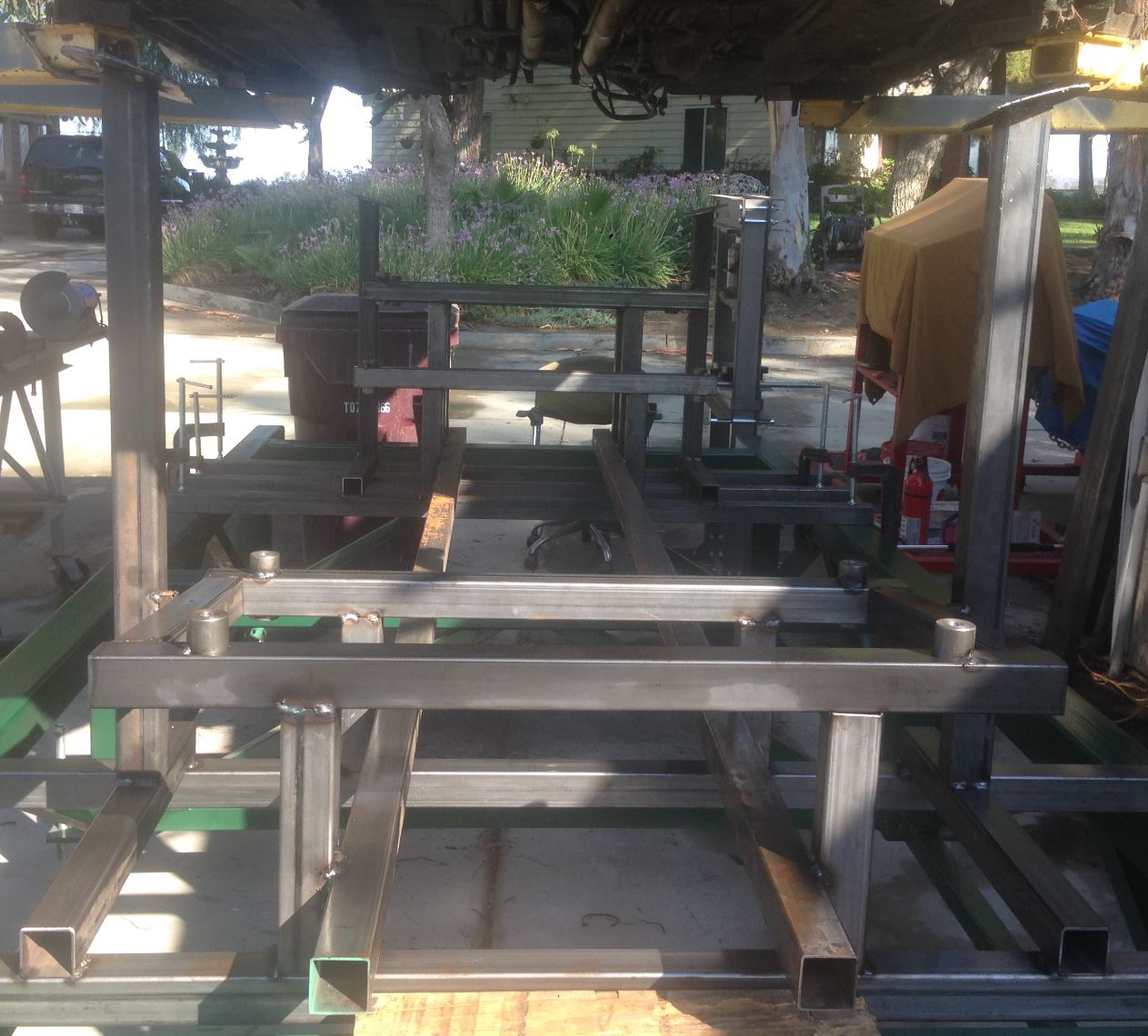

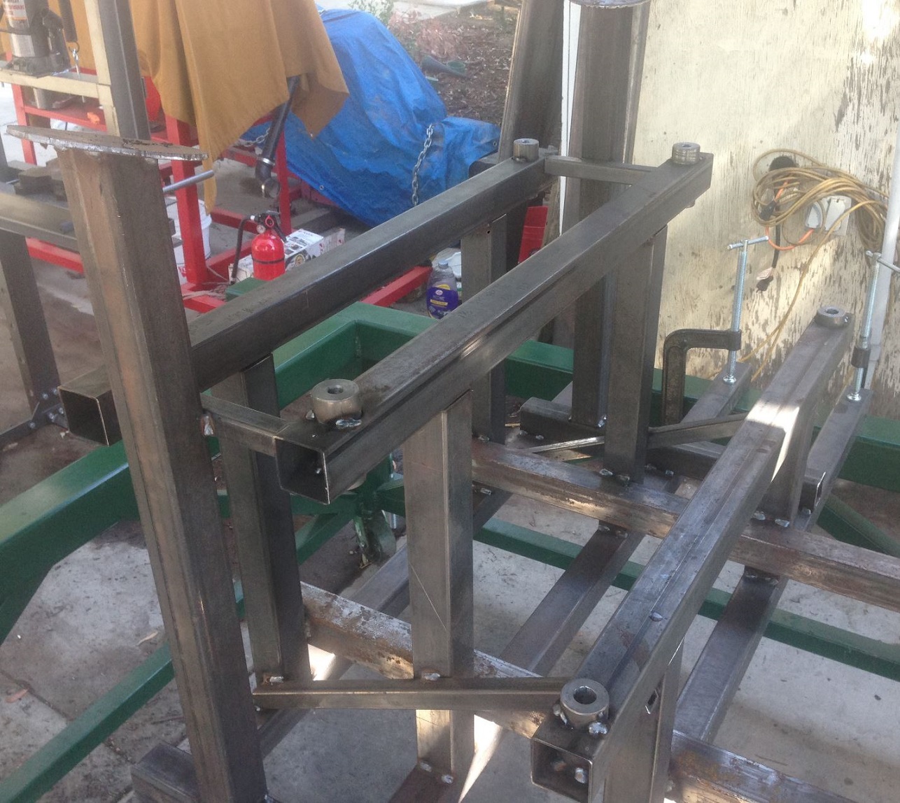

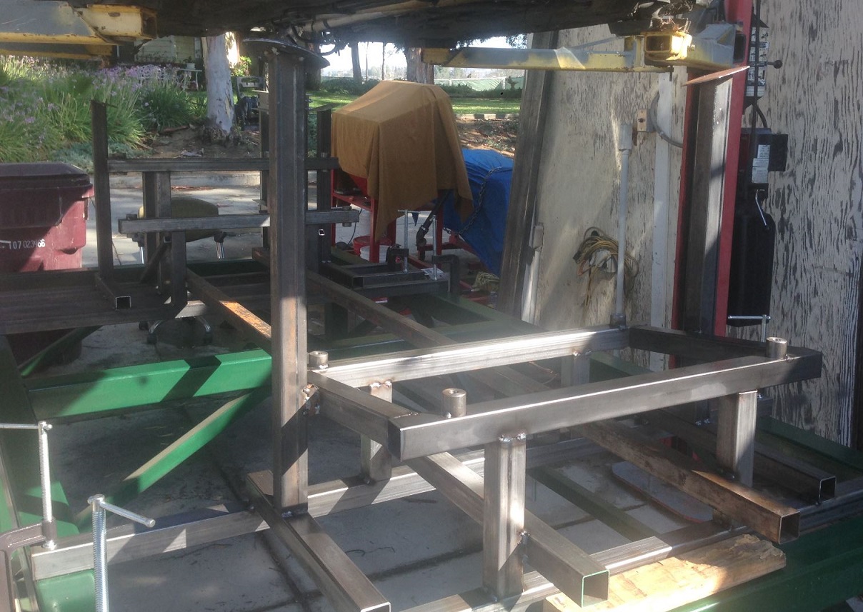

Here is the suspension nest completed. It is now ready for the 914 to be placed over it and to build the tube frame around it.

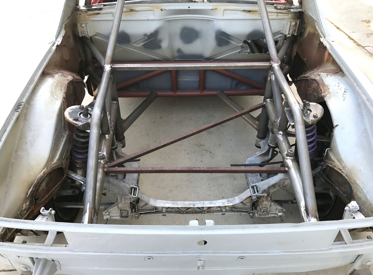

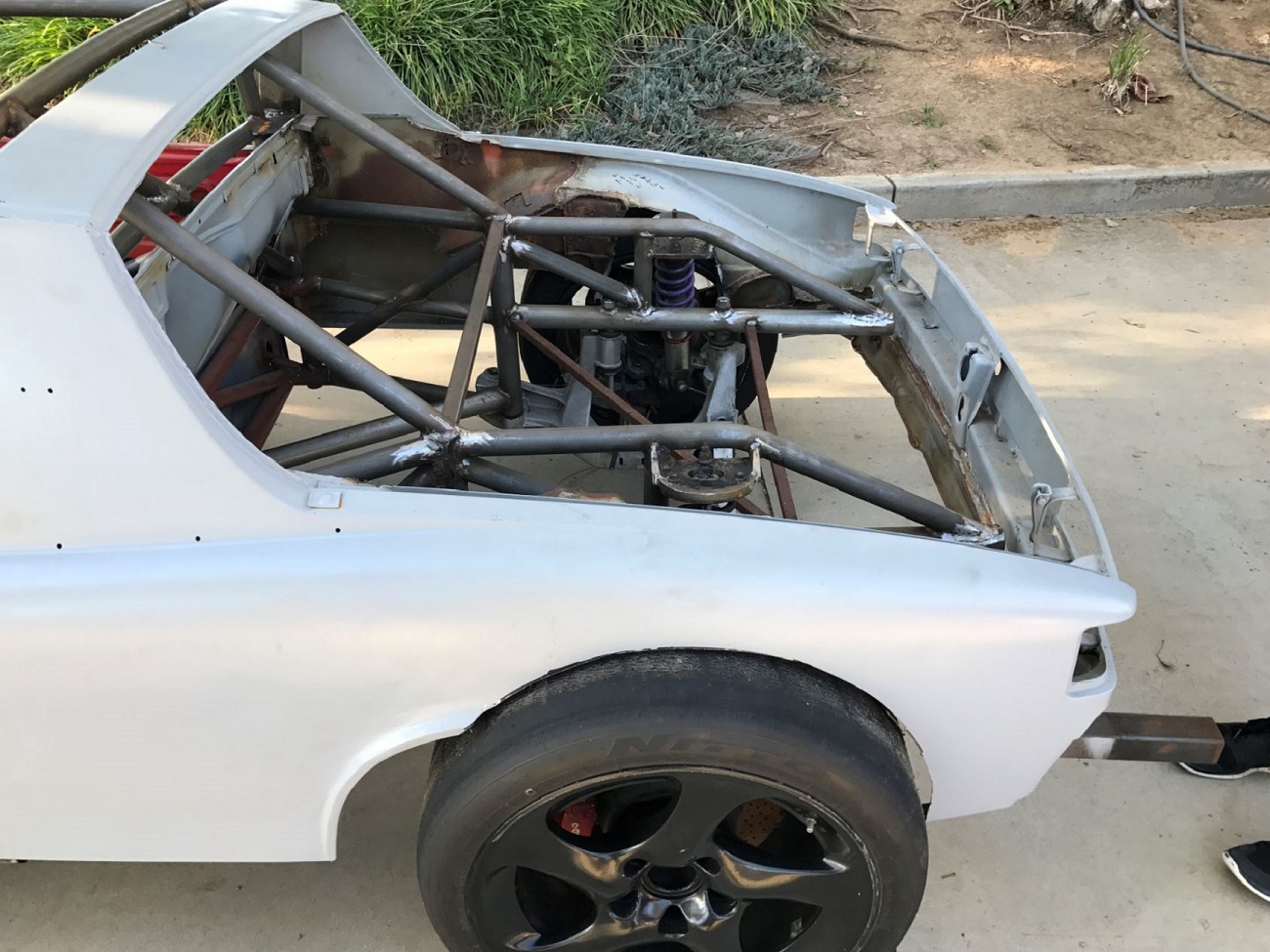

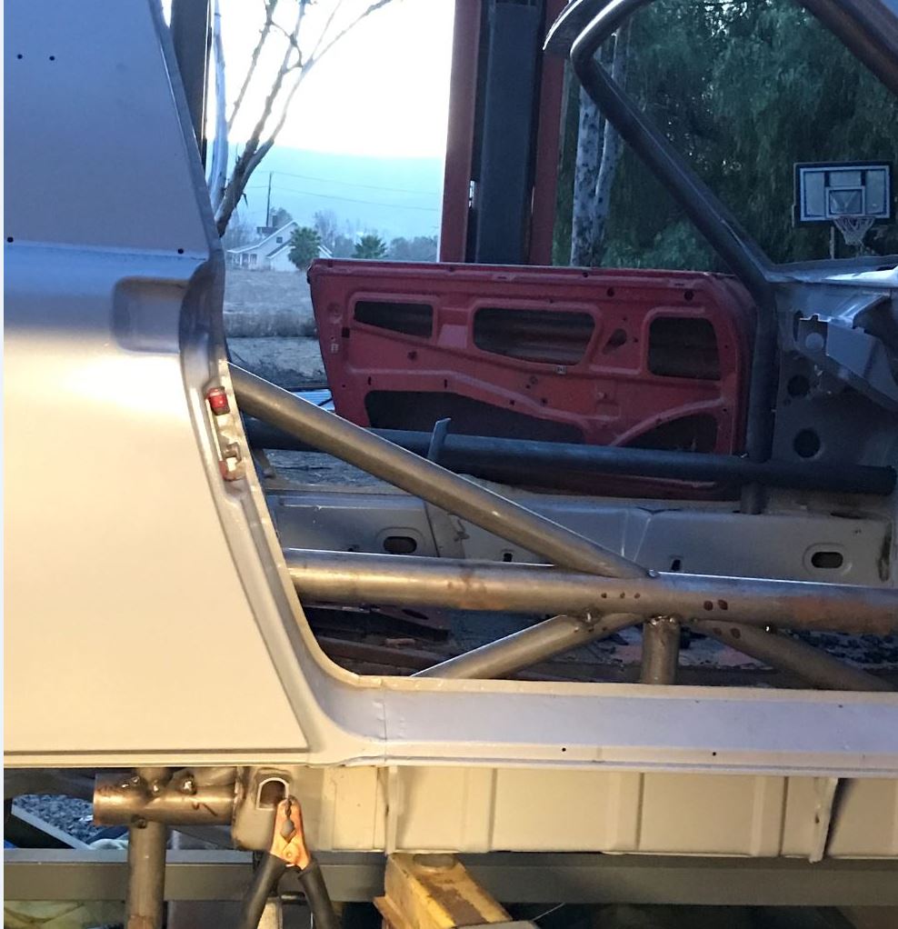

Little Update. Completed adding the truss strengthening.

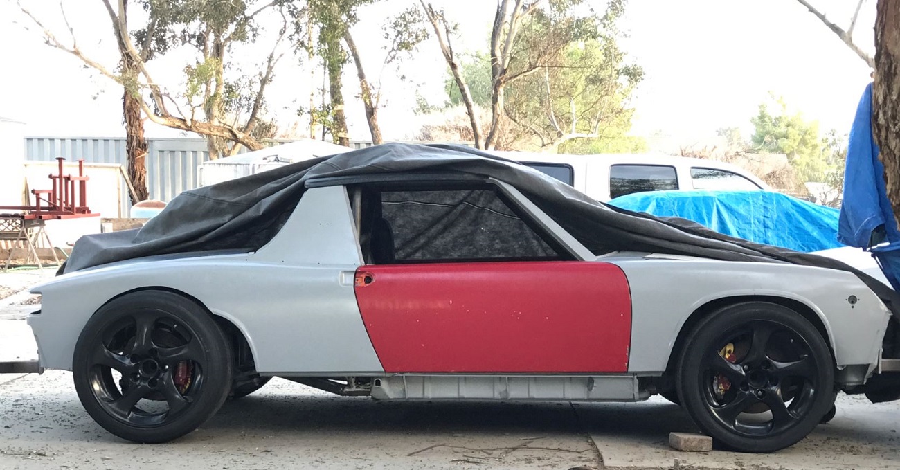

here is the roller

What are you going to use for Fender Flares?

Porsche 916 GT steel factory flares. Will widen as necessary to stuff the tires in there
