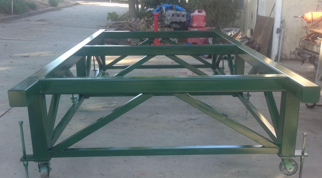

Well I'm new to this forum but it is here where I got the idea to do the 914 with a 996 suspension. I understand that a member called SPODE built one. Well I'm following in his foot steps and hope to get useful info as I move along. I'll post pictures of the build when I get to the office.
Old 08-19-2016, 09:30 AM
Curbandgutter Curbandgutter is offline
Join Date: Aug 2016
Posts: 10
Here are pictures.

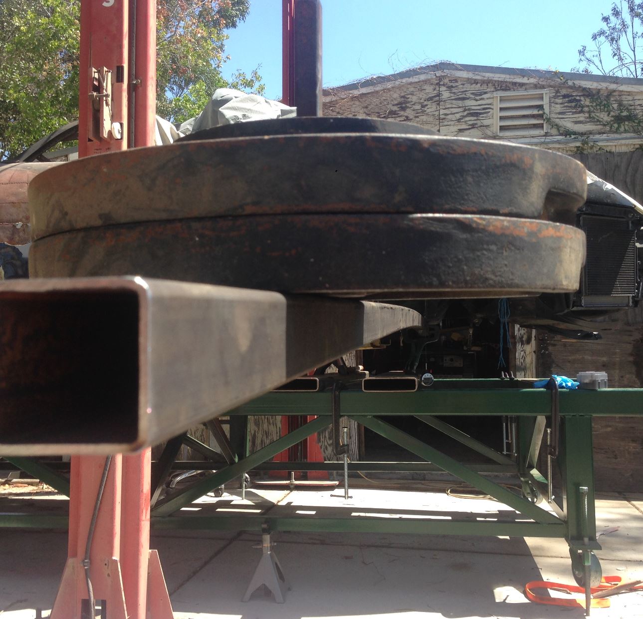

Here are some pictures of how I twisted the donor frame to see measure it's torsional stiffness. The final numbers show that the Porsche 996 Cabriolet has a stiffness of 4568'# per Degree.

That's a cool test--it's astounding how sadly flexy our old cars were in their stock states, and how basic subframe connectors do practically nothing to change that state. At the same time, it's really amazing how torsionally stiff modern cars are; it's also interesting to see how the torsional stiffness really helps with ride quality when hi-po suspension setups are applied.
It looks like someone needs to start a proper build thread--welcome to the site!
