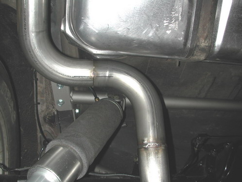

I'd like to see some installed pics if any of you guys had a chance. How is the rear located? I know it replaces the leafs with LCA's and either coilovers or airbags but is there a panhard bar or a 3rd link somehwere?

Darren, thanks for the link. Any idea of exhaust clearance or routing with this system?

Here are a couple pics of how we routed the exhaust on our 67. Stainless Works is working on producing these tail pipes.

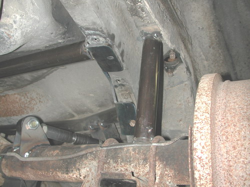

On the amount of drop at rideheight I have posted a pic of a spacer that we tack weld between the axle and floor pan, just to the outside of the rail. This spacer is obviously just temporary to set ride height, pinion angle and axle center while welding in the upper tabs. At ride height this spacer is 8.5" tall. But the lower mount is also adjustable, depending on weather your pad is for monoleaf or multileaf.

I will probably install a regular, universal, "mono" pad. I saw that your lower mount is adjustable (3 right?) and just hope it will drop enough, it should as i don't want it on the ground, but want to ride it so the rim (20 x 13") is about 1/2 to 1" in the fender, tire is about 26.5 high (345-25-20).

Do you really think i should only bolt it in or if a few passes here and there are a good idea while i have the welder in my hands....? My thinking is that bolts tend to move some under load, welds wont, so to add rigidity (remember its a 'vert) i'm thinking of welding it in.

I would probably go ahead and lay a couple beads, but it is not necessary. We have 275/40/17's on our Red Camaro and the rear fender is about 2" above the rubber at ride height. Here are some good photo's.
