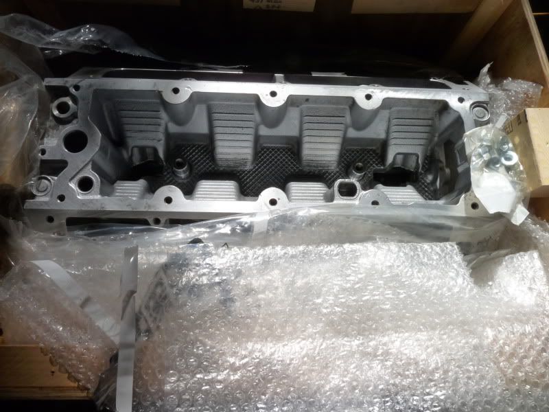

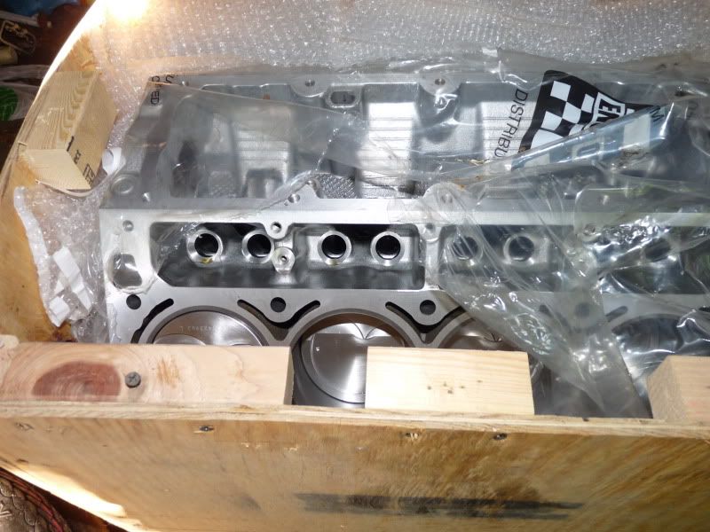

Not that I needed it, but I just picked this up for the '69. Looking to up the TQ more so than power.
It's a Brand New HKE built fully forged 383 shortblock. Going to swap everything over from my stock LS1 onto this motor.
Will most likely do this over next winter as the summers here are very short and the weather JUST got nice.
Specs:
Brand New LS1 Alum Block.
11.7:1 cr with 62cc Heads
LS6 383 Callies C-Series LS1 4.000 Crankshaft 24 tooth
Scat 4340 LS1 I-Beam 6.125 (.015 offset) Part # 2-ICR6125-7/16
Wiseco K464F3903 LS1 3cc Pistons 3.905 Bore 391g each
1/16,1/16,3.0 mm Rings 1.115 Comp. Height
Wiseco GFX Piston Rings
ACL 5M7298H Main Bearings for LSX - Race Bearings
ACL CB 663 H Rod Bearings for 2.100 SBC Chamfered Race Bearings Coated
234-5608 ARP Main Studs for LS1
Pics:
1969 CAMARO RS
Lateral-G Feature Page
Project pics of my '69
