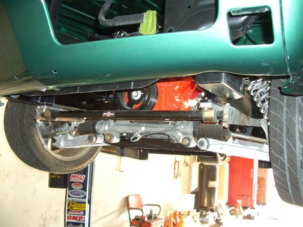

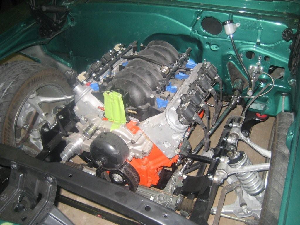

Hey Guys, Sorry to steer this whole thing back to the Wayne Due subframe but I'm having a problem I wonder if any of you have heard about or experienced with your Wayne Due Sub setup for the C5 suspension. the problem I'm having is that the sway bar ends are coming into contact with the Coils on the shocks (they are QA1 Coilovers) I have attached a picture to help with a visual. The Sway Bar, Shocks and frame came from Wayne as a unit not long before he closed up shop.

you can get lots of different size arms as well as cuting them and re drilling them and or re bending them to work how you need them to, just make sure each side is the same
Can you take some better pics, maybe with the wheels off looking in over the hub?

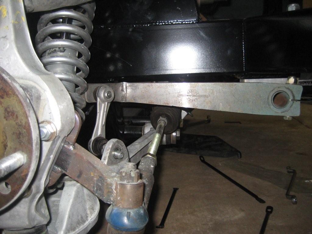

I will post some pics hopefully tomorrow as you suggested. For now, I found one I already had that might give you a better view. I'd rather not cut the pieces since I'm sure they are hardened and I might be creating more of a problem then relocating the sway bar mounts forward. I also tried flipping the sway bar over but the problem is still there.

they sway bar arms are not hardened, i can bet a buck they were probably bent by wayne in the first place, , re bend and trim.

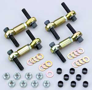

I have the same setup...You can run the "heavy duty adjustable end links" for C5 vettes which can adjust a little shorter than the stock (fixed length) C5 links (which is what you have).
They are available from several vette parts sources, here is one:
http://www.exoticperformanceplus.com....html?item=868

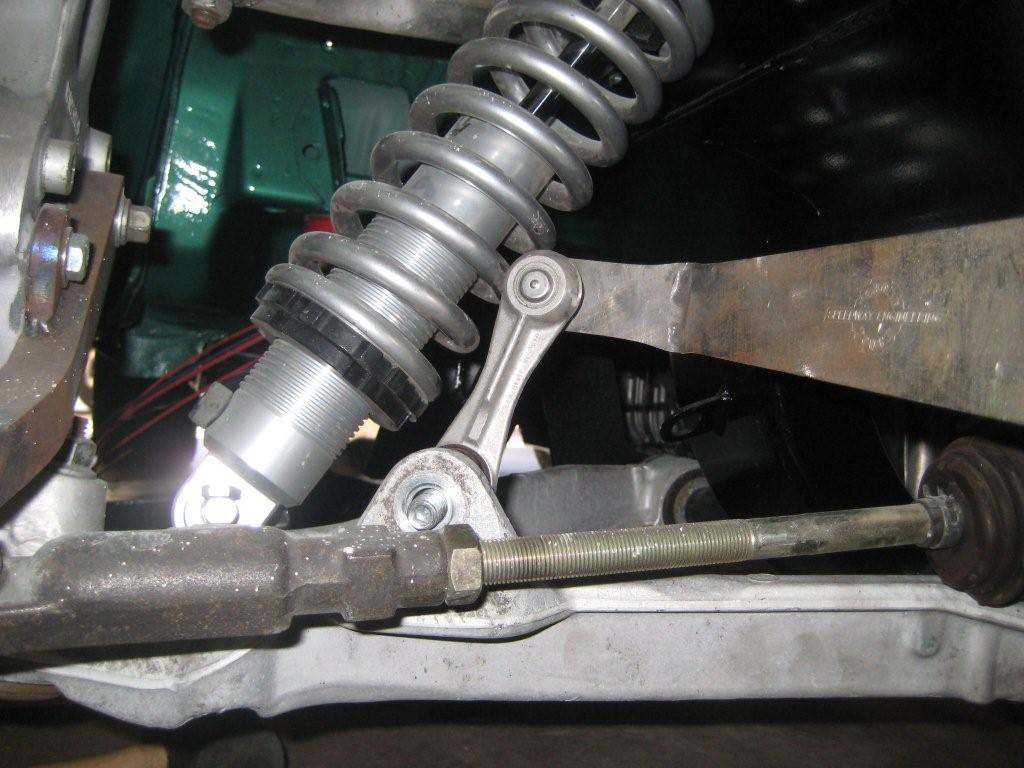

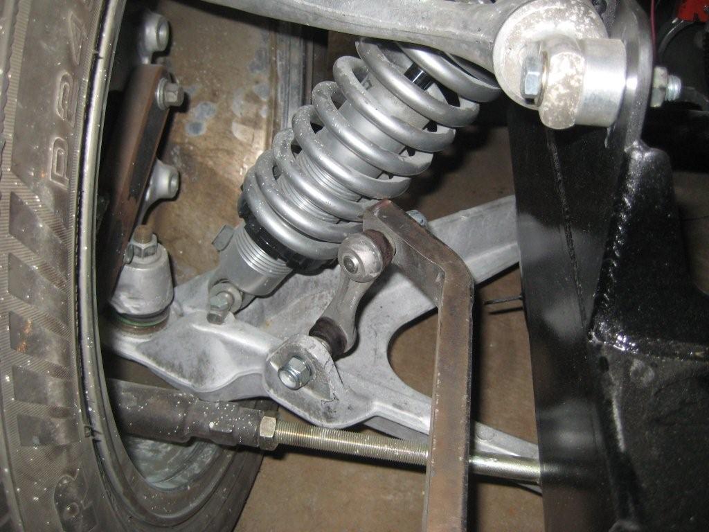

I took some pics today with the wheel off as you suggested. Without any weight resting on the front end, the sway bar is less then 1/16th of of an inch off the spring. With the wheel on and the car on the ground, it definatly hits the spring. The sway bar brackets came welded in place by Wayne's shop so I'm confused as to why I haven't heard of more of these problems on other WD equiped cars. Thanks!
