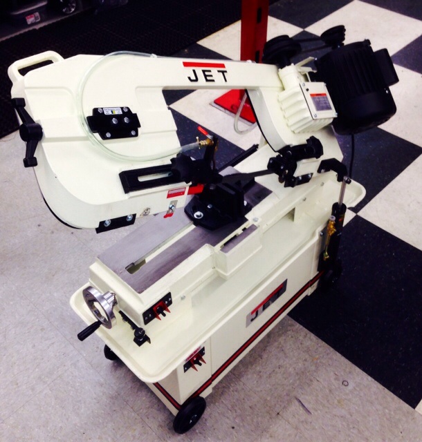

Is it a wet saw??

Yes it's a wet saw.

Wow very nice! I "need" one of those .
Congrats on the unload. That looked like fun.
Thanks.......I have further appreciation for what the Egyptians accomplished.

Very nice, Scott. I unloaded my JET 7x12 yesterday (as you saw on FB). Mine is more basic (belt not direct gear drive) and is not a swivel type. I am really looking forward to putting it to use. Did a few test cuts and Indeed the coolant makes cutting so much nicer. I ordered up some good bimetal blades and coolant concentrate also.
And oh yes, these things are heavy.
Rob that saw is all you need unless you're doing a lot of miters which is the reason I went to the swivel head. Mine cuts like a house of fire compared to my small dry saw. I installed the 8-12 blade tonight and will probably order a 10-14 and straight 14 as my go-to blades. Be careful when changing blades and setting the tracking, the tensioning/tracking system is goofy and sensitive. At least thats my initial impression. Tightening the tensioning bolts has a major impact on tracking. I learned the hard way and cut through a section the backside blade guard near the top wheel. Only took a couple seconds with the stock 6-10 blade.
So I put the saw in neutral and manually spun the wheel to set tracking.
FWIW - I'm also going to pick up some rem pieces of solid round stock to have on hand for conditioning new blades.

Thanks for the tips, Scott, I'll watch out for that. Conditioning the new blades is a good idea, I have a few chunks of 3" solid round plain steel I can make some "baloney slices" from. One of the reasons I bought the saw is also for being able to cut down round stock to put it in the lathe. There is a really great metal scrap yard down in San Jose that I get to visit once in a while, It is loaded with cut (much of it new) remnant materials and now, having this saw around opens up a lot more possibilities.

Are these saws able to stand vertically and use as a sort of table band saw? I can see how the saw can stand vertical but I have no idea where a table would come from. I want this function to make brackets so Im looking for more fuction without having multiple tools. If possible can someone take a picture please.
