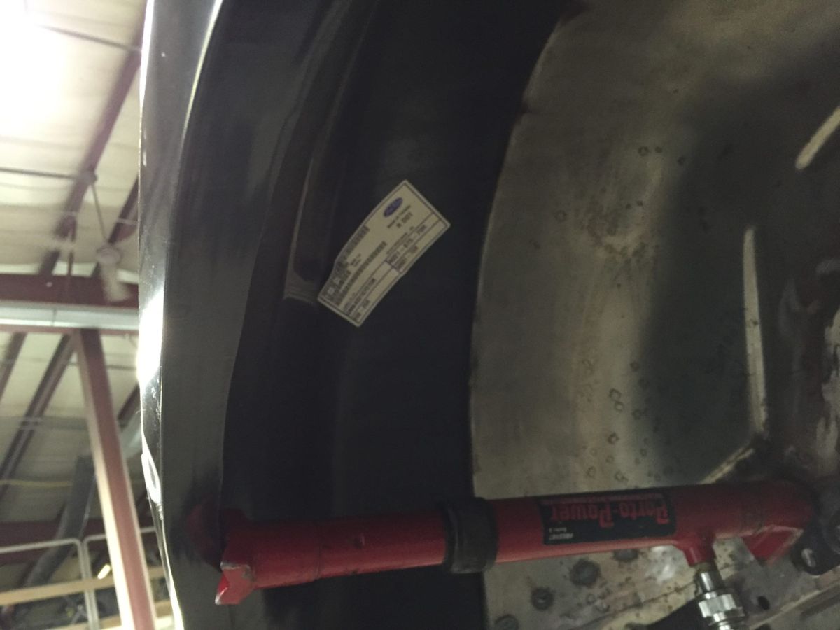

I got a little more time today, so I started the wide body on the passenger side, since it got welded in last week.
Obviously, I have a lot of grinding to do.
