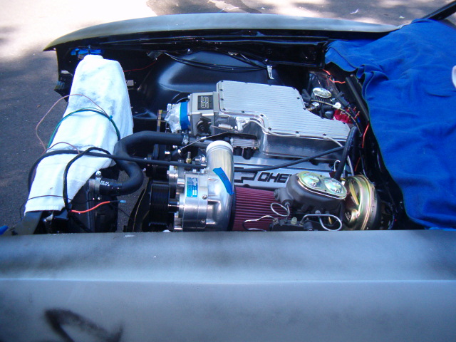

Two updated pictures of the progress of the motor. I guess I should end this thread now. Has nothing todo with the subject anymore.
