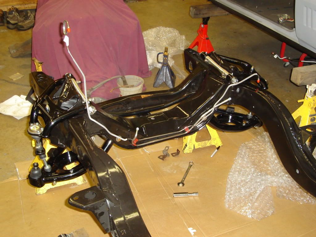

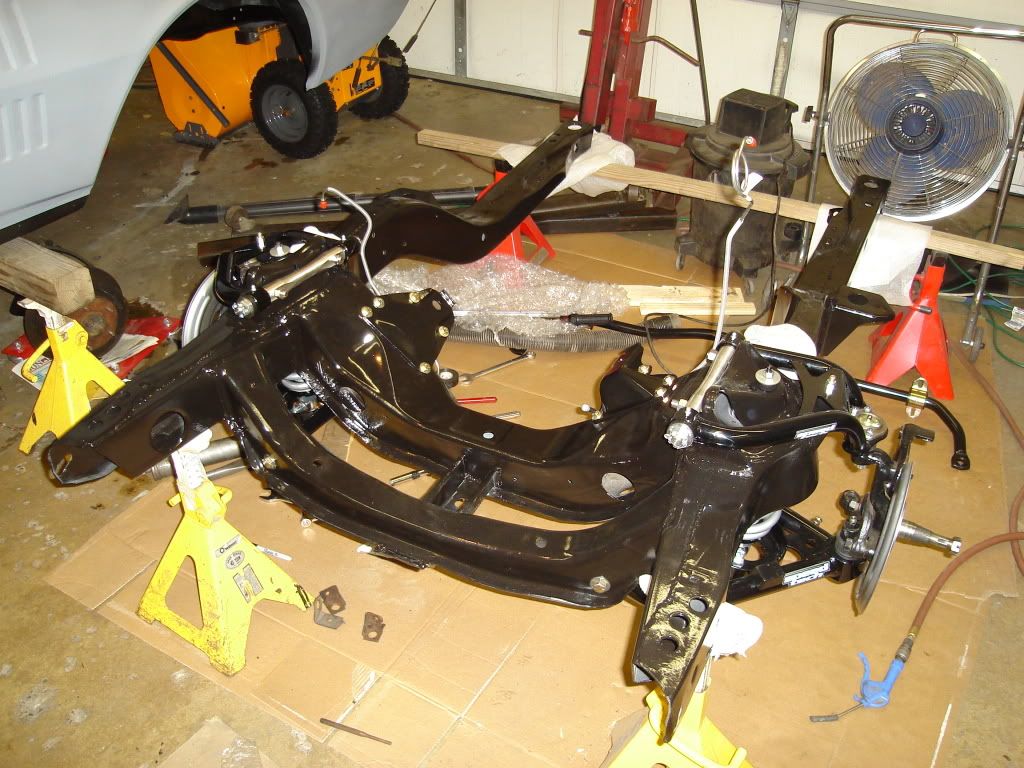

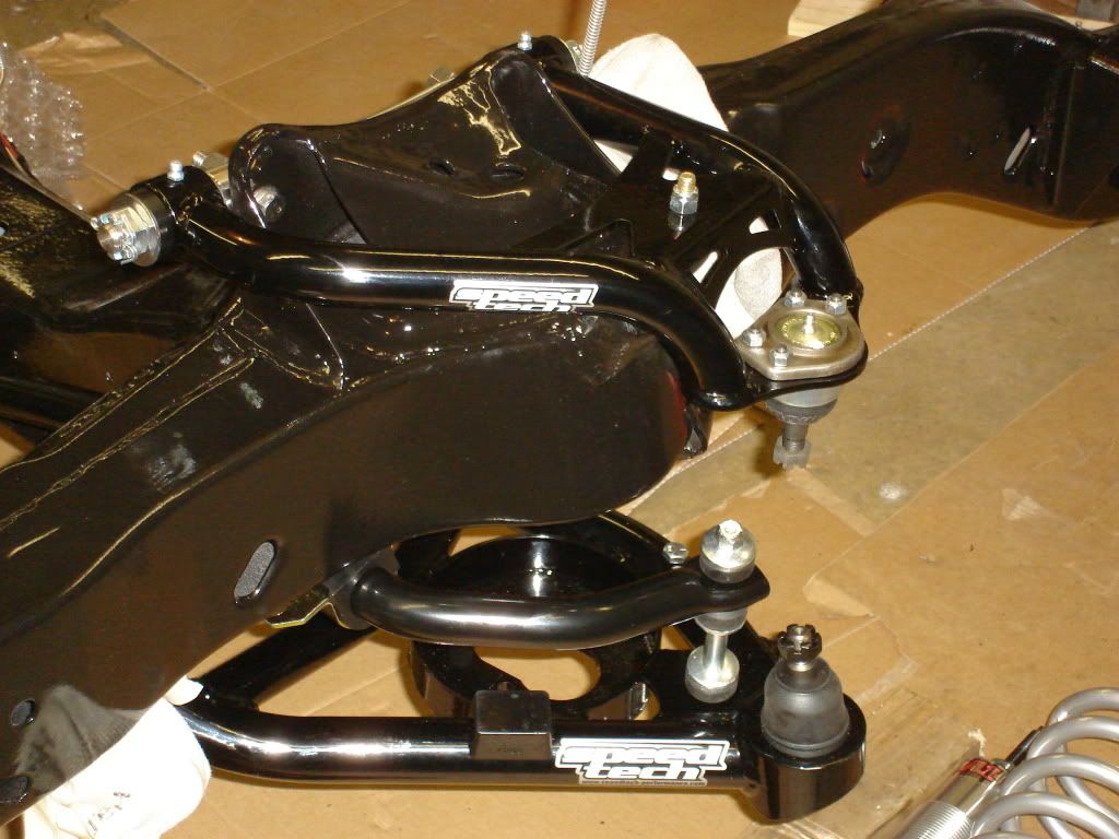

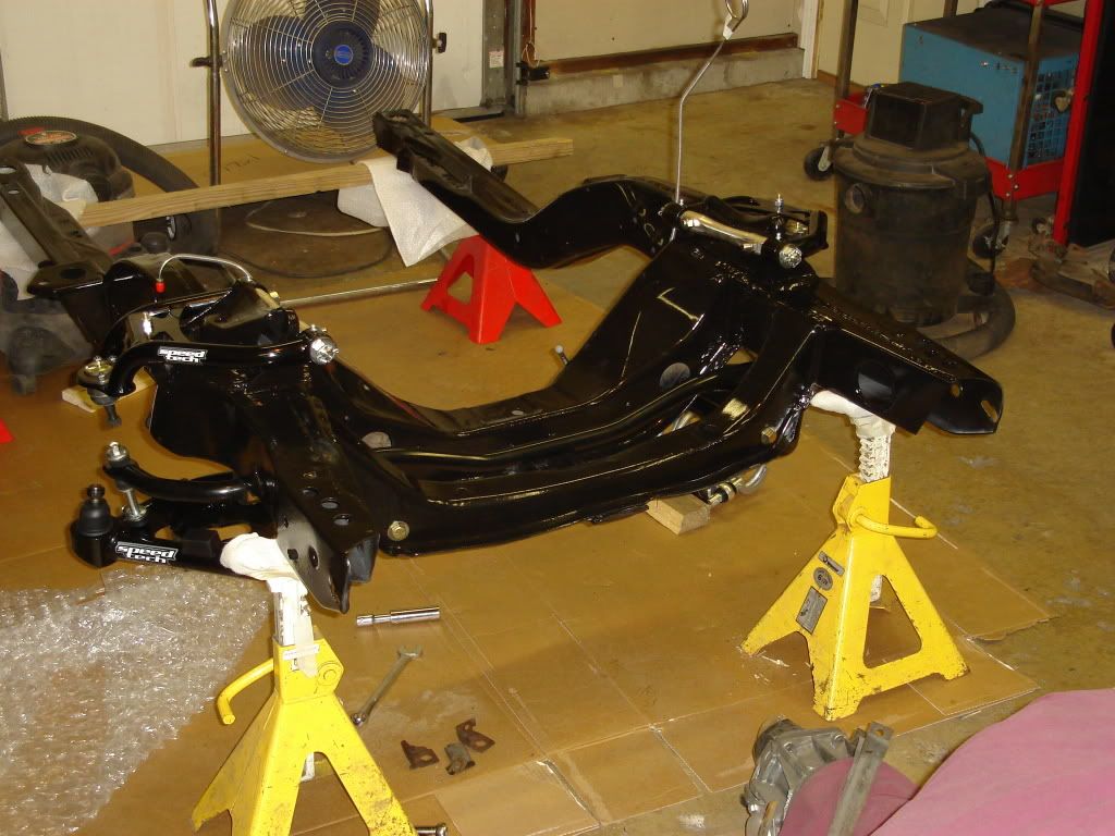

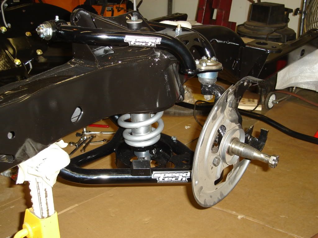

Spent most of last weekend running around getting things lined up for more work on the car. I finally removed the car from the rottisserie and put it on jack stands. Returned the rottisserie (4 hour round trip) worth every mile of the trip.
Picked up my subframe from a friends house.
Started installing the control arms and sway bar.
I have more to do on the lower mounting plate for the sway bar. The bar and bracket are much bigger than the stock one so I have to drill out new holes and make a threaded plate for the inside of the frame.
The brake and fuel line have to go in before the engine is bolted in. They run in between the engine brackets. I still need to bolt those on.
I tacked the lower perches in place on the 12 bolt rearend. If the pinion angle works out correct, I will weld it in place and clean it up for paint.

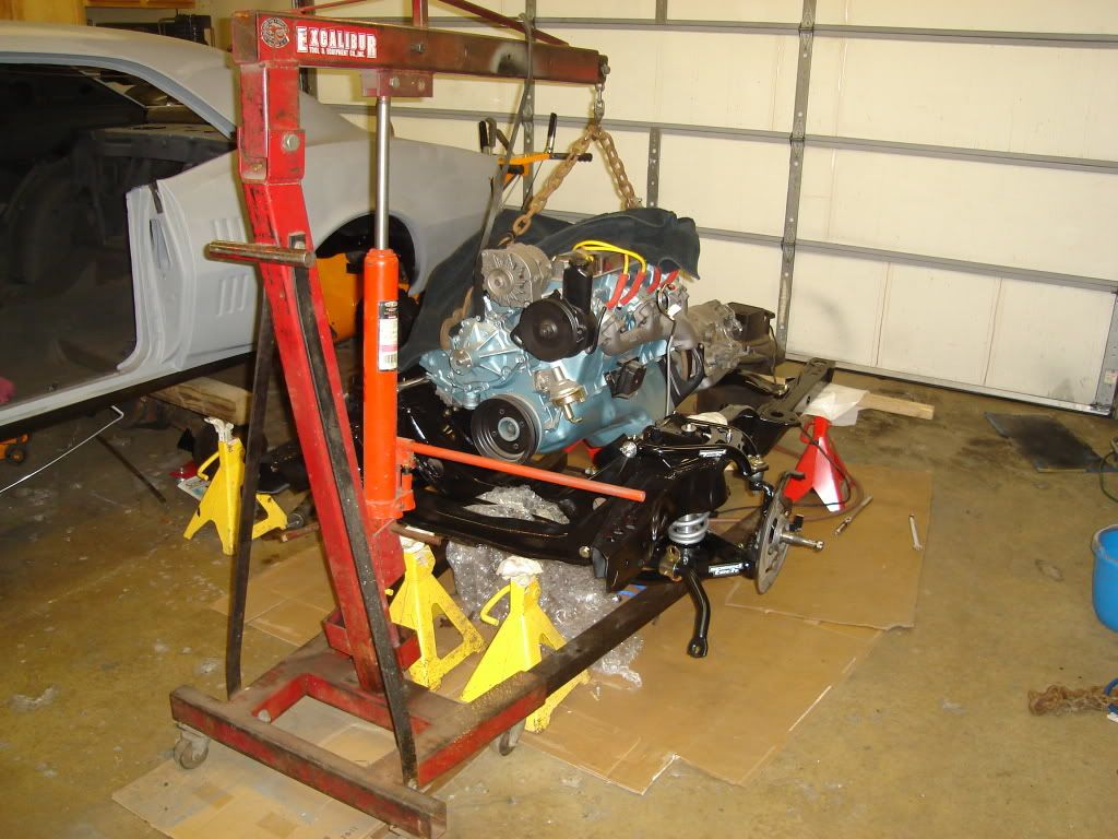

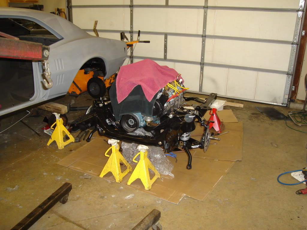

Got some work done. Sandblasted the motor mount brackets and tranny crossmember. Bolted onto the car with new hardware.
Installed the QA1's and spindles everything is a little dirty from sitting in storage for so long.
Tackled the motor and tranny by myself. Just had to be a little more careful.
All bolted in and ready to go into the car.

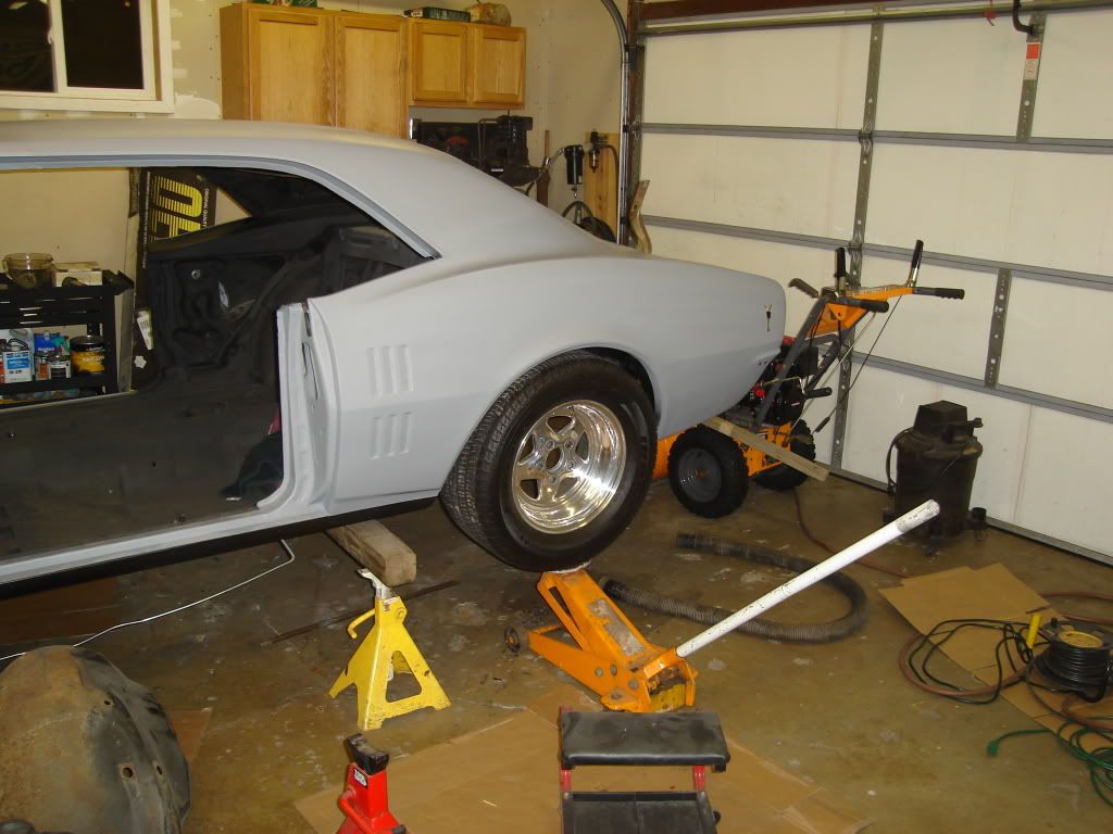

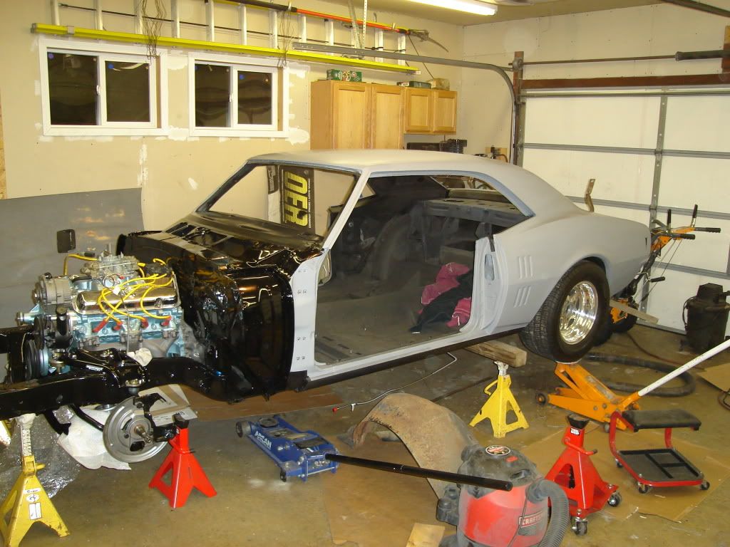

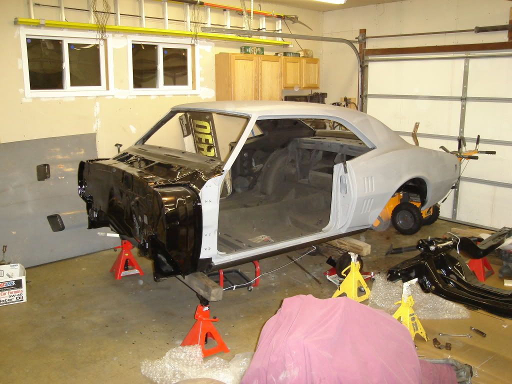

Had a chance to get a little more done. I used four jack stands,4 car dollies, and two jacks and wrestled this in by myself.
For a little motivation I grabbed one of my old wheels to see how it would look.

Man
you had fun wrestling all that yourself...AND IT LOOKS GREAT
THE YELLOW PLUG WIRES ARE WAY TO BRIGHT IN CONTRAST TO YOUR ENGINE WHICH LOOKS GREAT ..
IM just trying to help....KEEP THE PICS COMING !!

I'm not a fan of the yellow wires either. But, it was part of a package deal. I bought a set of heads,cam,lifters,and the wires from a member on this board. I figured since they were 8.8's I would keep them for a while. When I get some extra money I will get a set of black Taylor wires.
