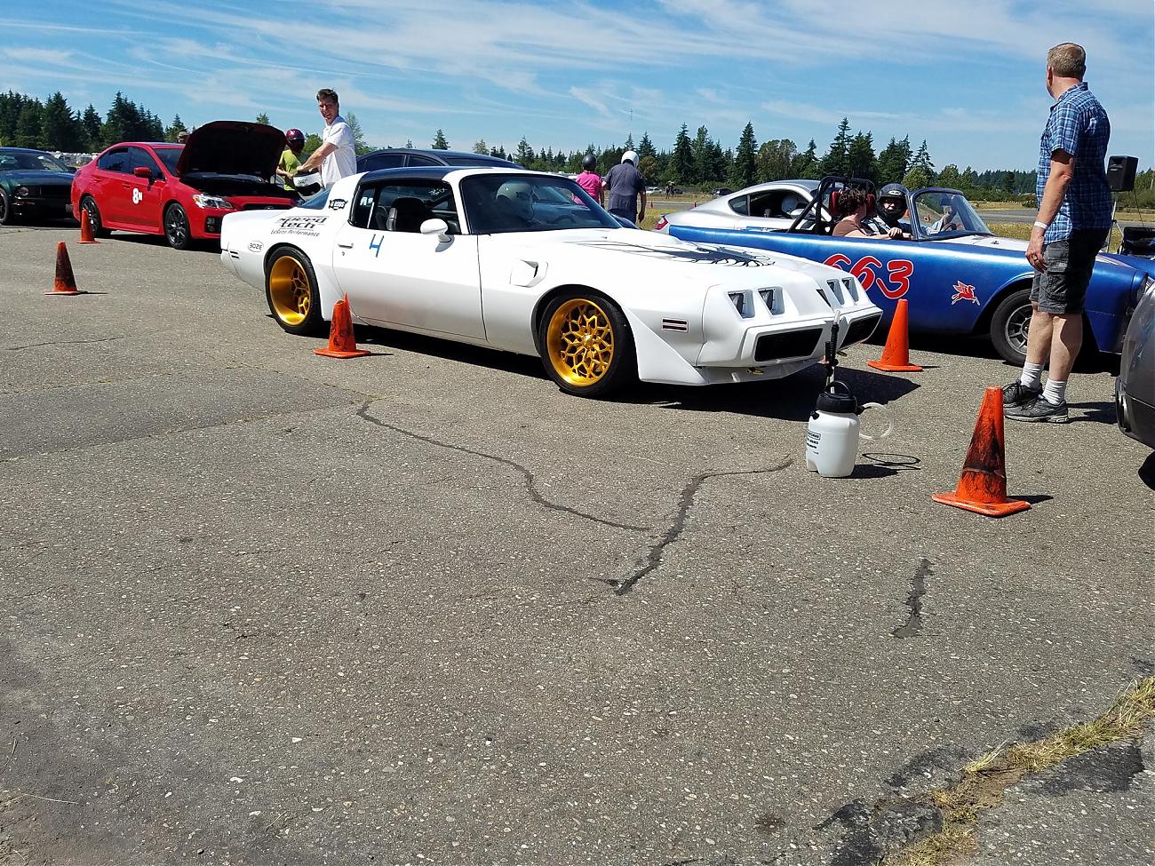

  #39
Old 06-28-2017, 09:01 PM
DBasher's Avatar
DBasher DBasher is offline
Join Date: Oct 2011
Location: Renton, Wa
Posts: 1,914
Thanks: 264
Thanked 285 Times in 81 Posts
Speedtech being represented in the NW! I never saw the front end but was able to peak under the back and see that beautiful TA, great looking car with the potential to be dang quick.
